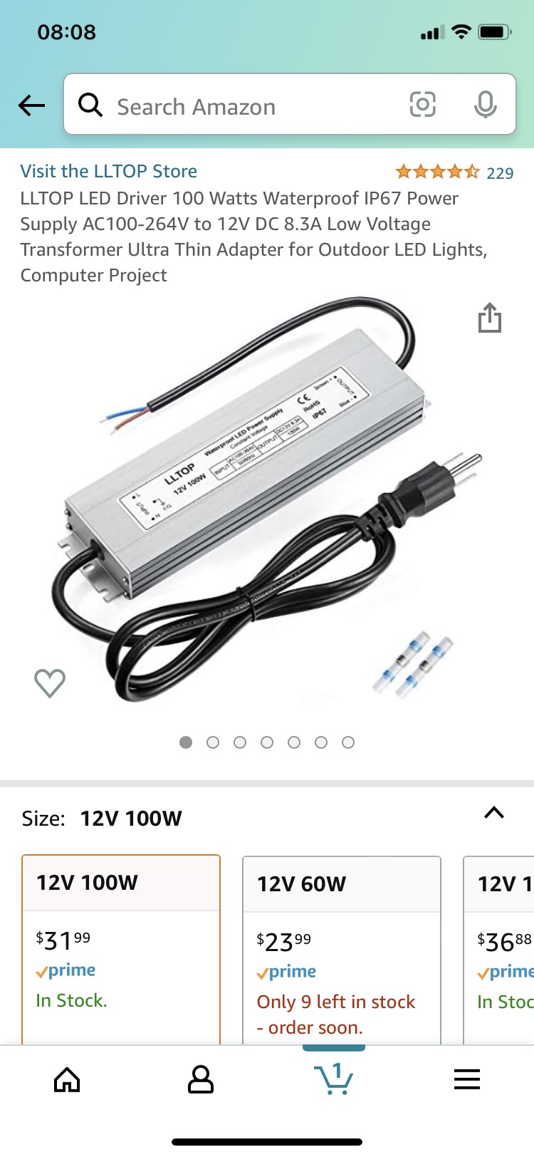

Like many other weekend sailors my boat tends to sit a few weeks between sails. I might average a sail about ever two to three weeks. Is it better to turn refrigerator off or leave on? Last year I turned the refrigerator off between sails to save wear and tear on the compressor. To cycle it on and off like this seems to cause a little more ice build up on refrigerant lines outside the box and also makes the box a bit smelly. Better to leave on and turn down the thermostat a bit when leaving?
1. What do most people do with their refrigerators On or Off when not using the boat for 2-3 weeks?
2. My boat is from 2002. The 12V refrigerator is powered off the battery which requires me to leave one of the battery switches on in order to run the refrigerator. This could cause my batteries to run down if somebody accidentally disconnects the shore power cord causing battery damage. Are newer boats refrigerators powered differently than this? For example do they have a separate power supply for the refrigerator? I’m thinking of getting a small power supply like the one in the picture and switch to this when at the dock instead of the battery.

You are going to get different answers on this one as it depends on whether you pay for power at your marina (and power cost per kwh). I clean out the refrigerator and turn it off to avoid consuming power. if you already connected to shore power through a galvanic isolator or isolation transformer to charge your batteries and want to keep your refrigerator on then do that through the batteries vs. adding a separate shore electrial line to boat, which will bypass your boat's electrical protection system. If you keep the refrigerator on while you are gone, consider what would happen to the stuff in your refrigerator if you lost shore power for any number of reasons.
