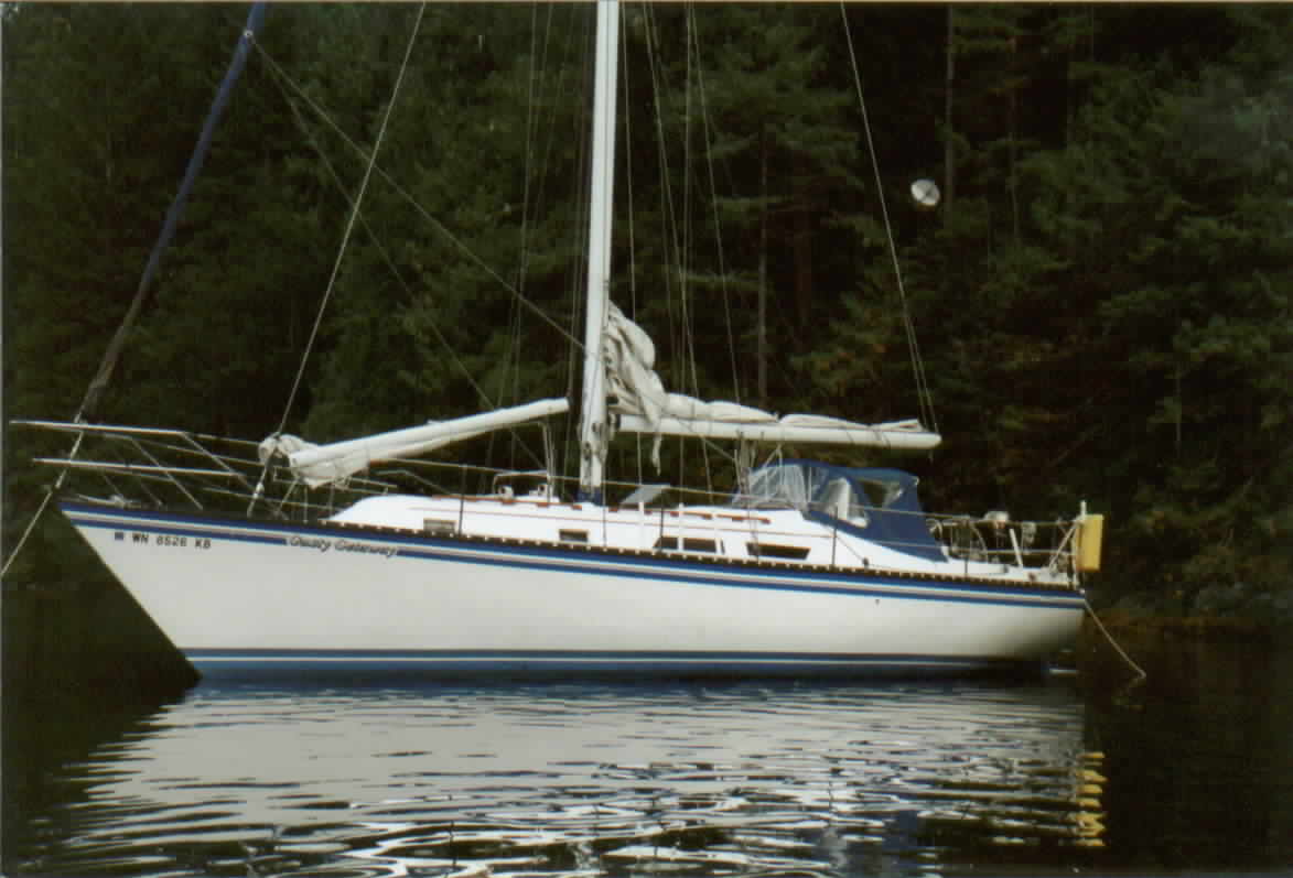

Port Light Confusion
As I'm sure Brian will tell you, there is some confusion about the Port Lights in the 37 Cutters. I'm not sure what year they started, but my 1984 37C has the same Port Lights as Brian's. See attached photo. Note that they are not rectangular with rounded corners and do not open. Also note the one angled end on each of the two Port Lights. Scott is right about commercially available cleaners doing a good job, but can't help you, Brian, with the leaks.
