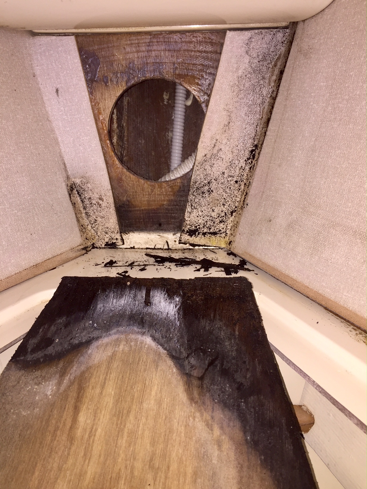

I just recently bought a 1996 Hunter 29.5 and there seems to be a lot of rainwater coming in the V birth. Not sure if it's from the Forestay Link Plate of the seal on the rub rail, anybody have any experience with this?

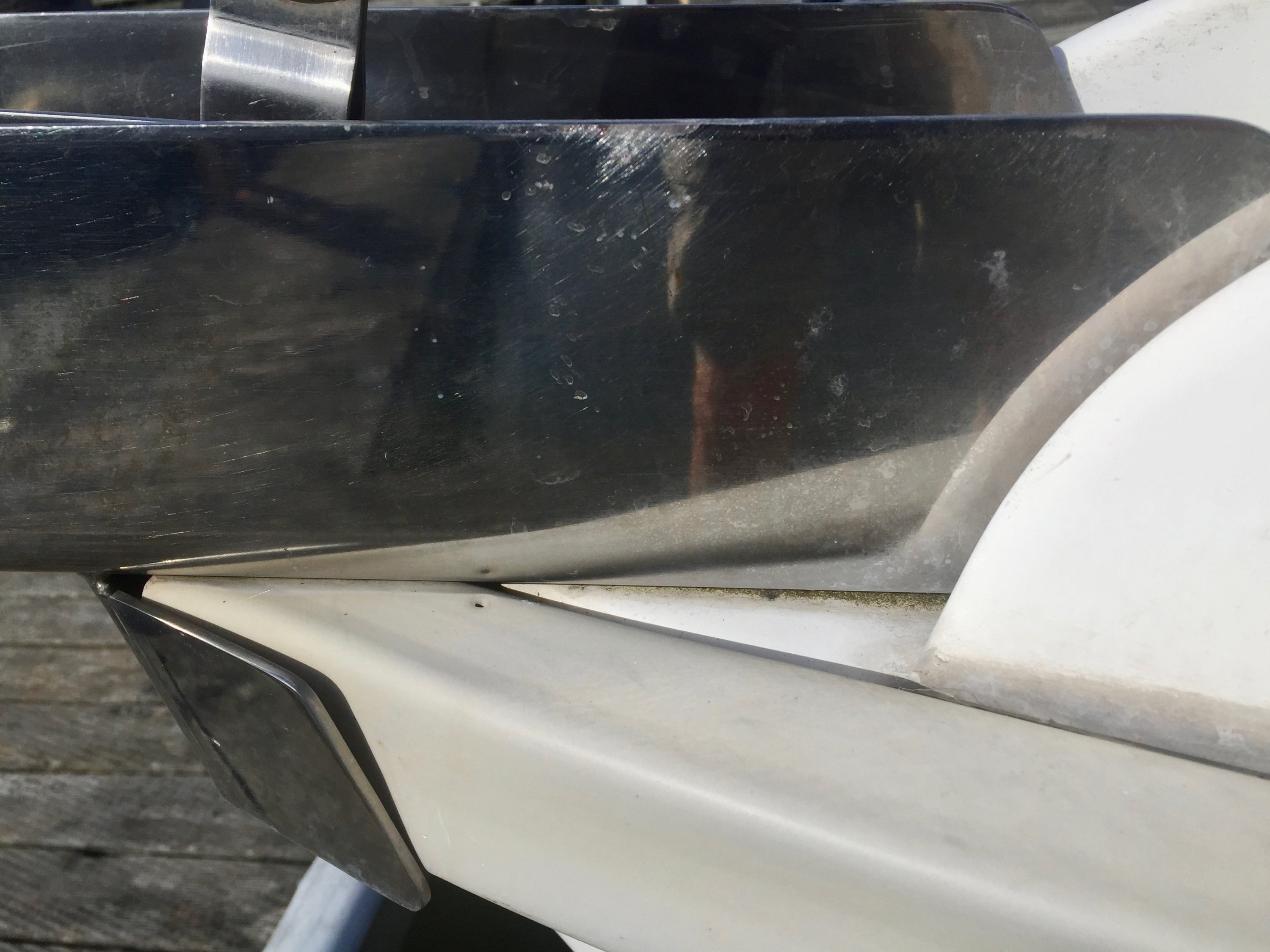

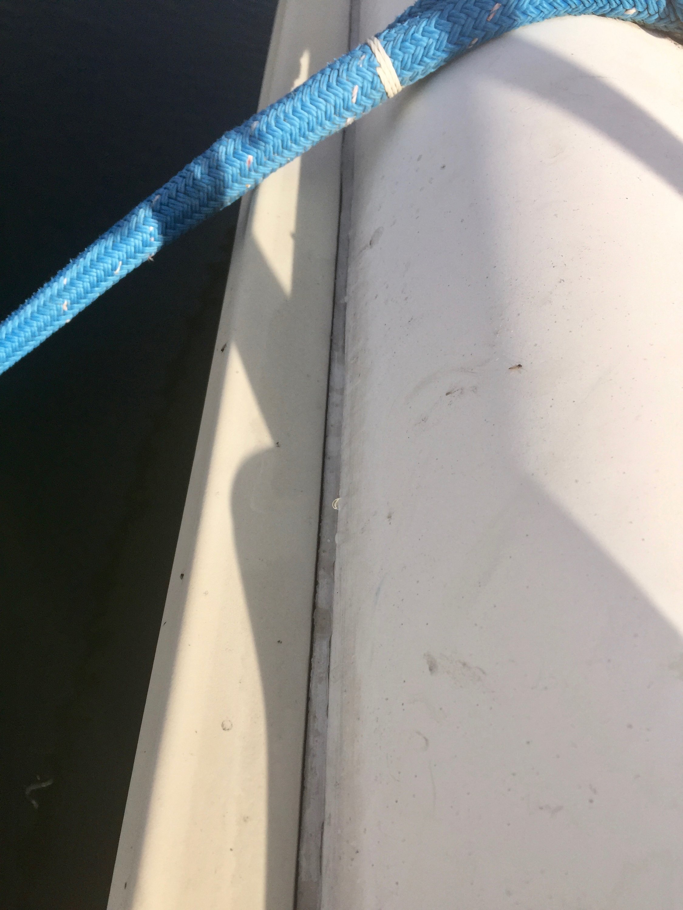

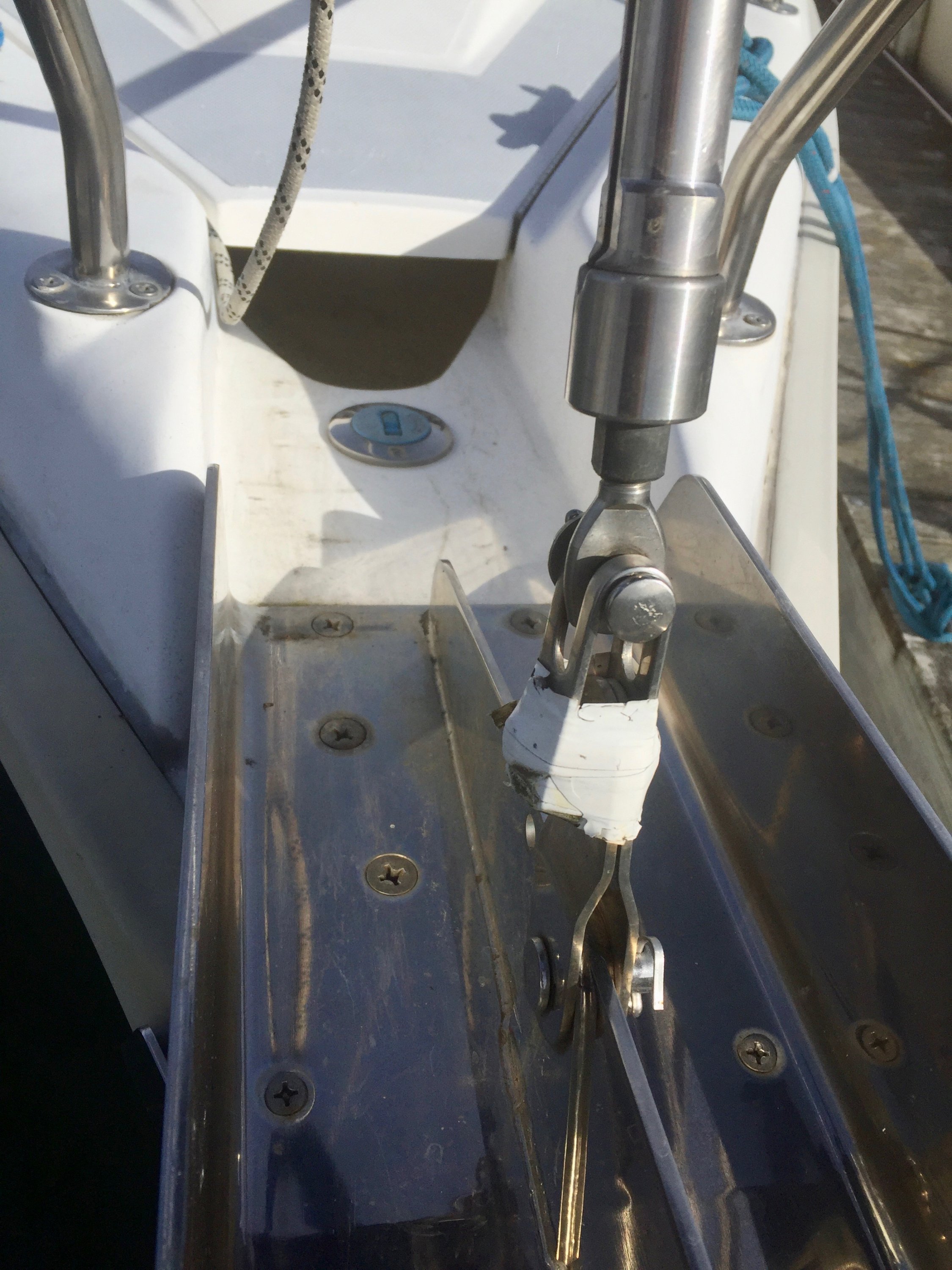

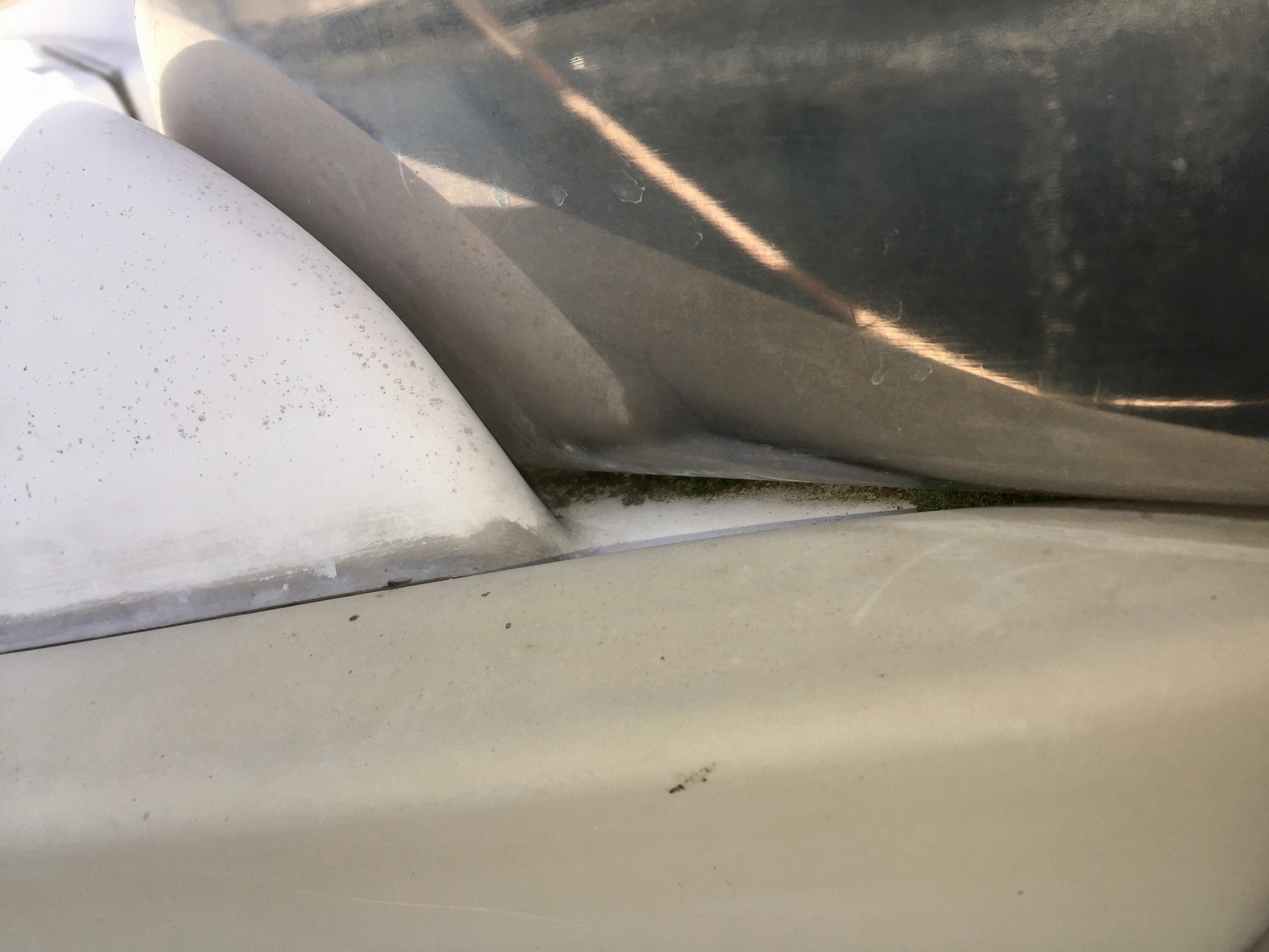

Not sure what the "caulking sealer" is but I took some additional photos that do show some gaps between the rub rail and also under the forestay link plate. I was shocked when I took photos inside to find out that Hunter does not use any backing plates anywhere with cleats or stanchions but I guess you get what you pay for.
10,532
-na -NA Anywhere USA
Bruce, I suspect or suggest resealing the bow pulpit, cleats, fresh water filler and any cockpit drain. I bet it will be one of those. I doubt the hull to deck joint as that generally is sealed together with 5200. I would still suggest hosing down each individually first with the help of a friend and you may need to use cell phones to communicate with if you cannot hear from above. Remember the boat is a 1996 or over 20 years old and caulk does not last a life time which is a maintenance item. I would start with that sir. thanks for the photos as it helps to refresh my memory.

My experience with Hunters is the Toe Rail, Tighten all bolts/nuts (yep 2 person job from above an below). and then spread a bead of 3M 5200 along the rail on the deck. Use a rubber glove and smooth the calk as you go. I'm thinking that will do the trick! Also, check the Engine compartment cover in the cockpit, mine leaked and it flooded the bilge.

The 29.5 has a sealed flange seam at the deck with a molded toe rail. No bolts
