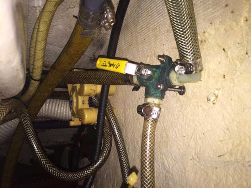

All of a sudden, i'm getting water seeping back up into the icebox.
I haven't had time to take anything apart yet, but based on the plumbing I'm assuming it has to be a bad valve, but how do these go bad?
It's a T junction with a selector valve. I don't know what those are called.
It selects what the foot pump gets, either salt water from engine intake, or drain from the icebox. See image.
If I leave it in the position that pumps icebox drainage into the sink, then salt water seeps in slowly somehow (takes a while).
I haven't tried leaving it in the other position now that I think of it.
I'll have to take a picture of the actual valve, but it has a metal handle similar to the one I used to make the image, and just selects A or B from one source.

Your setup sounds more common based on the diagrams I've seen. I'm not sure if my setup (mkII) was changed or the PO did it. either way I like it. Salt water foot pump is great. Saves fresh water and battery. My bilge stays dry, so draining the icebox into the sink is a good thing to me.
The new three way valve works. No leaks. West Marine carried it for $6 more than Grainger ($30) but Grainger had $10 shipping, so with tax WM was a wash and I didn't put too much money down this drain. :)

Commonly called a Y valve. You can sometimes find them at regular hardware stores, but it's a pretty limited market for these so most stores don't stock them.

Yep. Sorry for calling at an A/B valve, didn't know what to call it.
