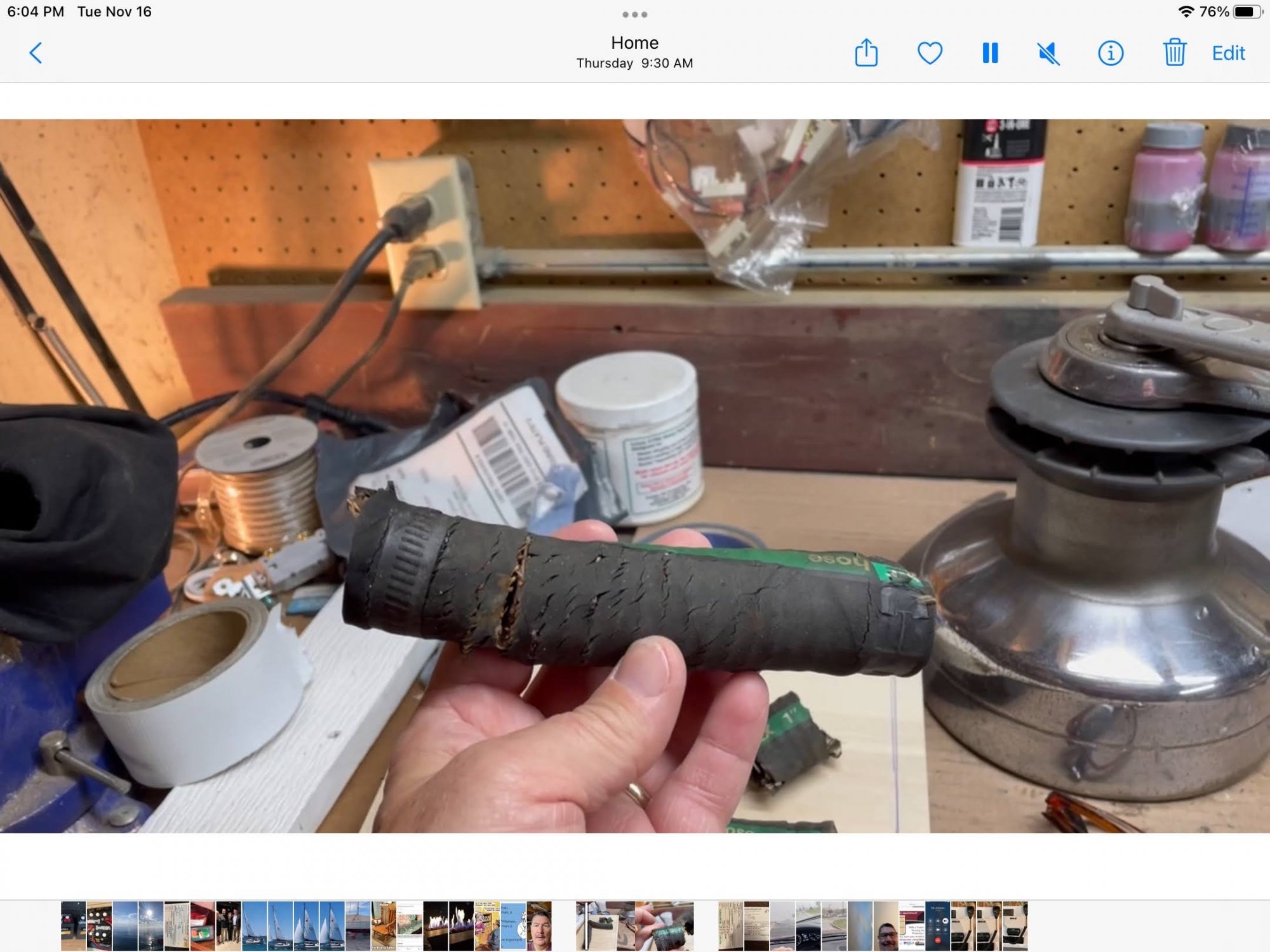

While you are at it, check the hoses attached to those valves. I had a drain hose under my galley sink that was totally rotted out…you should really inspect all of the hoses by squeezing and pulling on them…I ended up replacing the skin fitting and rebed the piece…I have a lot more peace of mind now. And remember to keep the thru hulls closed when not on the boat…

What was age of your cracked hoses? Had an older boat on my dock that sunk a few years ago because of an open galley drain valve and hose failure.

Old…I assume original to a 1988 boat. oddly, the front of the hoses didn’t look too bad, but I brushed Against one and it oozed water…upon inspection, they were totally rotted. Luckily I was in the habit of closing that thruhull when I wasn’t on the boat…
