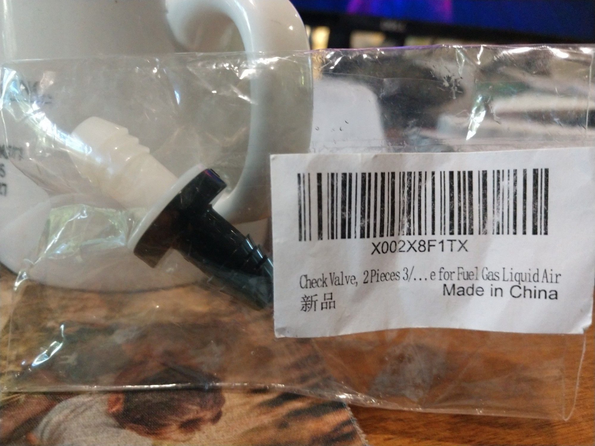

This is the one that was on my '98 H240. TMC Self Priming Water Galley Rocket Hand Pump Faucet FO-742-1
Mine had a broken barb to thread fitting on the bottom that I was able to replace. The pump would not hold a seal but rather than replace it I added a check valve in the waterline to the pump.
If you need a replacement fitting for the bottom of the hand pump the part is:
Lowes
3/8-in x 3/8-in dia Barbed Barb x FIP Adapter Fitting
Item #877079 Model #BHB-298NLB
Lowes
Awesome information! That looks just like ours. Thanks, Pat!
10,060
Usually, the seal where the handle goes through is a small rubber o-ring. It can sometimes be reached by removing the bottom and getting the piston and linkage off of the handle. I had a very similar handpump on my old Spirit 23..
