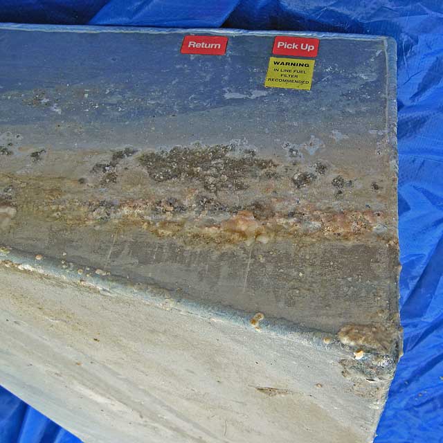

Dear Fellow Owners,
The picture shows the severe corrosion which resulted in fuel leakage.
A new tank was purchased from Catalina for $700.
We put a limber hole at the lowest point in this compartment to drain any future water into the bilge.
The tank was setting in what was apparently fresh water and we speculate that a person cleaning the boat sprayed the top of the tank with water which started this chain of events.
You might take a look down along the forward edge of your boat's tank to avoid a similar fate.
