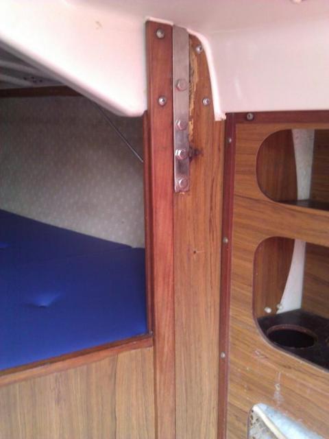

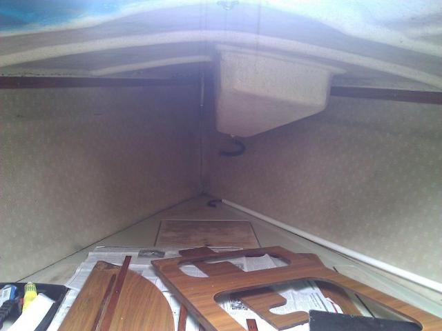

During the renovation process of the interior in my Y25MKii I came across some leaking problems.
One was already mentioned here and was related to the starboard side wood pillar inside the cabin. I opted for not removing the pillar because, as suspected, was part of the structure of the boat being the connection between the shrouds and chainplate. (pic2)
However, I detected some more infiltrations in the boat connects to the shrouds.
I suspect that both shrouds, Upper shroud chainplate and Lower shroud chainplate are not well sealed.
Also found a leaking in the bow of the boat with water accumulated in the v-bert area (not much, but some) that comes down running down the wall on the starboard side thru the interior lining of the wall (it’s all wet the fabric in that area). (pic1)
I suspect that can be a sealing problem in the Head stay fitting also. These are all problems on the Starboard side of the boat.
Is there any way that the sealing can be improved without having to remove the all chainplate and shroud systems?
Or, can I remove, one by one each time, and proceed to a good sealing, and put it in place again before moving to the next one?
I’m new on this and where I live don’t have much places to do boat work neither have people who know how to do it. If I want professional work (which will be pricey) need to sail the boat to Hong Kong (I’m in Macau, 42 miles from Hong Kong) and leave it there.
Thank you for the ideas

The chainplate looks like a straight forward fix. I'd tie off the mast with a halyard, disconnect and remove the chainplate. Then I'd replace the wood bulkhead and reseal the thru-deck. As far as the headstay fitting..... you can remove and reseal that also... again use a halyard for mast support. What you may want to check is the stanchion bases for leaking also, not a particularly difficult fix... Also... the hull/deck joint may have leaking issues.... try squiriting water under the rub rail and look for seeping.... While removing and replacing the rubrail is a chore... you may be able to shoot some sealant in any obviouls places without doing that.
