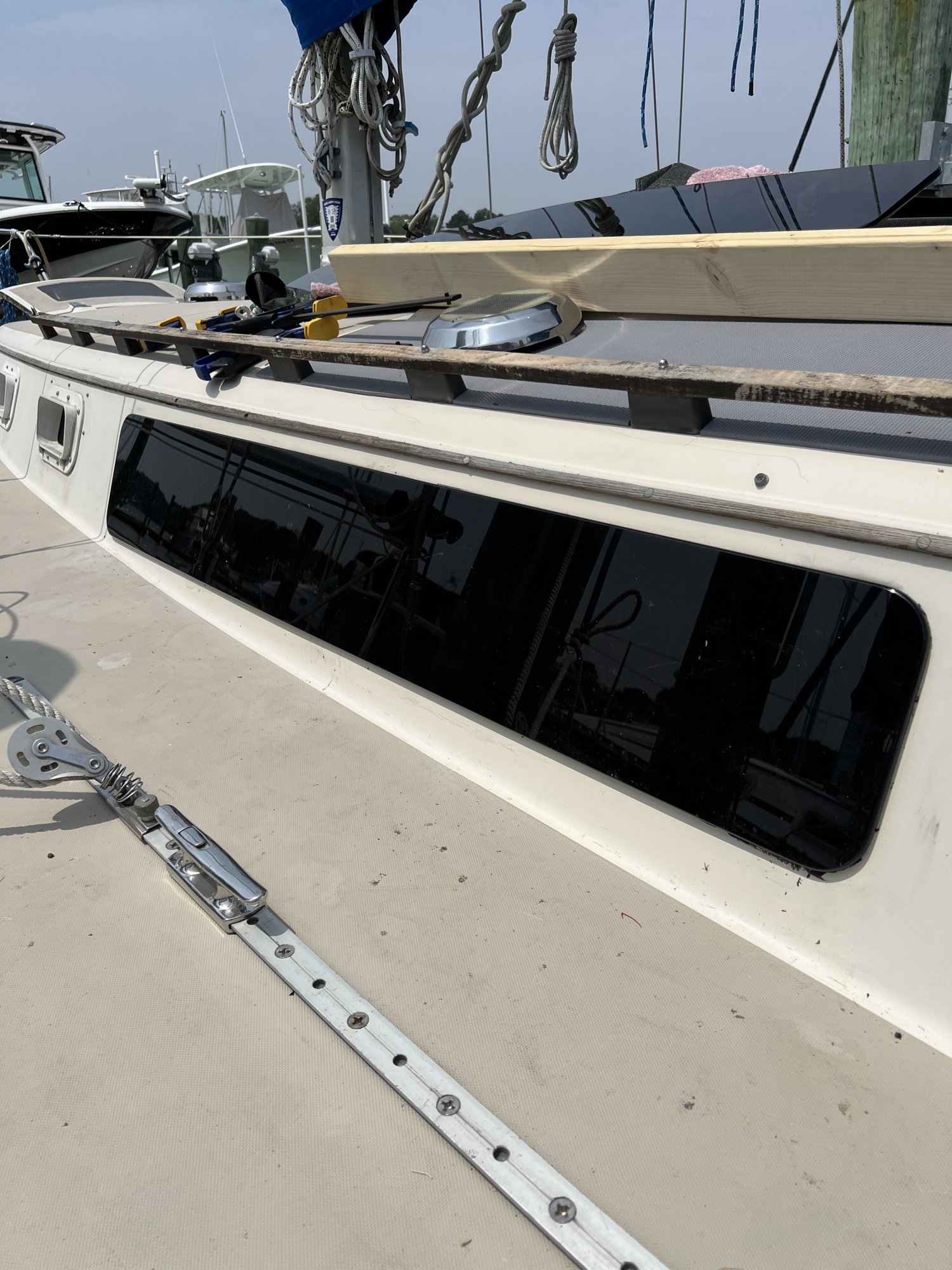

As I continue to repair and eliminate leaks, I have found a few more. The big question is: Trim or No Trim? Obviously it's a preferential issue for appearance, however I find washing the teak, getting rid of the dirt build up that gathers behind the trim between attaching screws a real pain and then the quarterly wiping down with teak oil to keep it looking good and healthy, a real pain, even with using painters tape to avoid discoloring the plastic (for lack of a better word). I wonder how it looks without. And now that I have my new windows in that are non O'day style, maybe without would make it look better.

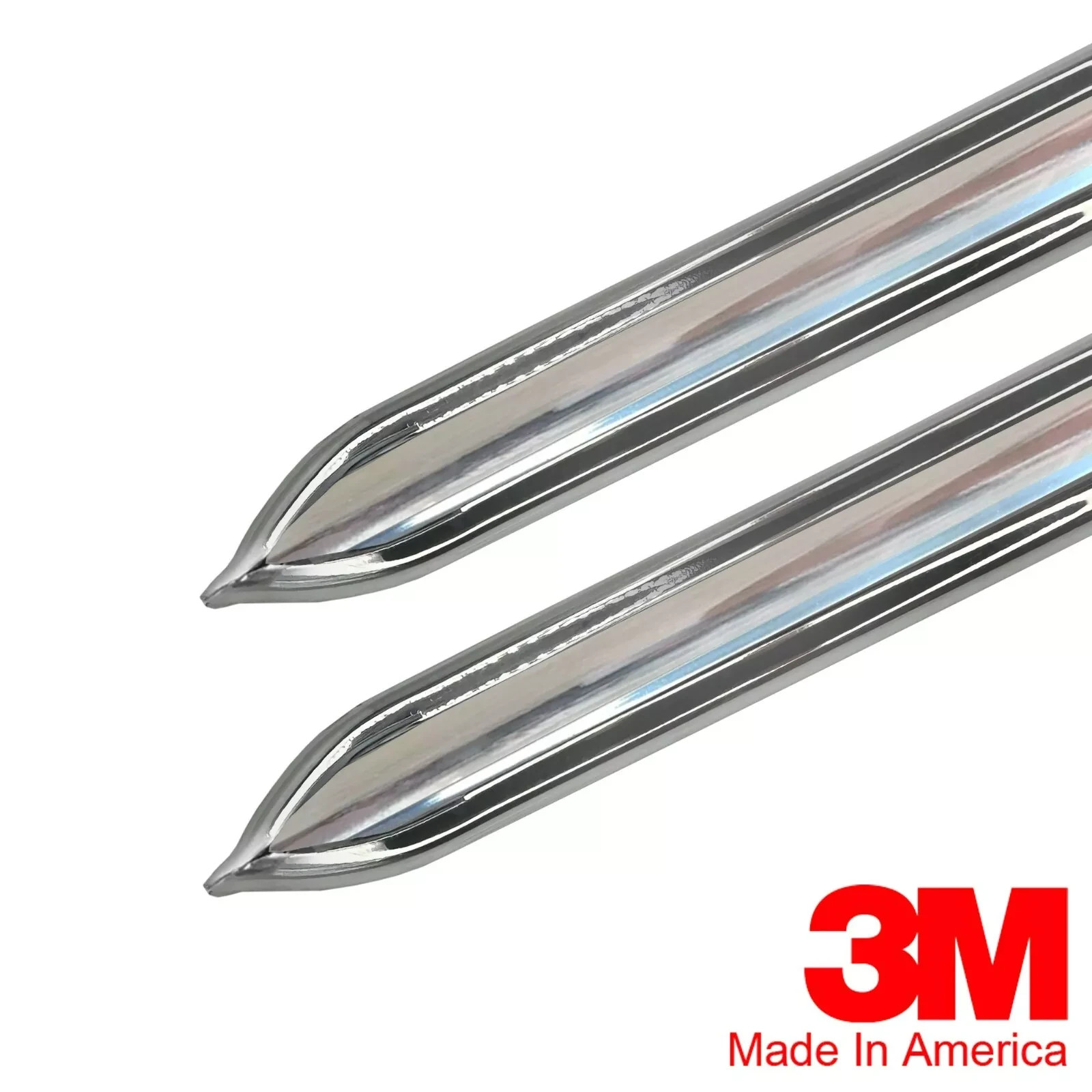

And then I thought of replacing the trips with this kind of stick on product, once the old screw holes have been filled and sealed with gelcoat. At least the maintenance issues are resolved!

How long will it stay looking good? Will the chrome look cheesy or cheap?

On my Catalina4 34 I removed the eye brows teak and filled the small screw holes. After a month never missed them again many c34/ 36 and I'm sure others removed. Good luck

I think it was @dmax that had replaced his teak toe rail on his O'Day with Plasteak. Same configuration. Whomever it was, they ended up destroying the toe rail to get the screws out as trying to preserve it took too much time. I removed a few of mine and I would agree that it's incredibly time consuming

I replaced the teak “eyebrow” by filling in the screw holes. Then I just used blue vinyl tape to cover the area. Looks fine but I need to replace the tape after five years in the sun.
For the screw holes use a countersink in a drill going counterclockwise to bevel the holes. This gives a nice area for the filler to fill and eliminates any raised sharp edges around the holes. Once sanded smooth it looks fine. Epoxy with colloidal silica thickener works good.

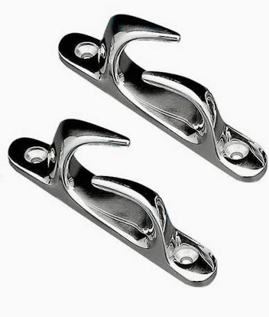

Yes, this is my issue also. A couple of the sections are cracked or have been repaired. Some of these screw attachment points also leak and need to be fixed. Where my spring line rests on the capping it is showing signs of wear. I was thinking of attaching additional skene bow chocks like these and removing all the teak capping.
