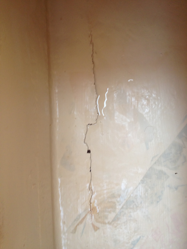

I have a 2001 26 foot hunter and I just noticed my water ballast tank leaking under the front seat of the dinning sette. I lifted up the cushion and the removable bin cover and the flat surface under that seat has a crack in the fiberglass about 8 inches long and water is oozing out of it. I am assuming this is the water ballast tank. When I recently had the boat hauled out I filled the water ballast tank with fresh water instead of using salt water. Could I have filled the ballast tank too full and this is causing water to come out? Should I try to pump some of the water out of the ballast tank, or just open the fill valve and will the level of the tank go down? How do you fix a crack like this? Any help would be appreciated.
Here is picture of crack.

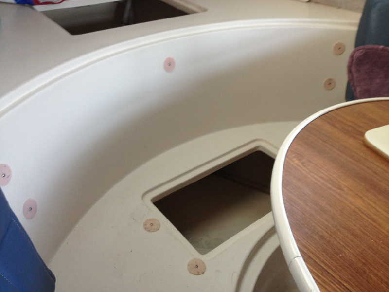

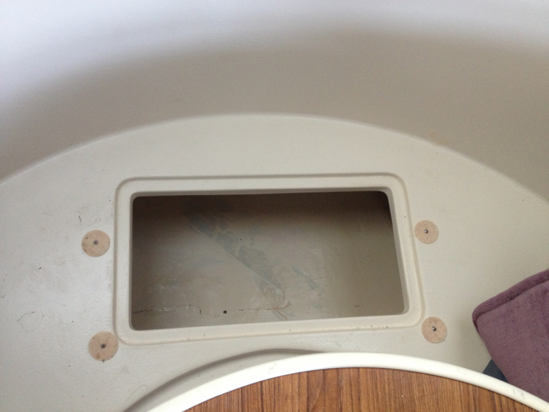

Here are three photos to help show situation.
First one shows boat after lifted out if water. It was raised with a travel lift. The heavy growth area is where strap was placed. When you zoom in you can see that is is just behind " lift here" words. So it might have been lifted slightly in wrong spot, also they did not empty ballast water until boat was on stands. Is any this concerns?
Other two pictures show the inside of boat. The area where is leak is under the front most seat at the table, the rounded one. The fresh water tank is mounded in this same area. I have pumped the ballast tank down about half down and there is not any water at the crack now.

The very first thing is to insist restraining chains be put on the stands to keep them from accidentally pulling apart or you will have more damage then ever.
It has been some time since I saw but if this is the top of the ballast tank, the first thing is to drain immediately all water from the ballast tank and of course you do this by this by going to the most bottom step, pull it up and loosed the big ole wing nut and push it down and if necessary with the foot. Also make sure that the drain bail plug that allows air to enter or escape the chamber is open.
Here is what I would have done. I would cut the area out of course making sure this is where the water is comeing from making an oval cut. Then I would take the edge of the hole and sand them from the inside to the outside at least a 45% angle or more. Then, I would take sandpaper say like 120 grit and sand about an inch on the inside of the tank around the edges to clean off any scum and get an good adhesion surface.
I would then cut a piece of cardboard with string big enough to cover the hole by an inch to 1 1/2 inches. As for the string, I would then put it thru the cardboard and back out so to hold the cardboard in place. I would then cut two pieces of fiberglass cloth cut to the size of the cardboard and string the string thru it as well. I would then take resin mixed with resin, gel coat and hardner mixing very well coating the cardboard first and then the first layer of glass and then the next. You will need to add more hardner to kick it off quicker for the first application. Regarding the harner, standard hardner is a lower temp. hardner used for fiberglass and gel coat requies a higher temp. hardner. Just make sure you have it.
the I would insert the cardboard into the hole and hold it against the interior of the tank lid until it kicks and holds in place. Let it dry overnight. This gives you a base which to work from plus a locking base. Now I would then cut a layer of glass to fit the hole only and each successive layer larger to overlap only with the angled edges coming out. Instead of usual hardner, I would use gel coat again using the higher temp harner and a little resin and apply. Please understand that you will then need to dry overnight as this drys slower than reg. hardner. Also make sure you either roll out the air bubbles with a resin roller or brush and also making the layer of glass smooth. Apply more fiberglass unitl even with the tank lid. Then I would spray a little black or gray paint and sand over to find the valleys. Then add a finishing filler epoxy of course and I always used Water Tite. Again that drys overnight. Wet sand smooth and apply a finishing coat of gel coat and let dry and then you are done.
Not sure how that crack would have occurred unless you hit something or the placement of straps earlier would have caused that. It could have happened either loading or unloading from the trailer or placement of earlier stands. One other thing I would look at are the forward bunk boards to make sure they are not going up into the hull and that can be corrected thru adjustment.
I know this is long but at least you have an idea how I would as a dealer and one involved with these boats would have repaired it for you. Good luck sir.
