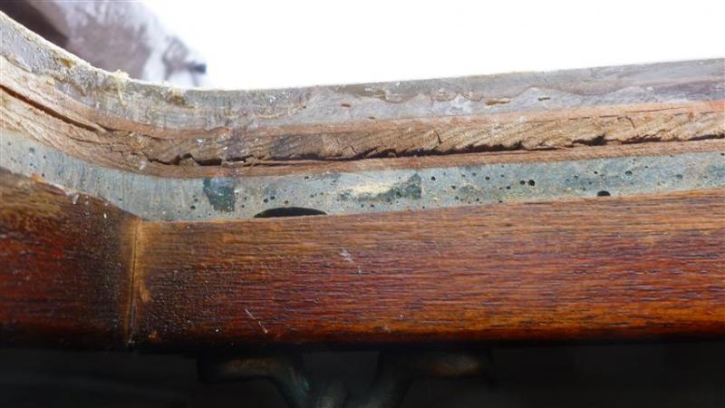

Jim, hard to tell, could be balsa or MP. Here's two flicks. Maybe you can tell me?!? :)
Stu, definitely marine ply, same as my Hunter. End-grain balsa is used because it is lighter but balsa will really 'wick' up water and rots fairly easily, so they orient the grain vertically between the fiberglass skins to control water incursion and also for compressive strength...hence the term "end grain balsa". Balsa turns to mush pretty quickly when the water gets in. Marine ply tends to delaminate before the rot sets in. Foam is of course inert but is harder maintain bond with. The core in your pictures looks pretty good - just some minor delamination in the second shot - a perfect candidate to the type of simple repair I was advocating.
