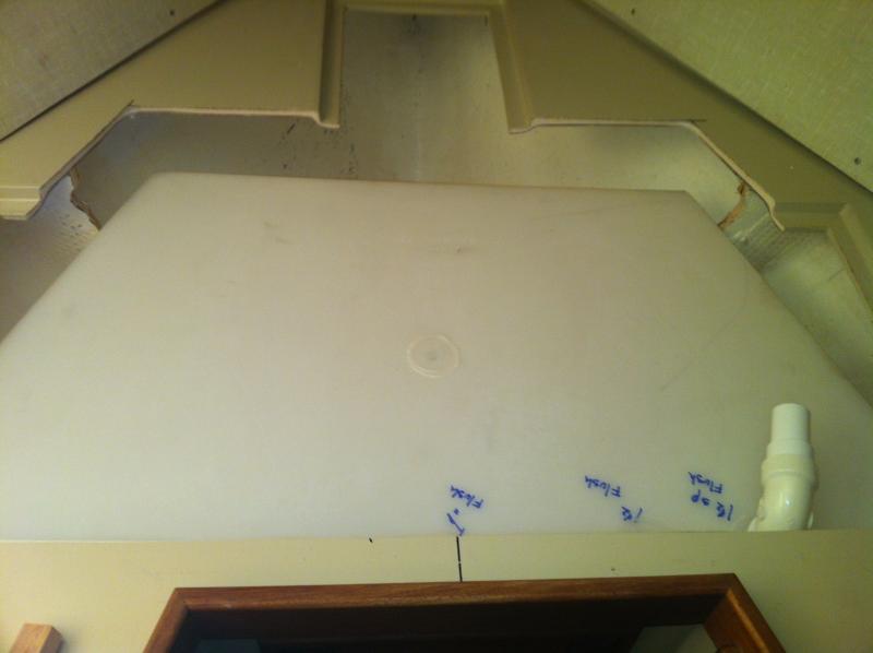

In case you do decide to replace the tank, here is a pdf describing the holding tank instllation I did last spring. The space under the V-berth was originally all storage but now contains the tank for storage of a different kind.:D Most of the time was taken up by the plumbing issues which you will not have to deal with. In all it's a pretty intimidating job to start but not all that difficult once you get going. (See attached photo & pdf for a detailed description)
Cheers
Matt
