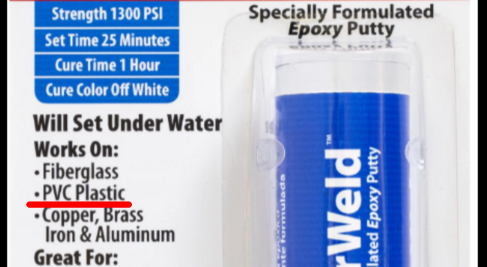

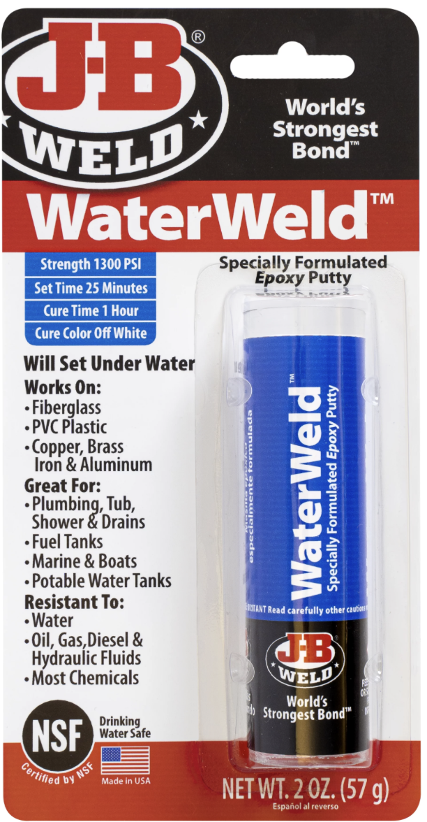

V- Berth Tanks always take a pounding from the waves against the bow.
You can remove the old Putty and clean the crack area well. Then use this to repair the crack.
Epoxy Putty
Walmart Price < $10
Jim...

Not saying age caused the crack, but it may have likely played a significant part, it is time to replace with a new one.

Yup...as I have said many times, there is NO sealant, glue or any other product that will bond permanently to PE.
I agree with Benny...that tank has been taking a pounding for 34 years...it's time for a new tank.
--Peggie
