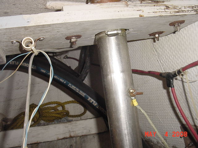

I had` a 1980 H30 with a similar problem. I'll bet that your metal bulhead is actually the SS water lift muffler. It sits under the shelf that holds the batteries and fuel tank. My best advice is to replace the entire exhaust hose and muffler system. On my boat, I could access the exhaust thru hull through the starboard lazarette and disconnect the hose. Disconnect the hose from the mixing elbow on the engine. Then, laying on top of the engine (cold) and facing aft, you can pull the whole exhaust assembly out and over the engine. It is much easier measure and assemble a new engine hose, muffler and exhaust hose unit with the whole thing out on the dock or workbench. Replacement is just the reverse of the removal.
Ask Hunter marine for a source for the muffler. I replaced the old SS unit with a Primex fiberglass muffler Part # MC2. The old number for Primex is 407-886-1144 but may still work.
