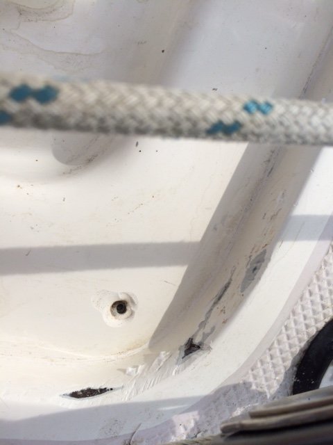

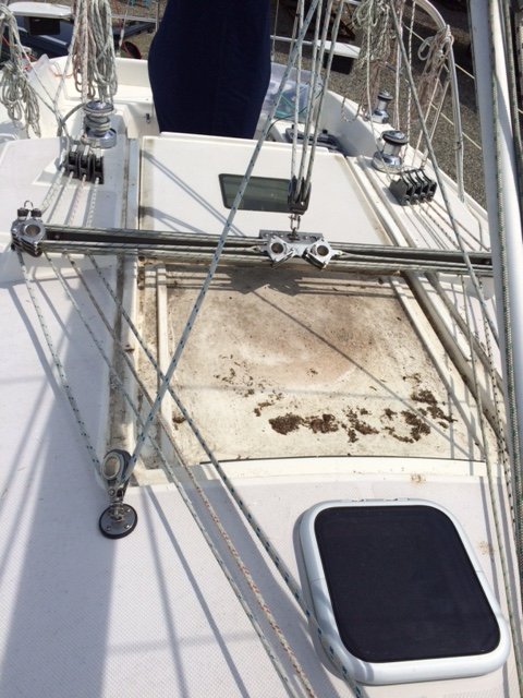

I've had water leaking form the overhead light near the sink for years. It originates when water gets under the slider via the drain tracks. This year I removed the slider cover and found no overt leaks below, but the through screws were not bedded into the lower layer (that is, they were bedded into the top of the cover, but there were unbedded holes when they go into the deck itself). I bedded them and am hoping that will take care of the problem. A couple of pics are attached. Removing the cover was fun....
