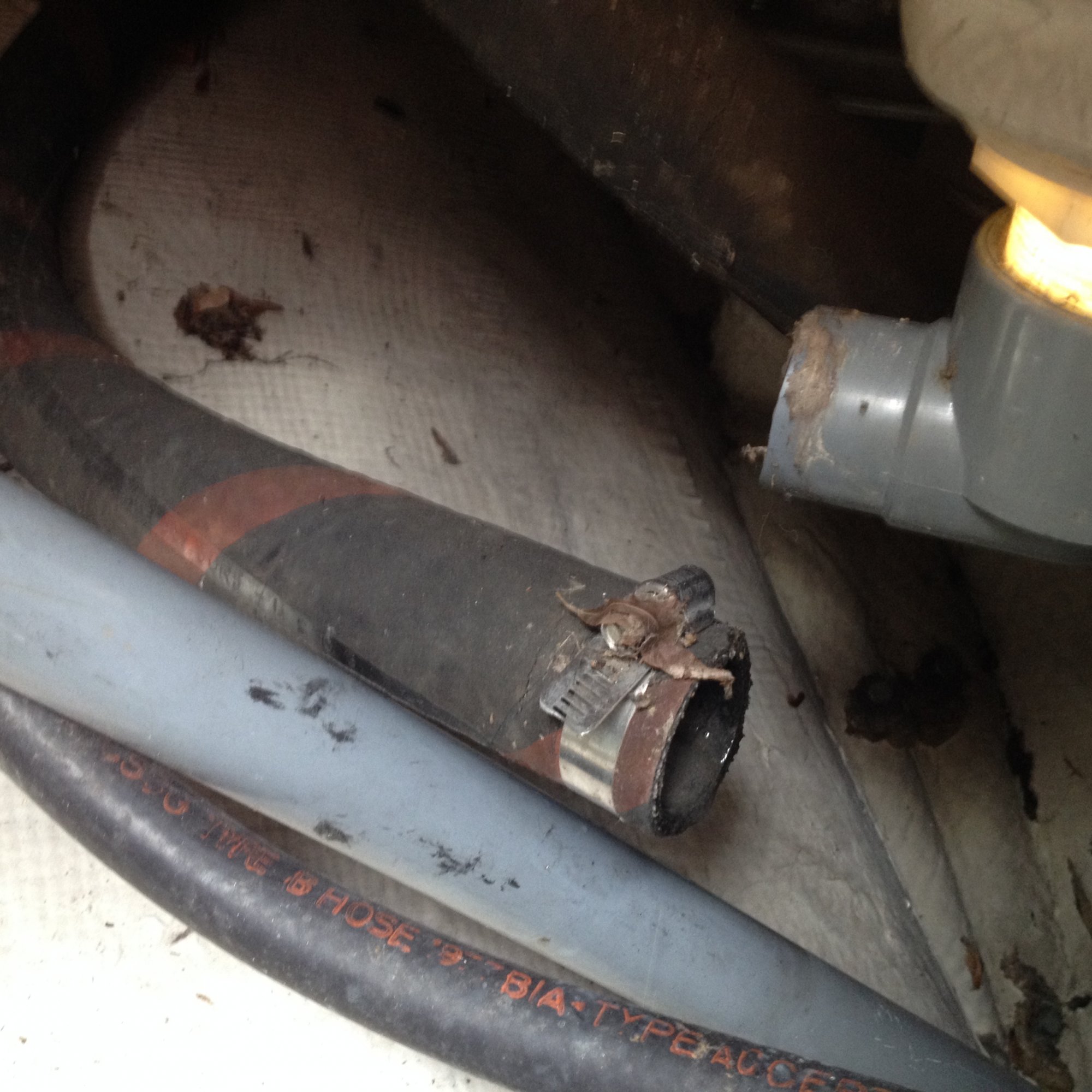

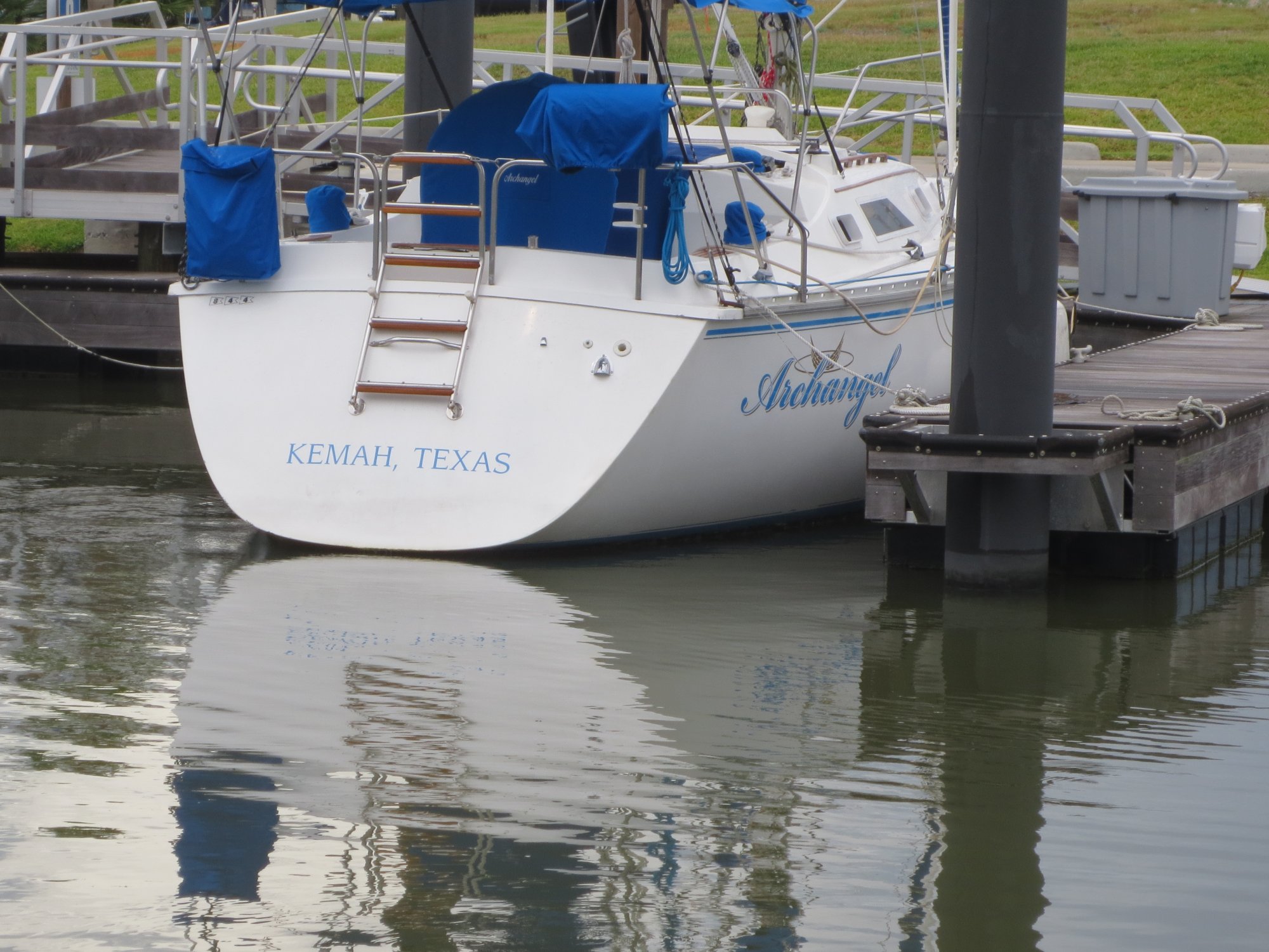

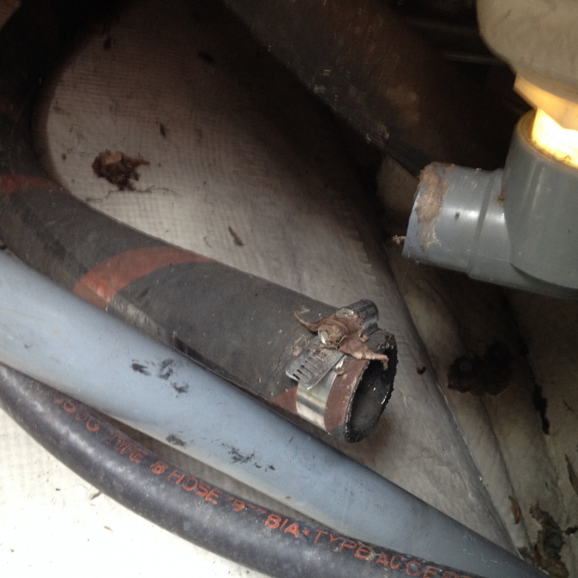

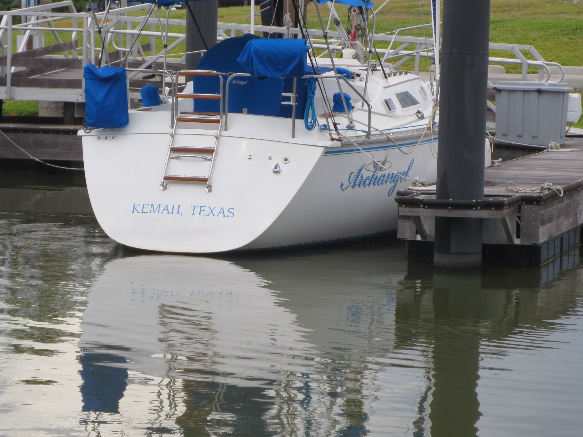

Hi Tom. I too have a H31 same year as yours and have suspected for some time water trapped between hull and liner because my stern is always sitting low in the water where the water line meets the stern. To me it is just kissing the water when in the slip. As far as water trapped, how are you seeing this manifest inside your boat if it’s between hull and liner. Like others, I am able to easily access the port side cockpit scupper and don't see where any leakage would allow water to seep between hull and liner but as I said, this has been a puzzle to me since I've had the boat. See pics of my stern in the water and also the scupper and engine overboard are located. My main bilge is dry and the sump area below entry steps occasionally has a small amount of water in it but nothing of concern.

Your picture of the drain shows what to be a plastic elbow? The elbow should be longer where you can double clamp with two hose clamps in opposite direction
  • Helpful
Likes: JamesG161
Nov 30, 2015
1,343
@CaptainKook
you probably have a hull to deck joint issue like @Brinky63 did with his boat. He has a separate thread on how to repair the stern.
@BlowMeAway.
Hi Dave, yeah whomever made a repair on that plastic elbow cut away all but 1 hose barb. I replaced the scupper, elbow, and double clamped years ago. Nonetheless, good catch on your part.
