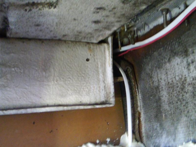

We have one leak that I haven't managed to eliminate. When there is a prolonged heavy rain, water comes out the little hole of headliner corner and runs down to bottom corner of bulkhead liner and lands on the shelf in starboard cockpit locker that covers the frig condenser. See pic of area. I've assumed it is coming from cabin top, but haven't found it yet.

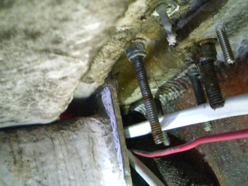

Took staysail traveler off today (took 2 strong men). Only thru bolted at each end, rest were screws into the deck. Poured Gorilla Glue into holes and watched water bubble up. Not putting traveler back on, saving for next owner. Filling holes and painting.
