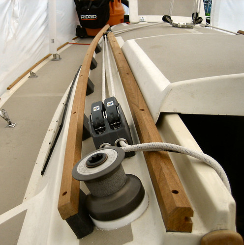

I did this with our C22 many years ago. All it takes are three lines (unless you have a roller furler on your jib, so only two lines are needed): jib halyard, main halyard and jib downhaul. The latter can run outside using the stanchions. See the picture below.
I found no need for a winch for either halyard for a boat of that size. Cam cleats are not a good idea, just use a cleat.
I didn't buy deck organizers, only used stand-up and cheek blocks, pretty easy.
If you want to run reefing back, then either reconsider or add two more blocks. I didn't find it necessary to run reefing lines back, some do.
For the vang, I just flipped it so the block with the cam cleat on it was on the boom and I could reach it easily from the cockpit.

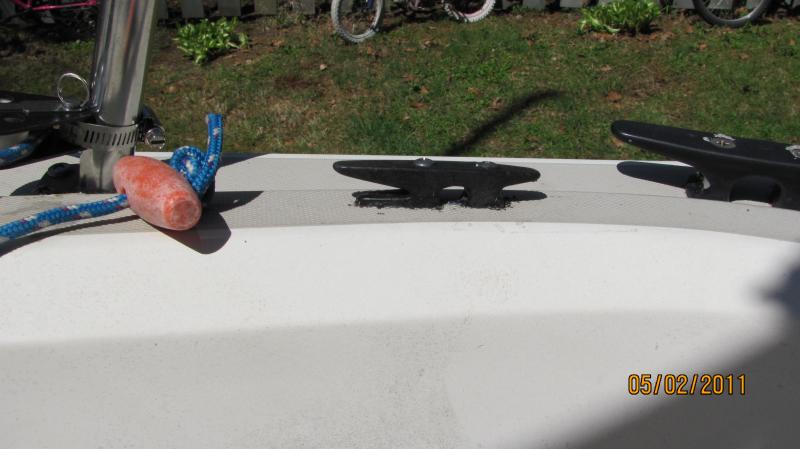

In fact, I don't think I'd even go with rope clutches. I would maybe go with horn jam cleats. These are the type that need to be mounted at an angle to the direction in which the rope is coming from in order for it to snub right with a single turn of the halyard.
Rope clutches have a built in fair lead and if you let your halyard off, it could get caught in it but of course you're going to be right there to straighten it out but what if you're at the mast trying to put in a reef and the line gets caught? With the jam cleat, there isn't much chance of that because there is no fair lead.

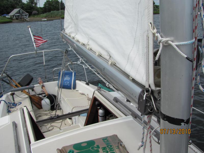

Why would you be standing at the mast reefing,-- anyway? Well, if your 23 mast set up is like my 222, you may need to drop the last sail slug out of the mast slot before reefing it or it's going to bind after you lower the sail and pull on the reefing line. There shouldn't be any tension on that last slide after you lower the mainsail and put the reefing grommet in the ram's horn. The tension should be on the horn and the grommet. Too much tension on that last slide can break it. Then on the other hand, it's possible that you don't have to remove the sail slide.
The first pic shows the jam horn cleat. I use it for my furler drum line. I couldn't very well mount it on and angle because my combing is too narrow, but the placement of the sheave provides the needed angle provided that I take a CCW turn around the cleat.
In the second pic you can see the sail slug out of the mast.
