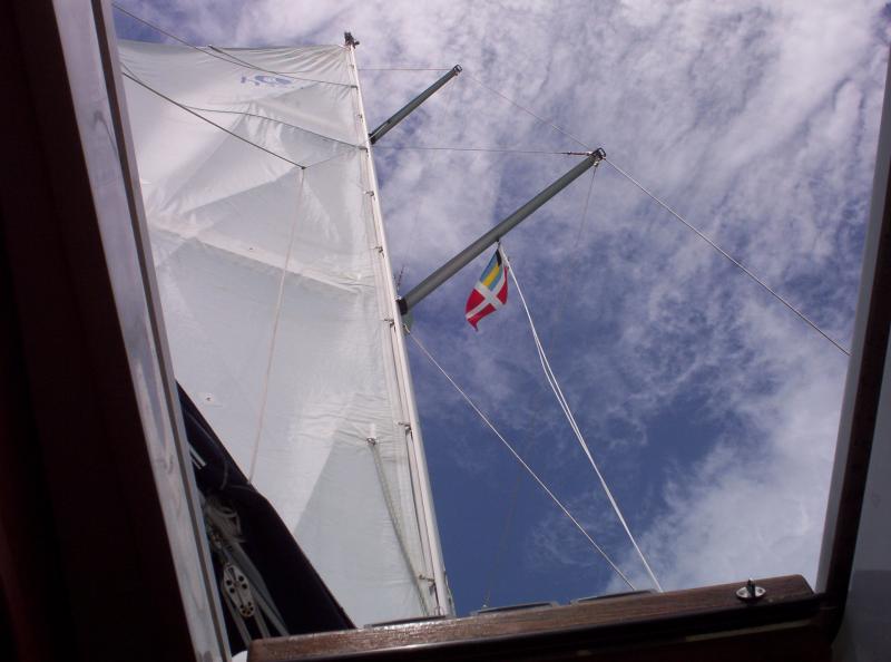

Oh you have also experienced the advantages of having lazy jacks, As far as I'm concerned thay are a PTA and would not have them were not for the weight of the main sail with that large roach. I cringe everytime I hear "I'm thinking of installing lazy jacks....." But enough on that. Ours are attached to the top spreaders but by line and not wire to an eyelid or "U" bolt. I guess they could have been spread farther apart to further open up the channel but since they all tapper down to the boom it may not make much difference. I think that line is kinder on the sail than wire would be but I don't proffess to know which is best. I'm enclosing a picture for your reference. Pvc pipes would do fine as battens for the covers.

Thanks - that looks like exactly what I was thinking.

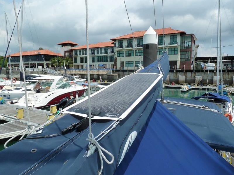

gareth, mine comes with pvc pipe for sailbag batten. I changed it to light aluminium tube, those retractable type used for floor mop. Just buy couple of them and join and cut to length. You can then extend or retract to the actual length required. Its better than pvc tube as it is always stiff and straight. PVC tube gets wobbly crooked when under hot sun.
As for the sailbag hanging under the boom, I cut 4 small (3" inch) openings on the sailbag at the where the aluminium tube is and cable tie 4 D-rings. The lazy jack is then ran through the rings before entering the sailbag. I then tie the Lazy jack to the D-rings to hold up the sailbag. If ever I want more sail area at foot, I can untie the knot at D-ring and let the bag slide down (but still with the Lazy jack lines around the bag) and secure it just below the boom as per original design. So I've 2 options here. Another mod is to put Snap Buttons on the velcro of the bag and the the web. The orignal velcro is useless.

Ken13559 - This is exactly the sort of thing that I was thinking about doing. Thanks for the pics.
It looks like you hitched the lazy jack line to the dring and then continued the line through the bag and cleated it on the boom as usual. Is that right?

Gareth, Yes the lazy jack lines continue on through the Sailbag. That way you have the option to slacken the lazy jack still have the bag held within the lines. And Yes that is the mop handle I use.
