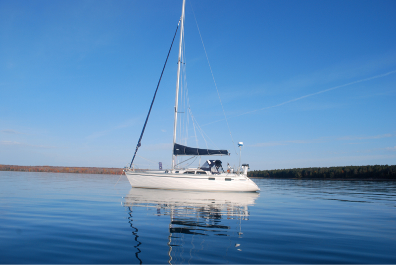

This pic should give you some idea of how the lazy jacks are rigged. The lazy jacks are attached to the mast above the second set of spreaders.

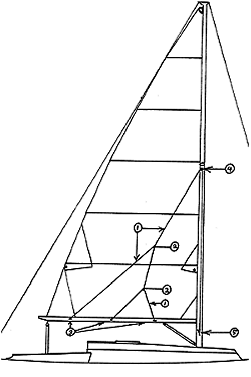

Lazy jacks do not get rid of a topping lift. You would need a rigid boom vang to do that. There are no special requirements for the B&R rig. There are a couple of options with lazyjacks. The Hunter standard system has 2 main wire legs attached to eyelets on the mast above the spreaders. From the main leg eyelets, there are 2 sets of rope that are support legs attached to the boom on cleats.
The sail cover is modified for each set of support legs.
If you are making up your own system, use rope main legs connected to SS rings with a clove hitch.
A modification of that setup has 2 main rope legs going up to 2 blocks on the mast above the spreaders and leading down to 2 blocks at the base of the mast and then to jam cleats. This gives you the option of varying the tension or relaxing the lasy jacks. You have the option of 2 or 3 sets of support legs attached to eyelets on the boom.
For three sets of support legs- The main leg goes down to a ring which holds the a set of forward legs and then after that another ring which holds 2 sets of support legs.
Remember that the boom supports the weight of the sail and the lazyjacks just contains the sail.
Since you can relax the whole rig with the jam cleats, you have to option of relaxing the support legs and bringing the lazyjacks system back to the mast by grabbing the support legs and securing the laszyjack rig to the mast out of the way. When you hoist sail no battens get fouled. Note that the lazyjack system is still secured to the boom, it is just out of the way. If you wish, you retract it at your dock before you leave. Just use a sail tie or two to secure the sail.
If you don’t want to step to the mast, you can rig two dousing lines to 2 blocks on the mast and douse it from the cockpit. When dropping sail, release the dousing lines and tension the support legs.
If you have end of boom sheeting you can devise it so that the entire lazyjack system is detached from the boom and goes up to the mast. There is a commercial system that does this.
When you are ready to drop sail you just tension the support legs and deploy the lazyjacks.
I’ve used my custom system for about 7 years based on an sailing magazine article.
My personal feeling is that after sailing, you should always secure the sail with sail ties. Don’t trust sail covers.
