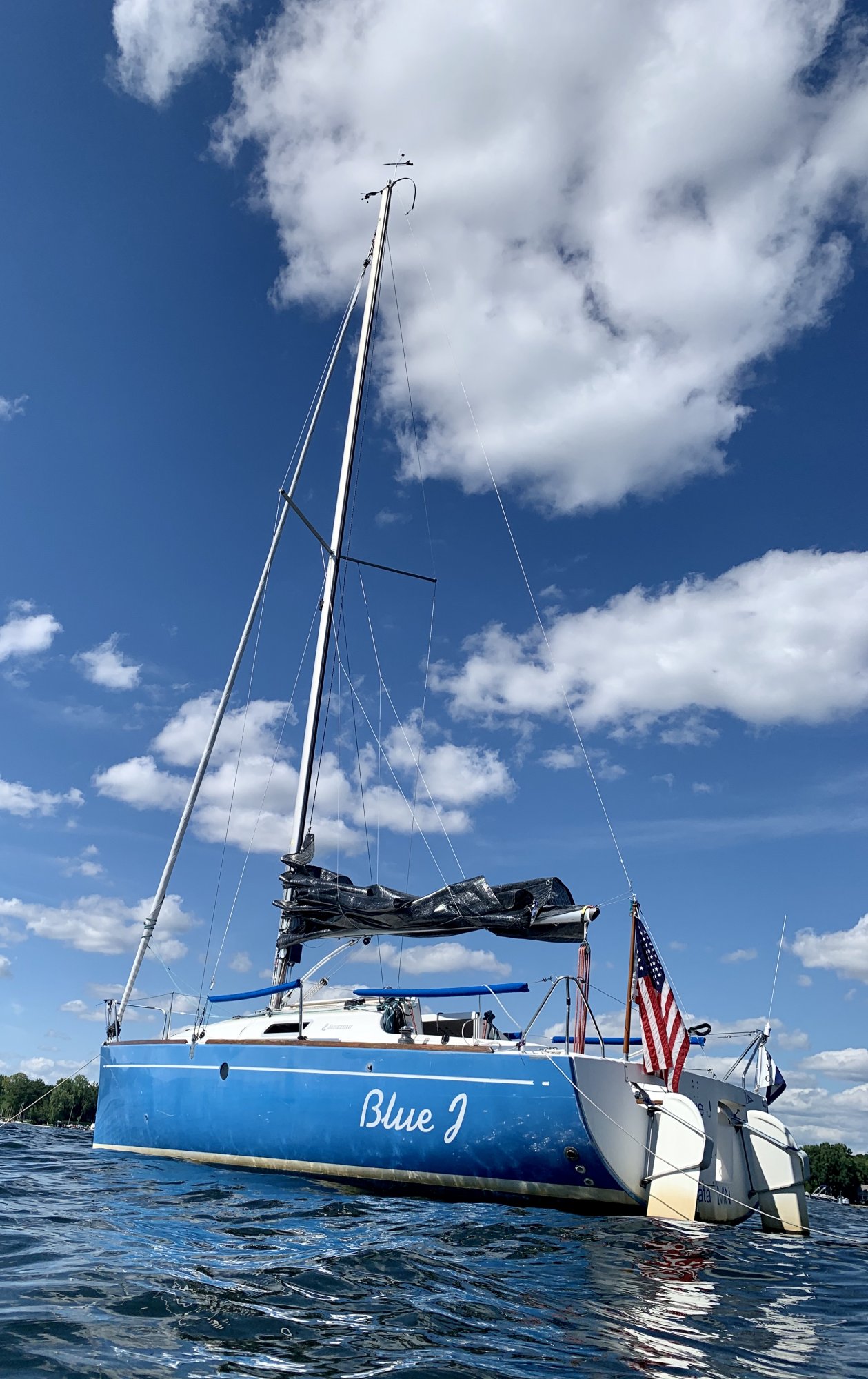

On BlueJ (First 260) we use 4mm dyneema and some small low friction rings spliced on. The whole set up is very strong, almost invisible, and never in the way. We used to pull it forward for racing, but we've stopped doing that. I think the whole setup cost 30 bucks.

Looks like they're attached to the spreaders? Seems like that would help keep them out of the way. Any concerns with loading spreaders like that?

they are, it does, and not really.
lots of new boats with jacks as standard equipment do this. As noted in the link above, using a strap and d-ring wrapped around from the top would make it even stronger. As it is, this is very strong.
