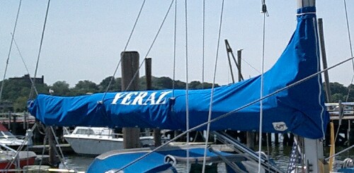

Lots of kits are available for lazy jacks for the O'Day 37. Be sue you get the kit for the longer boom, which has three lines, not two. I got the shorter one which works well but the longer woukld work better. Forgot to measure correctly. You can then get a sailcover kit from Sailrite and put lazy jack slits where you want them. We just finished making a new sailcover for the lazy jacks. See photo.
