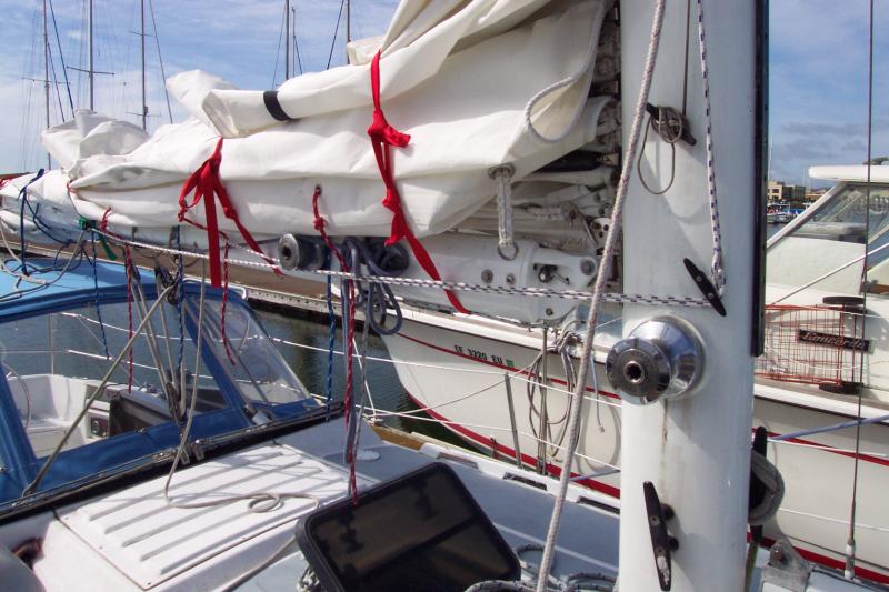

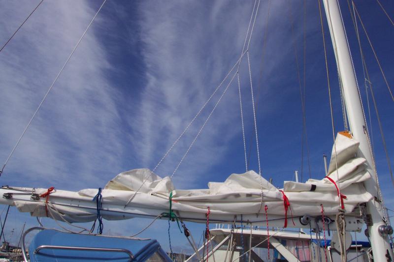

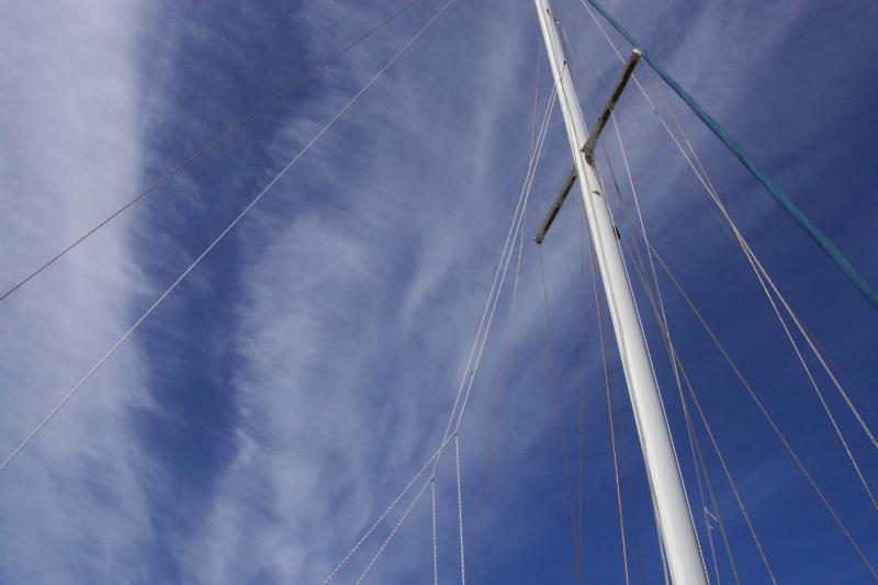

I figure you could use a very simple lazy jack system. My HC 37 with full battened main has only 2 "vertical" lines.
Previously the main sail used to cascade all over the place and with the admiral at the wheel and me alone bringing it down it was a PITA. Usually we bring the sail down just before heading in to the dock. I deploy the lazy jacks just before lowering the main and it keeps everything contained until we are docked and/or anchored and then I go back and secure the main on the boom.
All I have is a sheave on each side of the mast above the cross trees. A line runs up over that sheave (on each side of the mast) and then down to a ring. That ring has a line that runs from about 3/4 of the way back on the boom, over it and then back down to the boom again, about 1/4 of the way back on the boom. It could do with another "vertical" but I got 90% of the benefit with what I have so I will most likely never add to it.
So, you need two sheaves, two rings, four pad eyes, two cleats some line and some overlooked items. :D
The most difficult part is getting up the mast to mount the sheaves.
