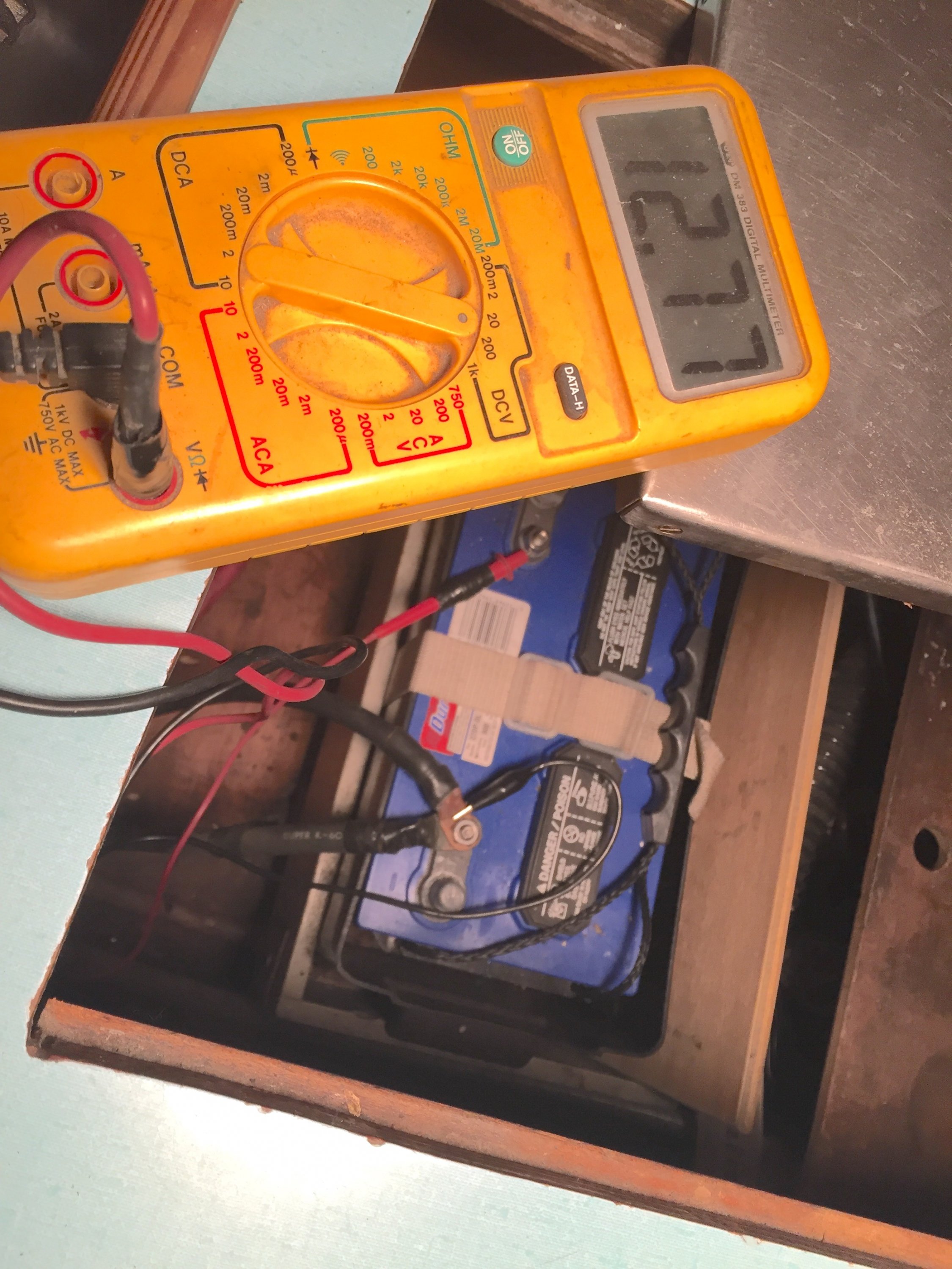

Then I checked the starting battery, which is a combination start/deep cycle( I've read that doesn't mean anything), which is 3 or 4 seasons old, and got this reading.
I'm wondering if my meter, which is 20-25 years old, is suspect? Or does the combination battery have a slower self discharge rate(I've noticed it reads higher, generally).
Or, is my new charger the blame? I usually charge the house batteries in tandem with my switch set at BOTH and all circuits off. Maybe I should charge them individually with the new charger?

Self discharge in, Maine, in the winter, is pretty close to nil. If you charged to 100% in Nov, the temps have been cold enough that your batteries have likely not been above 50F since. A fully charged battery, such as the deep cycle versions you have, should have a full charge resting voltage of about 12.71V to 12.74V, when healthy, and the dual purpose can be slightly higher often 12.74V to 12.78V.
Your house batts are most likely suffering, which is not surprising since they are not really a deep-cycling battery, more so a "light cycling" battery, and your start battery is probably doing quite well. The fact that the start battery is doing so well is not surprising since it really does not do much.
For most healthy flooded batteries, when I charge them in the fall, then 100% disconnect & isolate them, the spring voltages are normally still above 12.70V. When I find voltages lower I begin to suspect sufficient capacity loss. For example I had a healthy Crown G-31 in my shed all winter. In the fall, mid November, it had been equalized and stored. When I retrieved it the last week, to re-install on the customers boat, the resting voltage was still 12.83V or a "surface charge." At 80F this battery will hit about 12.73V after 30 +/- hours rest. When it's cold it can rest for months and not dissipate all of the surface charge.
Rx - Time to EQ the house batts.
If they can't maintain 12.71V or close to it, for more than 2 days at 80F (actual battery temp not air temp) they are suffering. Alternatively, you got two years, try pushing a third and replace at 4. Based on years of testing these batteries, here in Maine for mooring sailed boats, they are usually technically dead (by industry standards) by year two or three when put into a cycling situation. You can sometimes push them to 4 or 5 but this is where I begin to see a significantly higher incidence of failures such as internal shorts & crumbling plates.

I'll charge the 2 house independently to see if I can bring them up. I fear you can't get a high enough voltage from my 'smart' charger. I only put them in and take them out of the boat, once.
It's been the relationship of the open voltage readings of my 3 batteries, that's told me the most about each. Set on 100ths, you can age the batteries easily, in relation to each other. Once one begins to vary a 10th or 2, I know it's gone.

You should borrow a newer meter to compare. I have a cheap one on the boat just for quantitative readings and thought the new solar setup was not charging enough. I got my newer Fluke and found that the cheap meter was reading about .3 volts or so low.
