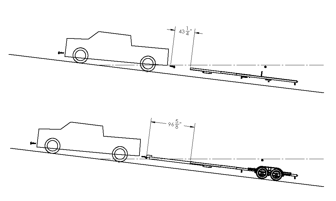

  • You can estimate how far the boat will need to go into the water by sketching out the dimensions, for a given ramp slope. Below is an example of a sketch I made for my boat when making a tongue extension for my trailer.
  • You'll need to get the boat far enough into the water that the water level is a couple of inches above the waterline at the center of mass. If the boat is correctly balanced on the trailer that will be about a foot ahead of the axle plane.
  • When assessing how far the trailer will need to go into the water, be careful that the trailer wheels won't go past the end of the ramp. That's obviously something you'll have to consider on a ramp-by-ramp basis. With a lighter boat you might risk going off the end of the ramp when launching if the bottom is sound and there's little drop off. But, with the Catalina's displacement, I wouldn't recommend it. My TES is just a couple of hundred kg heavier than the Catalina and I would need to be pretty desperate to consider it. You definitely don't want to recover with the wheels off the end of the ramp.
    • I keep a record of the minimum tide level I need to launch or recover at each ramp I use. That's handy for planning.
  • As you correctly identified, the slope of the ramp is a key parameter. They are generally around 9 degrees, in my experience, but I've seen nearly 12 degrees and as flat as 8 degrees. If you assume an 8-degree ramp in your sketch you should be fine.
    • I used to carry around a little jig I could mount my iPhone on to measure the slope of a ramp. But now I mostly eyeball it.
  • If you're launching in fresh water, then you can afford to back the tow vehicle pretty far into the water. I've gone far enough to submerge the end of the tailpipe, which isn't a great idea for a variety of reasons but I have done it once or twice. In salt water you obviously want to avoid getting the tow vehicle wet if at all possible. I normally launch in salt water so I try to avoid even the back tires of my truck touching the water. But I can't always achieve that, so I have a fresh water wash system in the back of my truck that I can hose it off with.
  • As you've also correctly identified, a tongue extension can help with keeping the tow vehicle out of the water. I've never used one but there are several posts on this forum about different designs, if you want to look into it.

Teddy has a good idea. On my 1984 H25, I used a 13' extension with a 10" rorating wheel near the trailer hitch that I had created. This avoided the vehicl's rear wheels entering the water. Find where is the end of the ramp and do not let the trailer fall of the end of the ramp. Launch during high tide ( does not apply to lakes). Measure the hight of water line of the boat using a 10" PVC pipe while the boat is on the trailer, then walk onto the ramp dock and measure the depth of the water to findout how far you will have to back up to make the boat float. This will tell you if you need an extension. Most ramps are 12 degrees tapered. It is good that you have 4X4, make sure the ramp is not slimy.
Mar 2, 2019
629
Oday 25 Milwaukee
I've had to use a trailer extension on both of our sailboats . The extension for our 22' Catalina would just slide out
of a channel and give us ten more feet .
The extension for our 25' Oday is 20' of 2" square tube with a 1/4" wall . Thick ,heavy and cumbersome would be an apt description .
Once the extension is installed getting the boat deep enough in the water is never a concern .
It's just another 5 minute step in the launching process .
That's part of the biggest differance in sailing and powerboating. The setting up to launch a sailboat is typically about 45 minutes .
A powerboat...all of five minutes
However ,it is neccesary given the very shallow ramp we normally use for seasonal launching.
We have found big differances in the angle of the ramps even on the same lake .
However backing the trailer into the water is very easy ,given how long the tongue and trailer are .

Yes, with that wing keel you will need an extension or a launching strap on most ramps. An extension is far easier to use than a strap since you can't push or steer with a strap. There is also the option of going to a marina with a travel lift or crane.
Launching a sailboat is pretty much the same as a power boat, but retrieval is a bit different. You can't power onto the trailer. Also the keel needs to be supported and on some boats it can be a bit fiddly to get the keel in the right spot especially if the water is murky.
While towing, a tie down forward of the mast and another over the cockpit should be sufficient. You might want to remove an outboard if you are going far.

I've helped people launch with a chain rather than an extension, which works just as well. The thing is, you may need launching wheel that clamps onto the trailer near the tongue. Some extensions are made with a wheel. An extension that slides out often doesn't need one.
You can't drive around with the extension. Where I am, people back the trailer to the edge of the water, block it, remove the trailer from the hitch, install the extension, remove blocks and then back it down.
Watching your trailer completely disappear under water is scary. I attached a safety cable to the truck, just to be safe.
With a rigid extension, you can do all the prep in the boat ready area instead of on the ramp. Some ramps are quite busy and people queue up to use them. It is much less stressful in the ready area than on the ramp when there are 10 boats waiting behind you while you fiddle with chocks, straps, unhitching, etc.

With our 20' extension ,it is most certainly possible to drive forward and backward with it coupled to the trailer coupler.
I've installed a 10,000 pound swiveling caster under the trailer tongue .
However ,if the ramps are busy ,I do as much prep work off the side and as far away from the ramps as possible
Agreed on the rigid extension. I think it depends on its length, construction, tongue weight, whether there are any humps to maneuver over, etc. that determines what can be done with it. I've launched a few boats where I didn't feel comfortable putting much downward/upward pressure on the extension. Plus, where I am, there is no way to access the ramp without a 90 degree turn that was always too tight for my trailer+extension, so I ended up doing everything at the ramp, which added about ten minutes. I only launch/haul for the season and am able to choose a time when the ramp traffic is low, though after doing this for many years, it's not too difficult and in fact when there is a delay it's usually some motorboat owner who backs down in a way that takes up room for multiple boats.
These days I have a gooseneck trailer that the previous owner modified with an extension that can allow a boat to float off with it. To say the least, it attracts quite a crowd because it looks like a disaster waiting to happen. It's really a good arrangement, just doesn't appear that way to onlookers.

I'm responding from personal experience. I have a 89 Catalina 25 with wing keel, road king trailer with extension and keel guides. A few years ago I was 'That Guy' at the public ramp you see in YouTube videos. I was attempting to retrieve my boat at a public ramp by myself in less than ideal conditions. It was a total disaster.
Here is a summary of what I learned from the experience:
1. Wing Keel trailer guides are useless. Because of the 'wings', you need to fit the keel into the guides very much like a key into a key hole: but, the key is at an angle (the boat is flat, but the trailer is at an angle due to the ramp), and you are in the dark (because you can't see what's going on under the boat).
2. Trailer extensions are useless. The trailer needs to be deep in the water for the Keel to match up with the opening of the guides. Add tides, wind, and swell and it is like trying to insert a key into a lock while jumping on a trampoline at night.
My solution is to strap launch / retrieve and float the boat on / off the trailer. To do this properly, you need:
1. remove the keel guides off the trailer
2. install a 3rd wheel on the tongue (I recommend 'Pacific Trailer Spare Wheel' setup)
5-Lug Pivoting Hub Mounted Spare Tire Carrier/Mount (Baja-style) (#PBT
3. Install guide posts on the back of the trailer to control the stern of the boat and so that the keel will line up with the center board on the trailer.
4. You need at least 2 (or 3 people), one to control the bow, and one (or two) to control the stern (via lines).
5. 20' tow strap, control lines for the stern, chains on the tongue, and tire chocks!

A note about transom straps: much debate about this one. I've done it both ways (including 1100 mile trip up the east coast a few years ago)
The boat weights approximately 6000 pounds, vs 1000 pounds for the trailer. The boat will go where it wants to, the only question is do you want the trailer to tag along with it? That much weight does not speed up, slow down, or change direction very fast. My current setup is bow strap, bow chain, and one strap across the cockpit, but only to insure the trailer is always under the boat, regardless where the boat is going. Do not recommend straps across the cabin or foredeck.
Here is a summary of what I learned from the experience.....
I don't think extensions are useless at all. I've launched my boat and several others, including wing keel Catalina 25s and 27s using extensions without any issues. But I do think you make an important point about conditions. I have certainly struggled to get a boat on a trailer when there are winds and waves.
