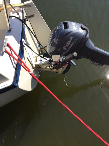

Launched today. Mast not stepped yet. Motored to mooring only to find out it was not there
Secured the boat to a friends mooring till I can find it.

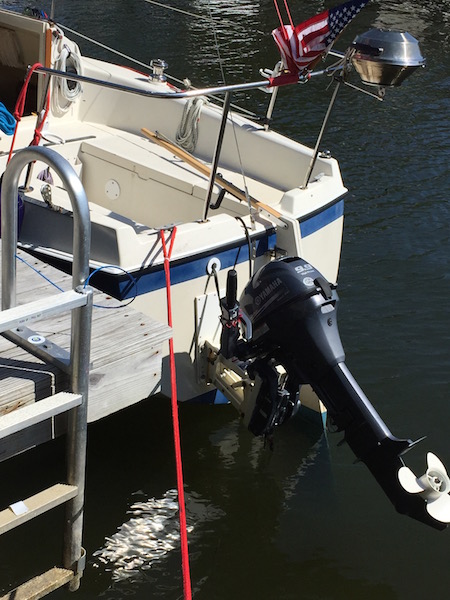

The outboard bracket was real hard to get down. It is original I believe. I finally got it down. It is real shakey. I just kept it slow as not to put much strain on it.
The motor is a tohatsu 9.8 four stroke. I really should have changed it on the hard. I didn't think it would be that wobbely...
How tough a job would it be to change it out for a bracket designed for 4 stroke. I'm sure the holes will not line up and I will need a new wedge. Oh yea. It's in the water also. I have no trailer. Can this be done in the water?

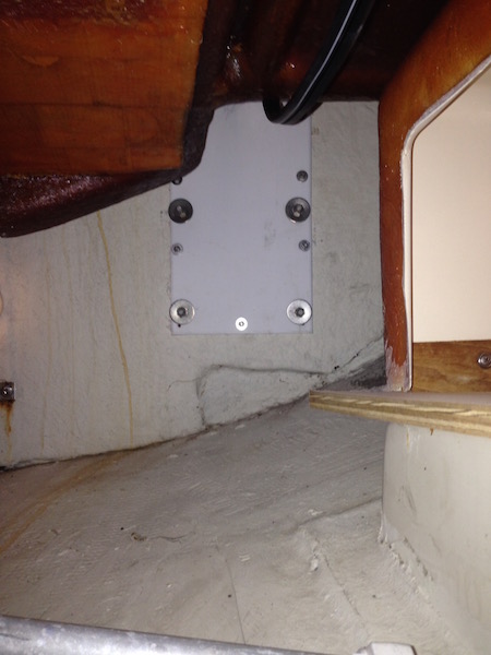

Got some measurements for you and took some pics.
My two backing plates are 17" x 8.5" and made of 1/2" starboard. The top of the external plate is 7.5" below the rub rail. The OB cowling is 12" from stern when tilted. The bracket OB plate is 18" from stern. Top of bracket plate is 18" above water line putting the bottom of the bracket plate about 5 or 6" above the water.
Read a thread once where someone stated starboard was too soft for a OB backing plate. Not sure how well the photos show it but the stern is curved slightly and the starboard mates to it well.
I'm guessing it comes up as high as it does to cover the blemish of removing the wedge.
Until I took these photos I didn't realize the angle the bracket mounting plate was at. My original 9.9 sat square so there was enough tilt on the OB itself to allow that much angle to be taken out. (New OB is power tilt).

I contacted Garhauer regarding their 4 stroke bracket. They said they make a 4 spring model for 4 stroke but do not carry it in their lineup. They said it can be purchased through Catalina Direct. If this helps finding the Garhauer Bracket.
I went with the Garelick because there was one on Craigslist for $100.00. I thought it was a good deal. I picked it up but have not installed it yet. I am thinking about the best way to install. As I said in a previous post. I think I will get a 3/4 aluminum plate and drill to so it mounts on the existing "old wedge" then mount the Garlic to the aluminum plate. I will also put a big piece of King Starboard behind the old wedge while I have the motor off the boat. I need to do this all while in the water. The only other option is to install the new bracket without the wedge. I don't know if I will have the proper angle as the new Garelick does not have the angle adjustment at the motor attach point. The mother has some angle adjustment. I think I will go with the Aluminum transfer plate for this year and build a new wedge next year on the hard.

I was just looking to put a bigger "backing" plate on the inside of the hull. Right now there are 4 little plywood backers or in a sense washers. I want a large solid piece vs 4 little pads.
The original wedge stays as is. Maybe Starboard is not the right material. Maybe for now a piece of plywood to spread the load.

I agree with Brian that it sounds like you have a good plan. All except one thing.
I do have starboard backing plates and they molded to the rounded transom well. If you were to use plywood it might also bend to mold to the curve but if it didn't the corners of the inner backing plate would put likely to dig into transom when you tighten the motor bracket bolts.
If you were using a rigid backing material you should slather on thickened epoxy to fill in any gaps.

The previous owner of mine mounted an outboard bracket that is wider than the wedge.00 07 20 09 012 crop.jpg
Not a great picture because it's cropped from a picture of the boat. Plus two of the mounting bolts are not installed.
