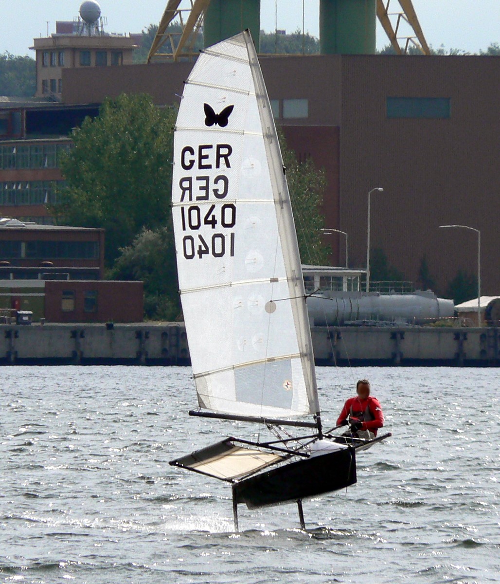

I think an experimental foil is called for here!
23,162
I had the same idea. A home made foil. Some how light weight yet strong enough to handle the forces. Maybe in the concept of a Moth boat. That may be a successful model that could give this inventor the idea.
