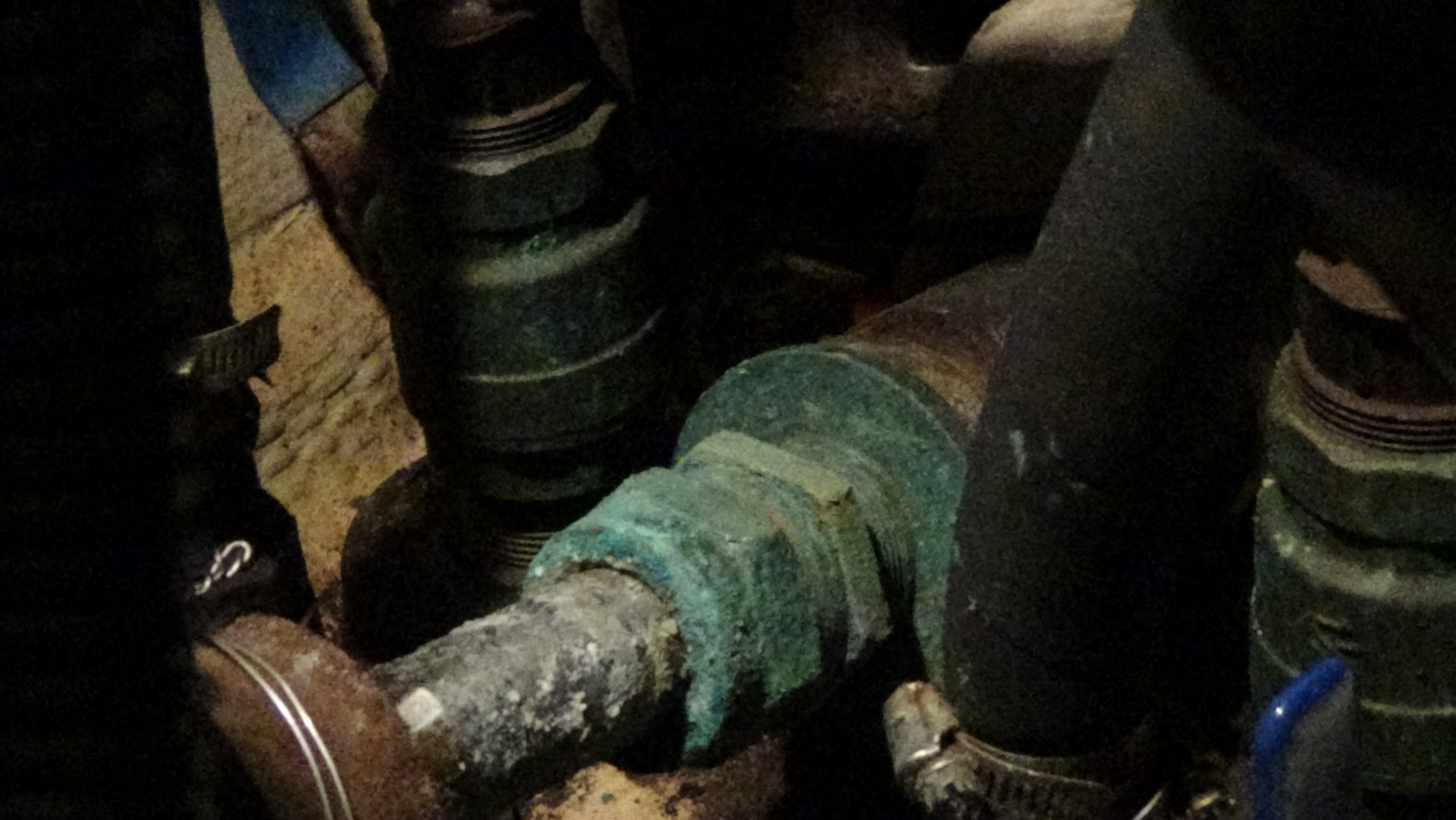

Made plans to head out for a weekend cruise. Weather forecast looked uncertain. Went to the boat Friday amidst a blow and it remained most of the night. Awoke to rain and more rain. Rained most of the day. Decided to not go out in this miserable weather. :(
Instead I spent over two hours finally, finally, finally getting the stuffing box adjusted. Grr. Last time out I could not get the locking nut to move; the box rotated, but I had to get the lock nut to loosen so that I could tighten the box. So soaked it in Liquid Wrench and left for another day. That day was Friday night. Bound and determined to make it happen. Tapped and more Liquid Wrench, then tapped again. Then alas a slight movement when I turned it counter clockwise. So, back and forth, back and forth until I was able to obtain a complete rotation. Now I have a no drip box again while the shaft is turning.
My question for the day is, what anti-seizing compound works for you? Our local Harbor Marine had several choices, but before I did, pose the question here for opinions.

Working on this creature is a PITA. Have to crawl in over the engine arms first, hang over the engine in order to reach in far enough to get the wrenches on. Even with wrench handle extenders could not get that nut to budge. But persistence prevailed.

I've not had to tackle it yet - but for that application I would look for a copper based anti-seize.
23,143
I have been using "Corrosion Block" comes in a spray and a lube gel.
My rigger likes Lanakote.
Almost bought the Lanakote paste version. Probably go that route. Corrosion Block was recommended by the store guy. Also looked like it might do the job.

I thought a stuffing box was supposed to drip with a turning shaft. It uses water as a lubricant. Or have I been wrong all these years?
May 20, 2016
3,015
It should drip 1-2 times per minute when running. It can be dripless when the shaft isn't turning
Dec 25, 2000
5,932
Hi Michael, perhaps others will weigh in here. I've read that it is not so much that water is the lubricate, but that water contains oxygen and that the absence of oxygen around SS induces a corrosive affect upon it. No metallurgist here, just passing along comments from those who claim to know...

We always set up pumps in the paper-mill to drip when running so I've always done my stuffing box the same way. I would have thought that the shaft would over-heat, maybe change the temper, if no drip. I always thought SS had to "breathe" as well but I noticed this week that some boats were painting their shafts with anti-fouling paint. Maybe some new alloy?

I always let em drip about one drip every 30 sec. see how warm it gets under cruising load (by feel). Should not be much warmer than static. Permatex makes a nice copper antiseize. I use it on my injector bodies

Hi Michael, perhaps a concern appropriate with the plain flax packing, but the new PTFE stuff with teflon acts as a very low friction material. Even with no drip while the shaft spins, box is cool to the touch.

Thanks Terry, that's good to know. Not sure about a dripless or a repack this fall.
