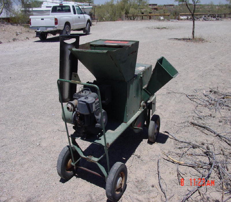

Yes. Luck is the word. Here's the engine I'm dealing with this morning, but it's a simple problem with the pawls on the pull start mechanism.
I'm very lucky, too.
