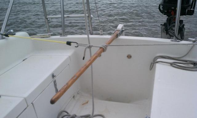

On my boat I took a piece of line and secured it to my vertical pushpit rail. I made it long enough to go about 3/4 of the way across the cockpit and tied a bowline in the free end. I center the tiller and wrap the line around 3 times, then secure it with a bungee hooked into the bowline and then to my pushpit. Works great and it's nice and cheap :) I leave the line connected all the time and just stow the bungee. Makes a good impromptu tiller tamer as well.
Close up
Bungee secured

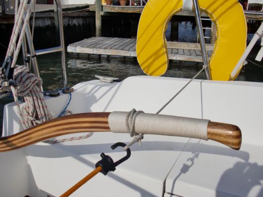

I tie my tiller off very similar to Captnkev25, only I use two 5/16" braid ropes with a Bowline tied on one end of each rope. I run the loops of each of the two ropes under the stern cleats and over the horns, center the tiller, and tie clove hitches around the tiller and half hitches to lock it in.
I have a piece of leather sewn around the tiller as a chafe guard to protect the wood from the ropes. Also, there is a metal peg in my tiller for my autopilot and the ropes are tied in front of this peg to prevent slippage. I have a tip up rudder and I always leave my blade in the tipped up position when my boat is moored.

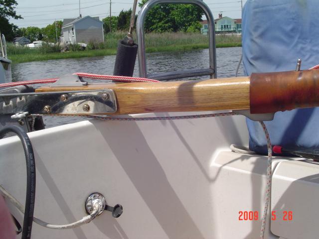

I use a line going from one rear cleat, through a Victory tiller clamp to the other cleat.
Works like a dream for locking the tiller while single handing and locking the tiller at the dock.
I used to have a Tiller Tamer but the Victory is so much better (cam operated and all stainless steel), no constant twisting and screwing, just flip it down and it locks.
