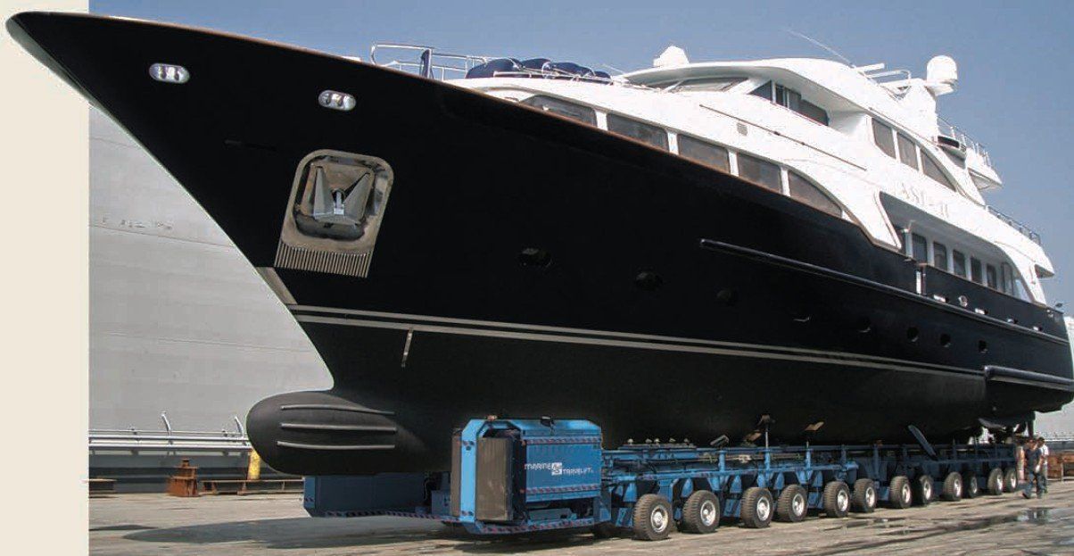

Here's a pretty large yacht on a trailer:
While she IS a large yacht on a trailer, I suspect she actually takes a locamotive to pull her. That alone would limit where you can launch her.
Thankfully, sea level is all down hill from most places.
-Will (Dragonfly)

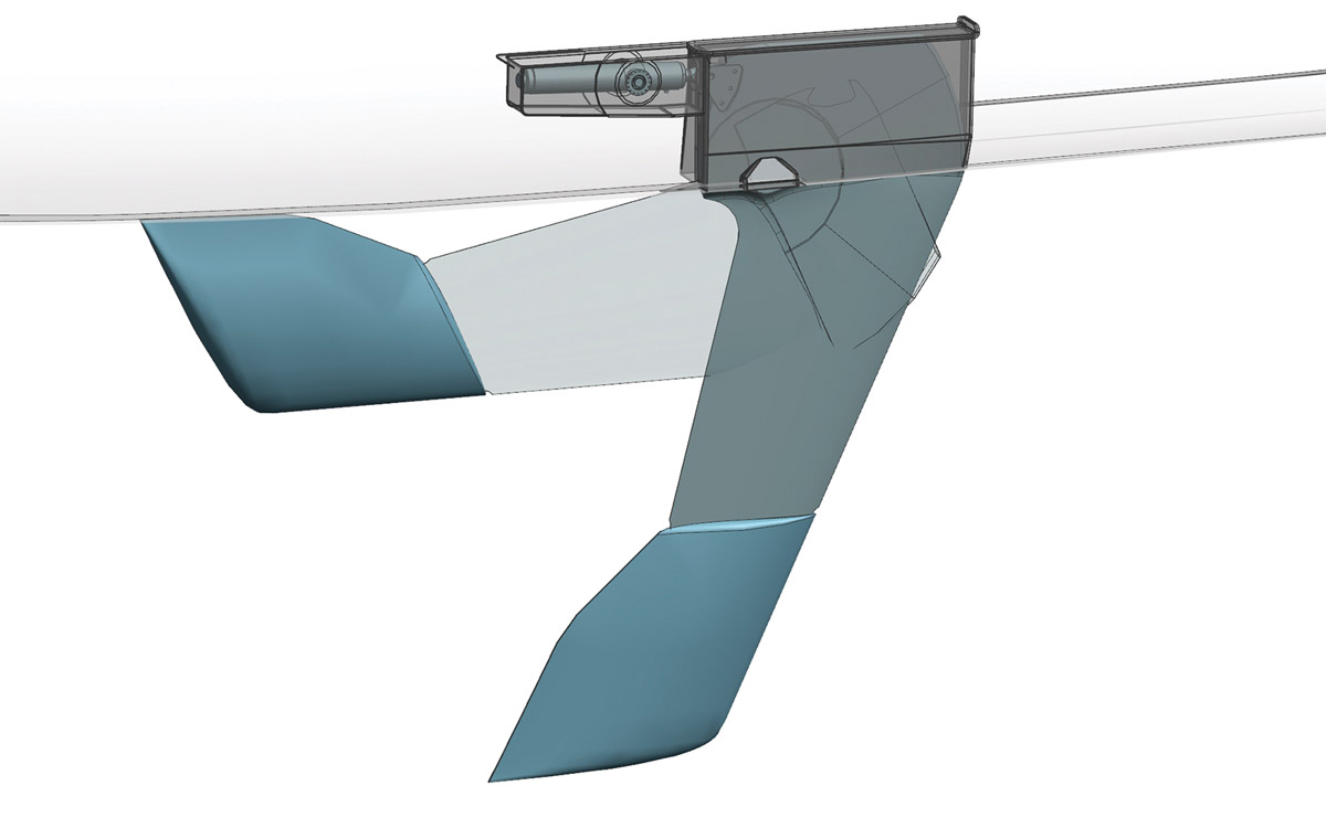

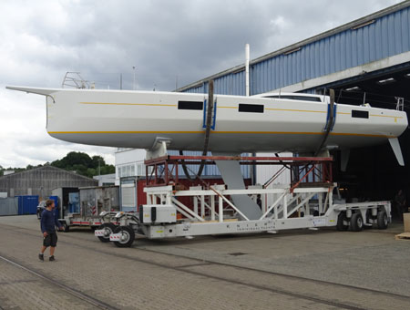

This is really question of engineering, design, and construction. It is not as straightforward as your comment suggests. The typical boats with swing keels that are mentioned here on SBO were 'designed' 40+ years ago and constructed using simple techniques to secure and manage the lifting. Often with lines attached to trailer winches. This lack of sophistication combined with 40+ year of questionable maintenance makes these boats less reliable.
Modern lifting (AKA swing) keel boats built by progressing builder are a totally different deal. Here is a US$2M Conq-Finot FC53, with a hydraulically lifting keel that weights 3 tons. It's an engineering marvel, and designed to sail around the world. There are currently a dozen or so builders using this design; Beneteau, Structures/Pogo, FC, CMB, etc.
Detail of the keel structure. Depending on the build, the keel slap is eliminated but the use of delrin 'pucks' that friction-fit between the keel and the box when retracted. The FC53 uses a different technique, the manufacturing tolerances are so high that the keel fits into the box with a tolerance so tight that bottom paint cannot be used on the potion that goes into the box!
