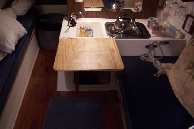

I recently installed 3/4 inch ash hardwood in my M.(I put both hardwood and laminate down for a living). You can get either a box of hardwood or laminate for under $20 from almost any hardware store if you ask for discontinued or mismatched. You can still float the floor but I just put the no slip stuff under it. As for the hardwood buy a box and a tube of subfloor glue glue the T&G together so they'll cover the sq footage. When set run entire thing over a dado or router to make a couple channels in them then glue in some slats perpendicular to the way you've laid your floor. Let that set then cut out your floor template. As for the drop cut a piece of wood round for nosing stain glue and brad nail on. Done for under $50 a couple of hours. Don't use the carpet for your template though. It will fit but not well (i did this cause the whole thing only took me and hour not including watching the glue dry). As for the laminate for twenty bucks if you get two seasons out of it I'd say it's worth it, but it will get ruined.

Thanks for the mine of info. Mike the photo of your floor appeals to me. Y/Bob wish you were closer to the Ok BC I could steal some of your trade secrets to make it look professional. Having a refit Mac means learning a lot of other trades. I think the carpet idea (a runner from Walmart) may have to do till I get time for a more permanent fix. I hadn't thought of using none slip under lay. Today I finished removing the carpet from our travel trailer and used up the left over laminate from the home fix. The manufacturer installed the carpet before the walls were erected on top of it, interesting, lots of swearing involved. Not unlike cussing POs alterations.

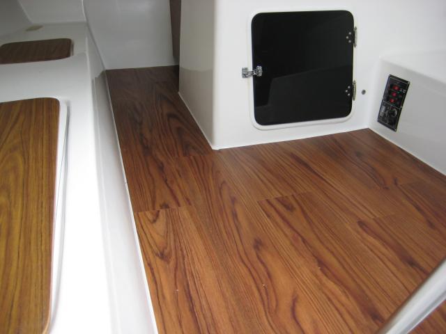

I just put in a vinyl floor on my Macgregor 26s. Bought the vinyl laminate from Home Depot like the link above, Teak finish. Thought vinyl would be better than carpet, but will put down a small rug at the bottom of the stairs. It looks good and doesn't slip around, as I put it as close to the walls as possible, but did not use an underlay, thought it would dry faster without. Didn't finish the edges, they are just cut per directions. Vacuums or sweeps up nicely. Can just pick it up if need be. It looks good, was cheap, and my first mod., so am not too worried about it.

Oh, and just a tip if anyone plans on doing the vinyl laminate floor planks: try not to make any horizontal cuts alongside the long edge. If the wall is not perfectly straight just leave it. I cut one board at a slight angle to fit the wall and it messed up all the rest of the boards attached to it. Also, make sure you use the adhesive end for every cut, and it has to be butted to an end that has the adhesive removed. You may waste wood, but the floor will have an uneven top if you don't join the edges together properly. Hard to explain, but once you try it you will know what I mean. One box will do an entire floor, so don't try to skimp.

I must go and look at the Vinyl type. The floor you have is the look I would like in my 26D. Don't quite understand the adhesive ends. The type I've used in my home has the same locking attachment on the ends as the long sides. Re underlay I think I will use the non slip material used on trays, cupboards, under throw carpets and counter tops, similar to what beamreach did.
