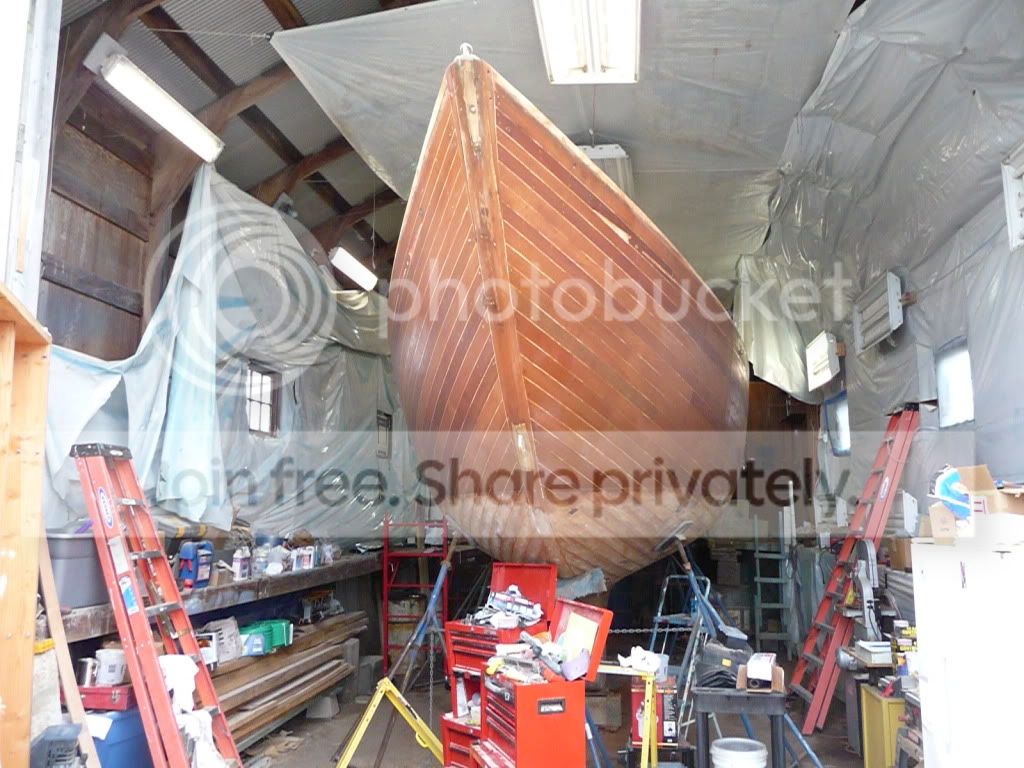

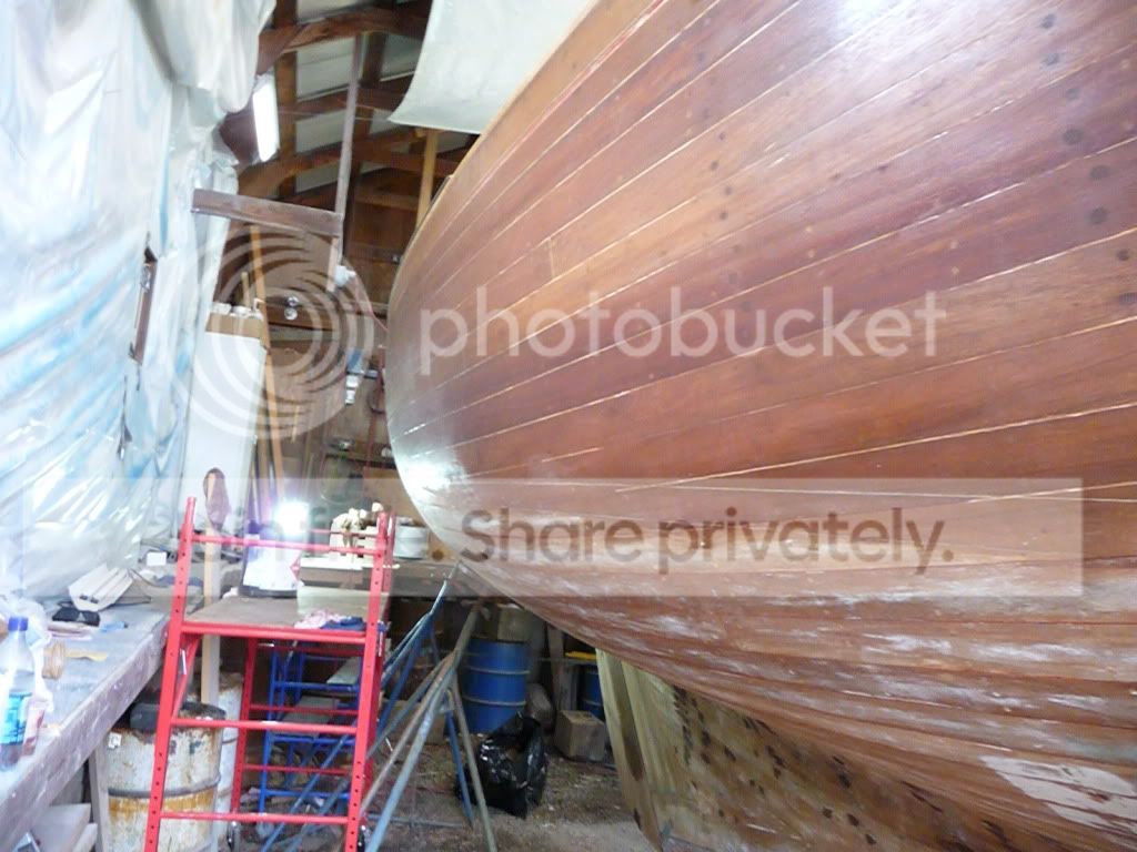

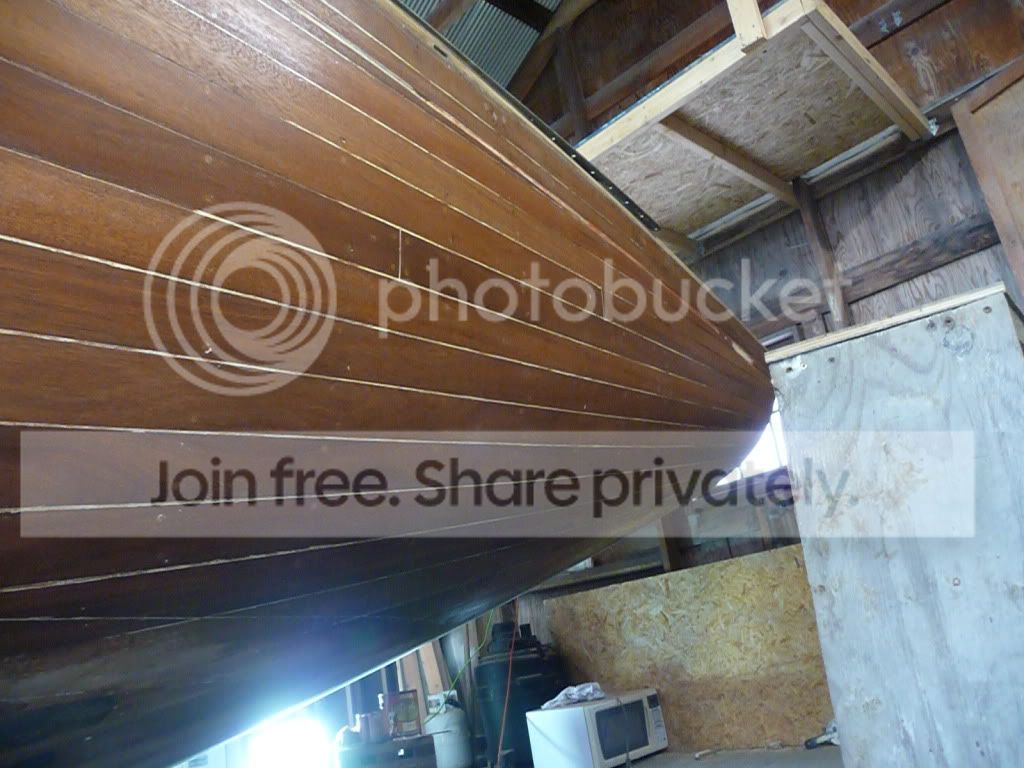

A very busy week at the yard. Lady J's hull is pretty much ready for wet in, even if it rains. The stain is done and there's a coat of CPES over it to keep rain from leaching out and streaking it. After she's wet in, we'll apply 12 coats of varnish over it, above the waterline.
Here are a couple of shots:
Bow
Port quarter
Starboard

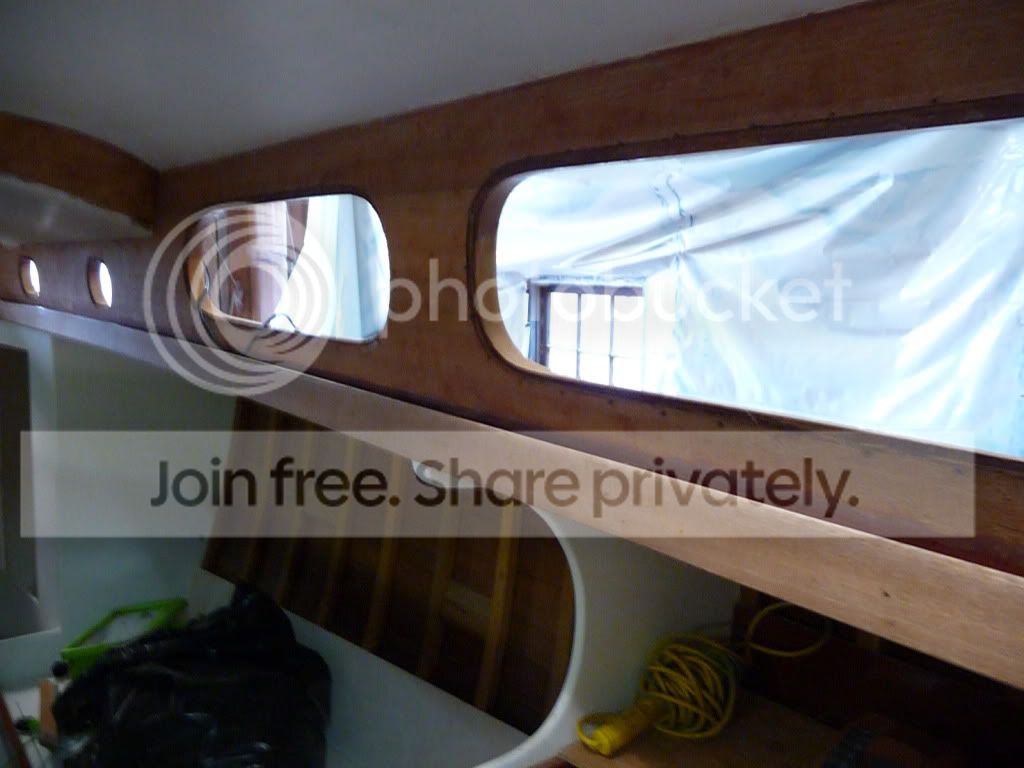

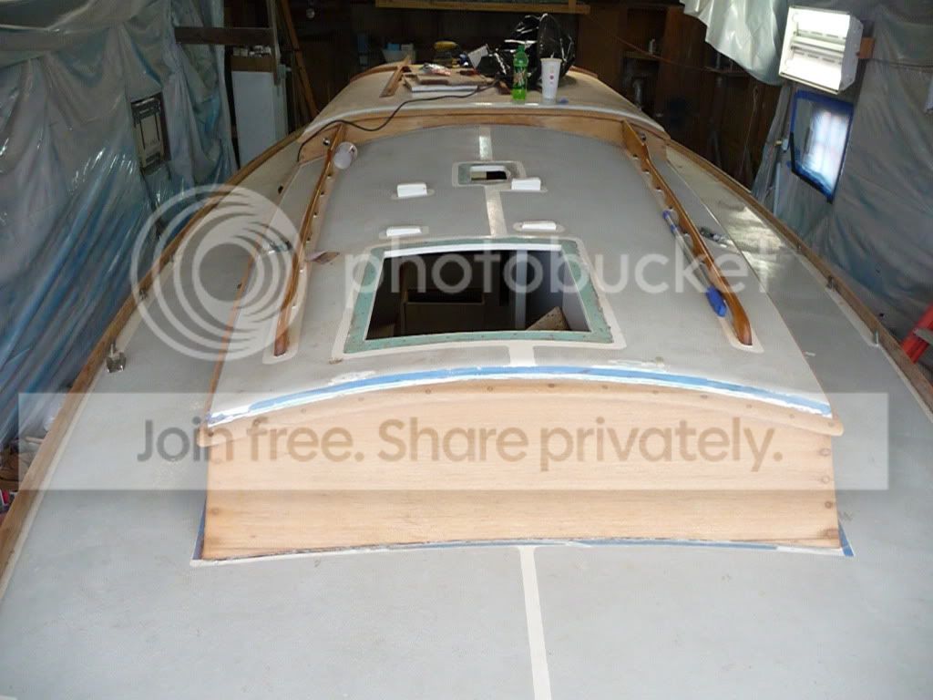

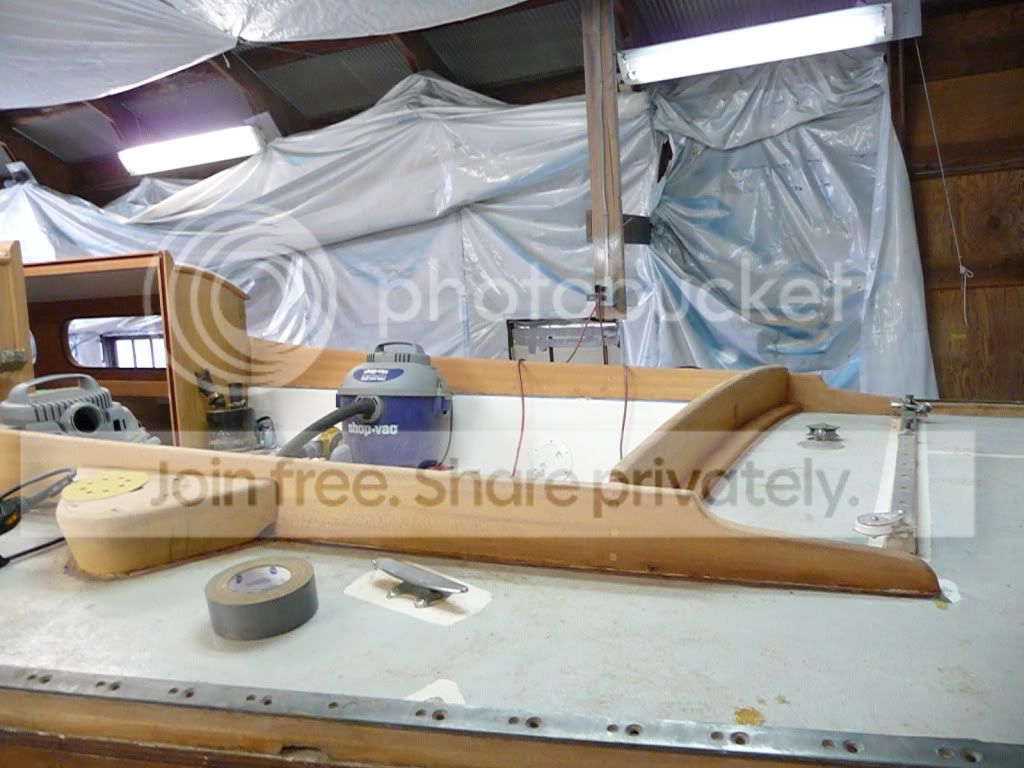

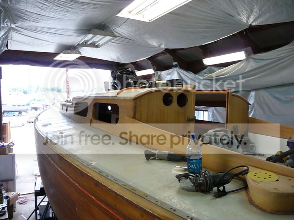

The boys have been busy with the house. It will be done natural with varnish.
Cockpit
House aft
Forward

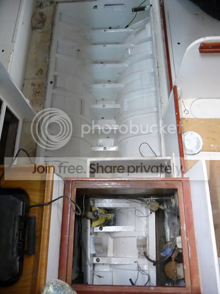

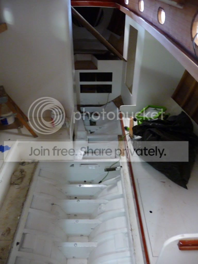

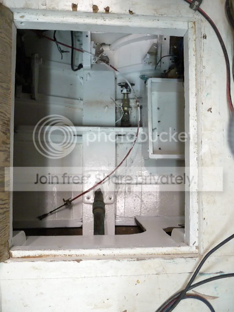

We've also been working inside and in the bilge, detailing it out.
Forward
Center
Aft under the cockpit (there's a bit of cleanup and detail there yet to do since Twan got a bit carried away with the paint....
