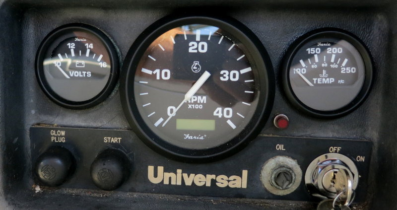

This is simple:
#1 Ascertain the sending unit threads usually 1/8" NPT or 1/4" NPT on Universals
#2 Buy a 33-240 Ohm sending unit with the right threads.
#3 Buy a 33-240 Ohm gauge
#4 Install both
#5 Done......
Both together with cost you less than just the sender from Universal, $37.98 for the gauge and sender to be exact.......
1/8" Faria Temp Sender $12.99
1/4" Faria Temp Sender $12.99
Faria Temp Gauge $24.99
Heck you could probably replace all your gauges with Faria for less than Universal wants for just the sender... I do it all the time....

Maine, do you have part numbers for a tach that would work with my Catalina 30 Mk 1, Universal diesel M25-XPB that is non-mechanical? I'd rather the electronic one to simplify installation. I think I'll replace all my instruments and make a panel that is high on the combing, rather than down on the floor of the cockpit.
And I think you're right (as usual) I should have gone this route from the start because the sender I got from Kubota only works with one of their temp gauges... an additional $40 bucks...oh well, live and learn. Still far cheaper than a sender from Universal.
