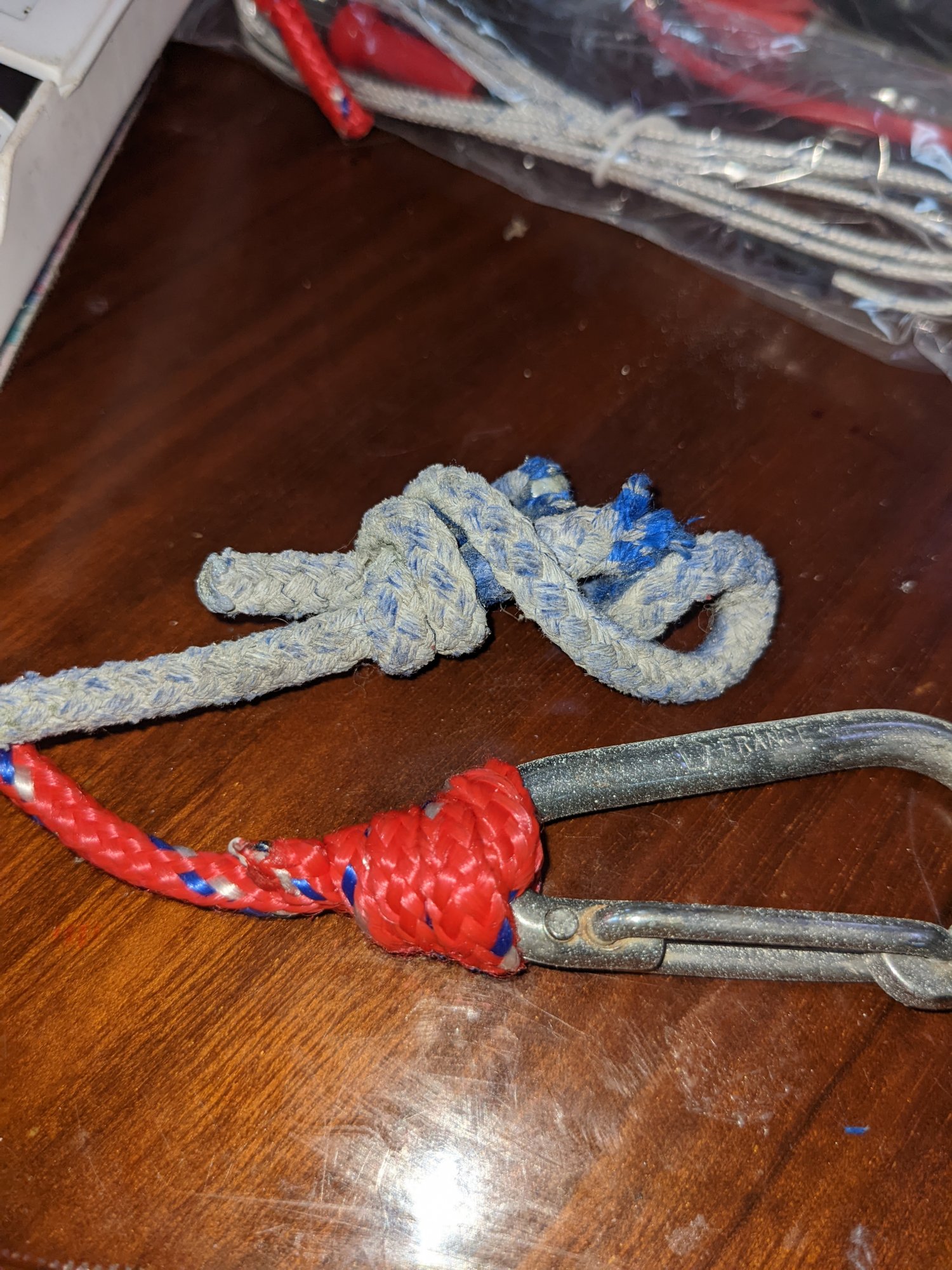

anyone know what this knot is? they are used on clasps on my Beneteau.

this app sucks. I had a photo attached, now lost. I tried my best to reproduce, but I think I need stiffer line.

I call it the modified halyard knot. I tie a regular halyard knot, and then tuck the free end under the last loop. Basically the same idea as the cinch knot and modified cinch knot popular with fishing people. Very similar to that poachers knot.
