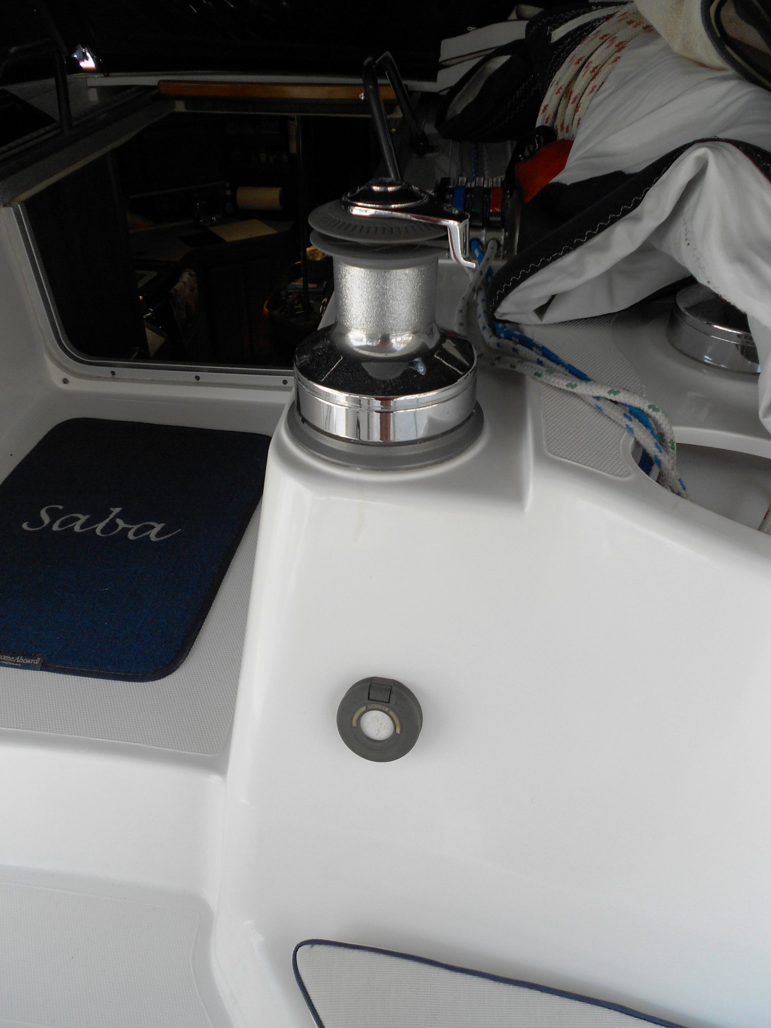

Mine has a safety cover and a long way from the Winch.
Jim...

This is a production boat. (boat show)
The switch is pretty damn close. What if someone is sitting next to the winch and leans/falls? And what do you think of the drink holder location?
I think it's Great ! Now you can really get liquored up before using the winch.
Why the hell anyone would want to encourage drinking so close to a piece of dangerous equipment (open pinch points galore) staggers the imagination.
