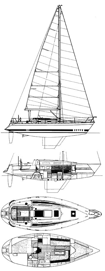

Lost the rudder on my Elite 324 - desperately seeking rudder dimensions to have a new one built.
10,221
If worse comes to worse, these are scale drawings of the boat. They are un-dimensioned, but if you have a known dimension, then you can figure out the length and width and shape of everything on the rudder except the airfoil cross section

I've got those plan drawings, that's why I was asking for dimensions from current Elite 324 owners if possible. The "about right" dimensions that I have based on the found plan drawings are moving us ahead with the rudder folks, so that's good. Thankfully we've found the angles for the rudder top to hull for fit, etc.
