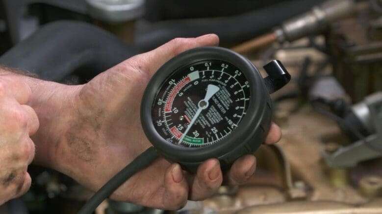

A vacuum leak is excess air getting into carb/intake. All combuston air should come through the throat of the carburetor - the path from the throat to the intake valves in the cylinders should be air-tight. Look closely at any rubber hoses that attach to the carburetor (not fuel lines) for leaks. Make sure the carb and everything else in the path is tightly bolted down and any gaskets are in good shape. Get a vacuum gauge (they're cheap) and test it, this page shows how to diagnose problems:

More good suggestions. The vacuum test article is terrific. I didn’t realize how much diagnostics you could do from a vacuum test!
