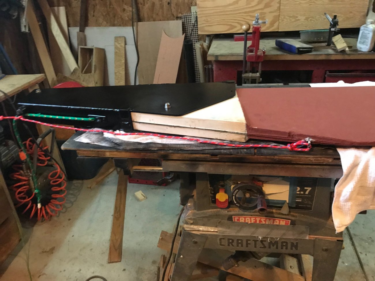

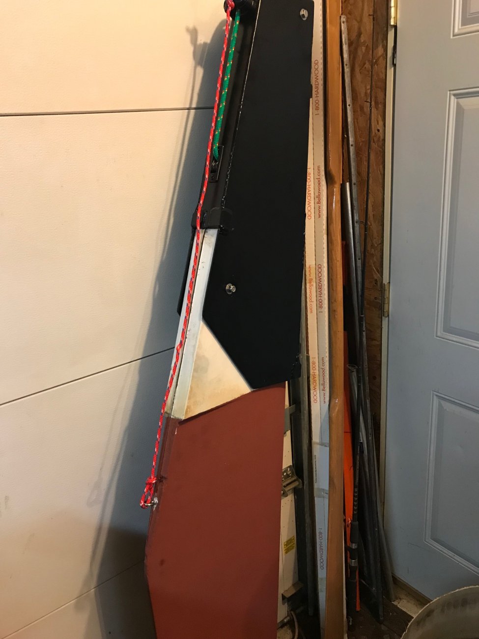

Well, since I started this thread, I should show everyone what I decided to do. I liked the idea advanced by JustSomeGuy but really didn't want to drill a hole through my rudder. The picture will show what I did. I drilled a small hole about 1/3 the way down the rudder from the pivot point and then glassed in an eye bolt. The line from the eye bolt will be secured to the upper transom when the boat is hauled or launched.

The H23 rudder (at least mine) floats. If you uncleat the downhaul line it floats up to the horizontal position, sticking more or less straight back. That doesn't help when you pull it out with the trailer, of course. I don't think a spring to pull it would add much value. You don't want to leave it hanging that way as any wave action onto the transom will whack the rudder back and forth with some force. I leave mine all the way down in the slip and secure the tiller with a pair of 24 in shock cords. In fact, I'm not sure how high and how much out of the water you can even get the rudder due to the metal housing. Of course, use of the red lifting line should work to hold it up while hauling thetboat out of the water.

Please hold off from using that. After the holidays I will address this. That eyebolt is between the two of the seams of the rudder and the pressure from lifting will split it wide open.
Send me a private message in two weeks and I will talk to the manufacturer but hopefully others will chime in what they have in the meantime. I will report back to the forum

I really doubt it as the eye bolt is glassed in. Beside that the lifting pressure and the total weight of rudder is not that much. In addition the time that the rudder is up during launch and retrieval might be 15 mins. I just did not want to risk hitting concrete on a ramp.
