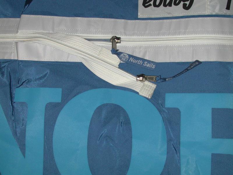

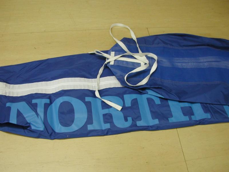

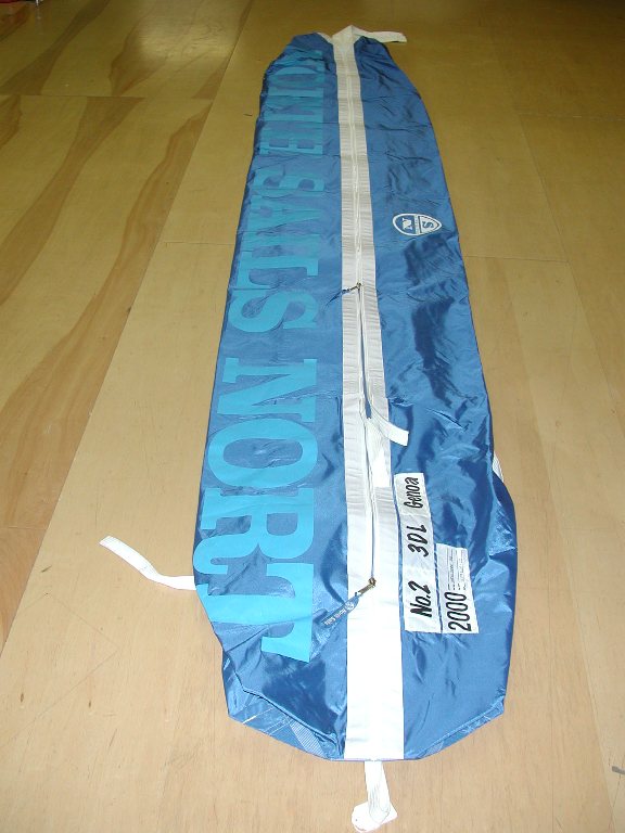

You might consider using a "sausage" bag.... this would be a J length genoa storage bag with a full length break away nylon zippers.... These bags are very popular among racers and are often included by the sailmaker with their premium sails.
Here's an example:
http://shop.nwcanvas.com/product.sc?productId=131&categoryId=3
