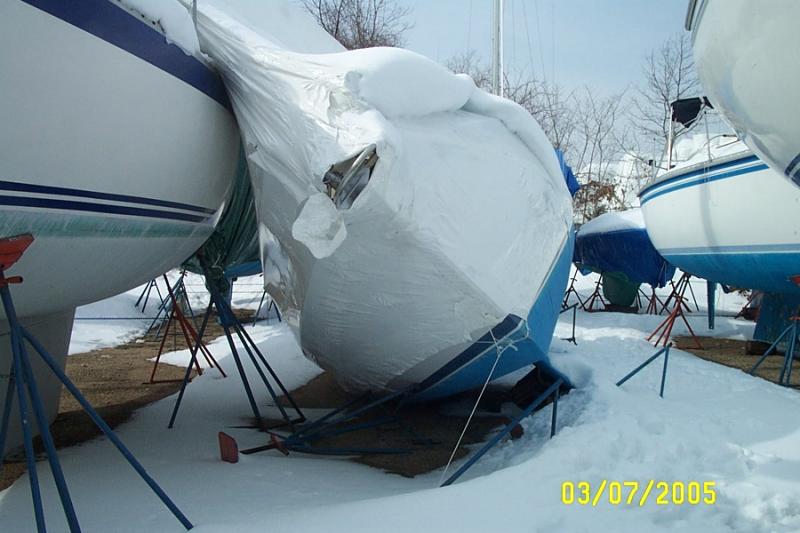

On the 23 you could unstep the mast yourself and if you use it as the ridge pole of the cover, it won't cost anything (on larger boats the price to have the yard unstep and store the mast, then re-step in the Spring is a consideration, but still A LOT less than repairing damage caused by a mast left stepped for the Winter!) Boats left with the mast up are also far more likely to be blown over by a winter storm, resulting in very expensive damage to your boat as well as surrounding boats (less of a problem if boat is on a proper cradle, like the original shipping cradle. However, not many yard still use cradles. Brownell Stands are more efficient and easier to store.)
Some boatyards actually REQUIRE that ALL masts be unstepped, I really don't understand why that is not the case at ALL boatyards given the potential damage caused by even one boat boat being blown over in a storm. Eve nif boatyards don't require unstepping masts, I would think Insurance companies would certainly require it to avoid having to pay for the damage caused by leaving the rig up compared to unstepping it. Our late friend Joe had his insurance company try to declare his at the time fairly new 222 a total loss after his mast came down due to a failed chainplate (this even though he always unstepped the mast for the Winter). The same thing happned to a friend of mine when the mast on his 42' trimaran failed and went over the side. As I say, it blows my mind that insurance companies don't require unstepping the mast while hauled out.
