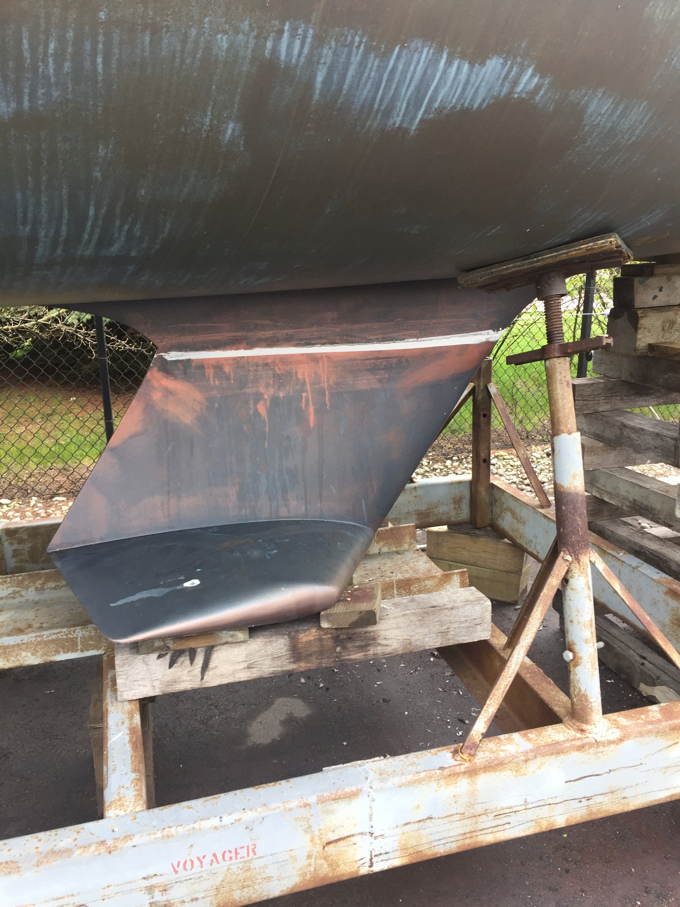

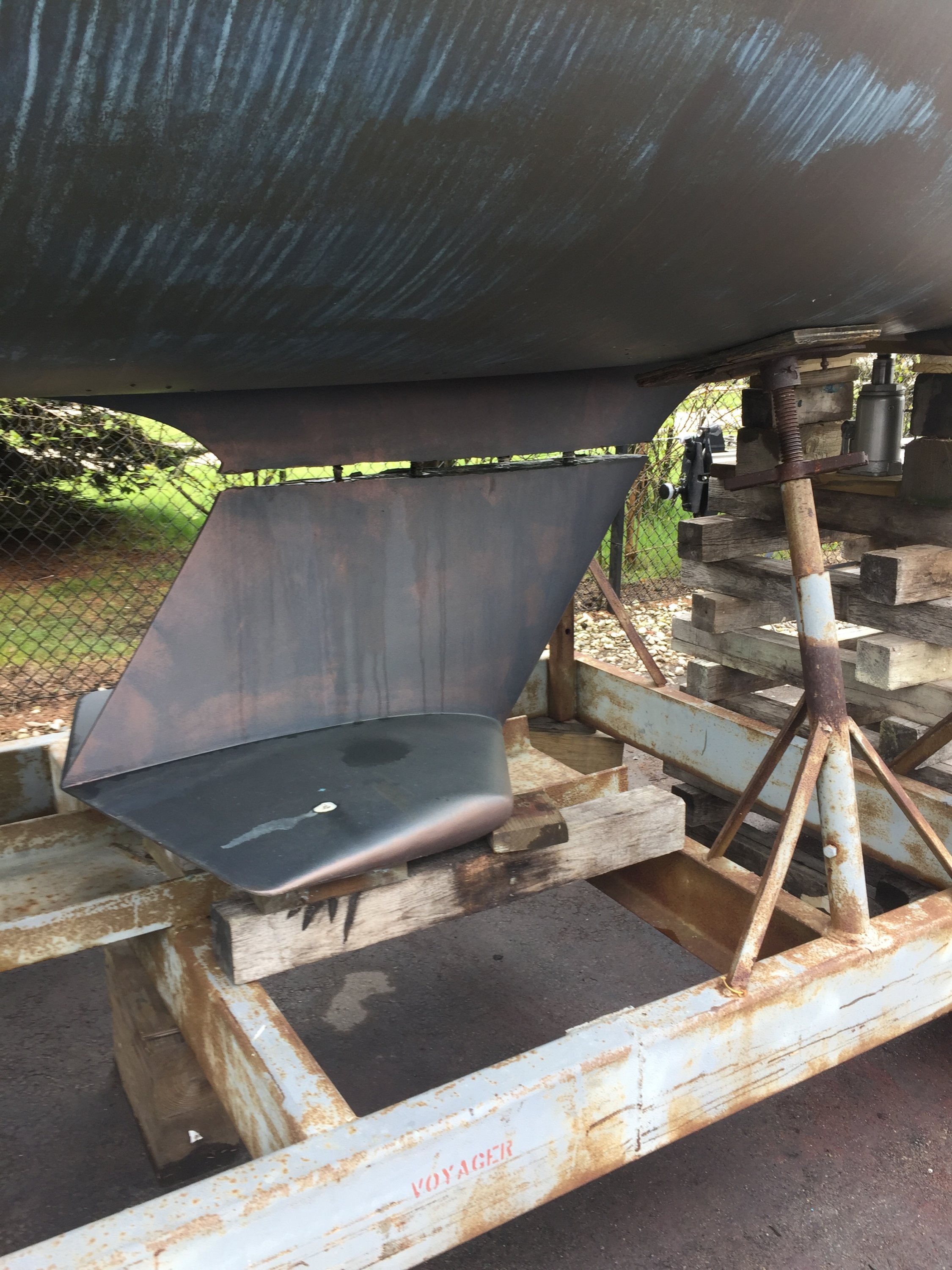

Nice job! I agree with the use of 5200, and you will be able to cut through it and cut it out if you ever need. I have removed plenty of 5200 with my Dremel oscillating tool.
