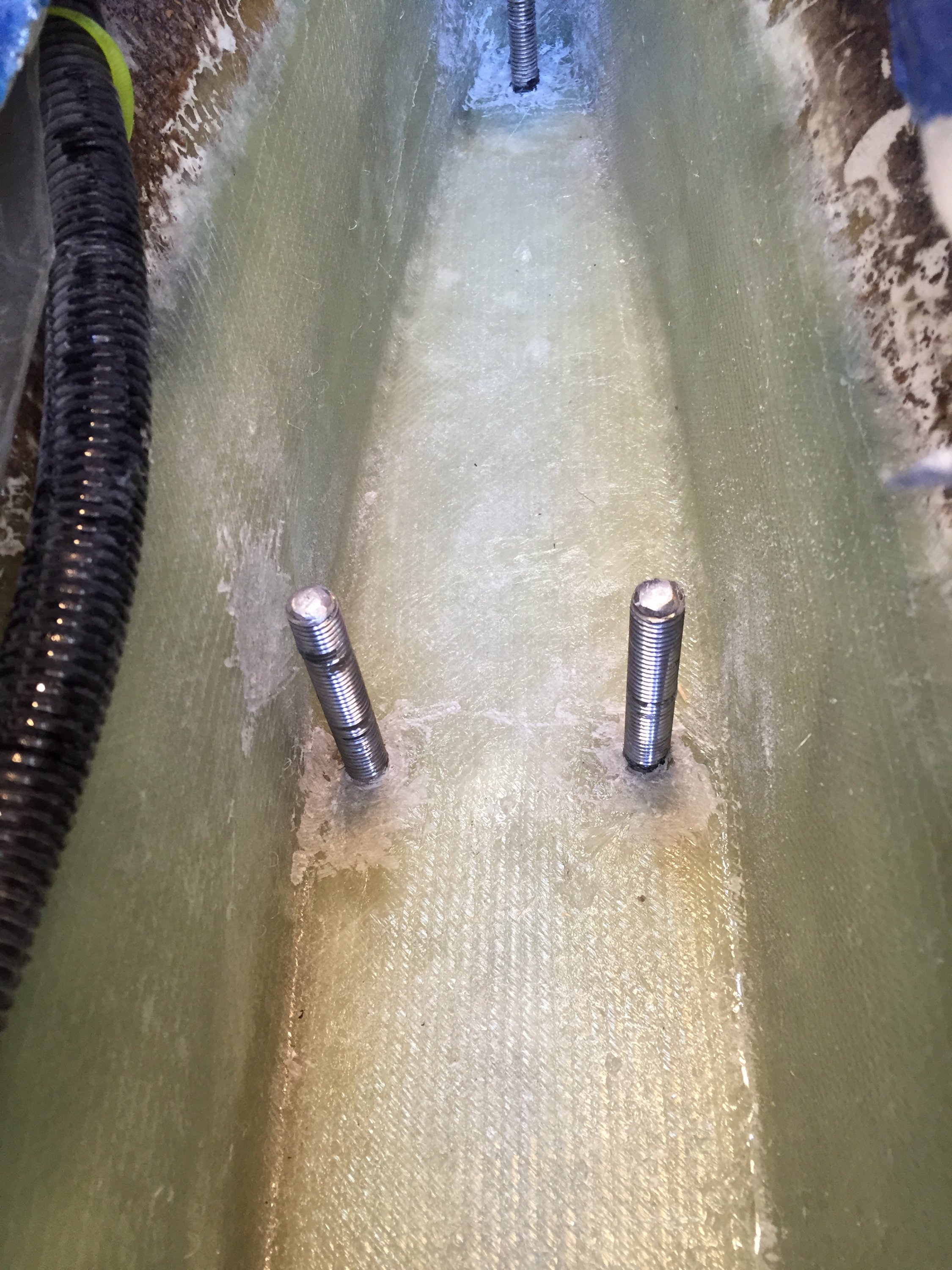

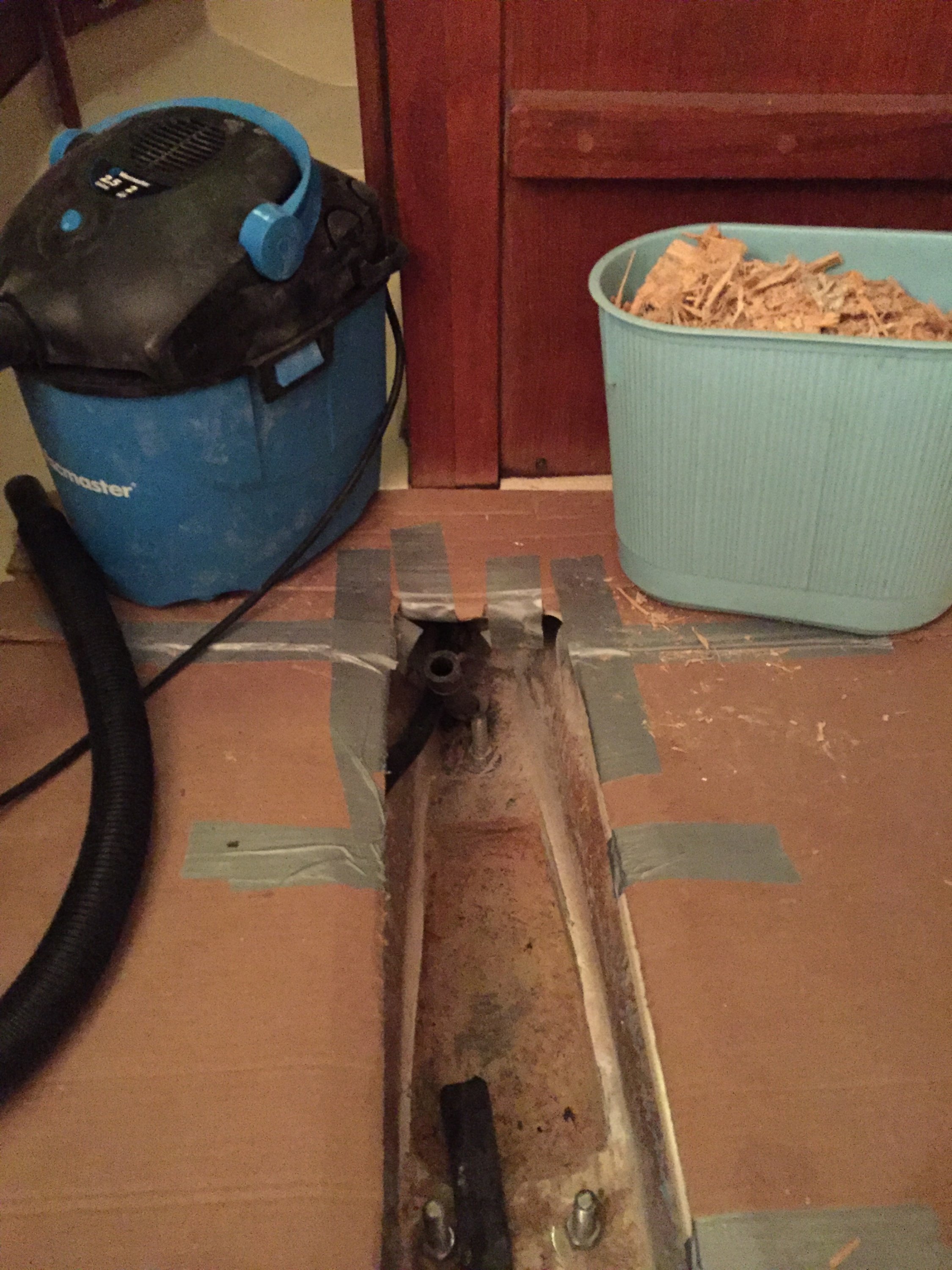

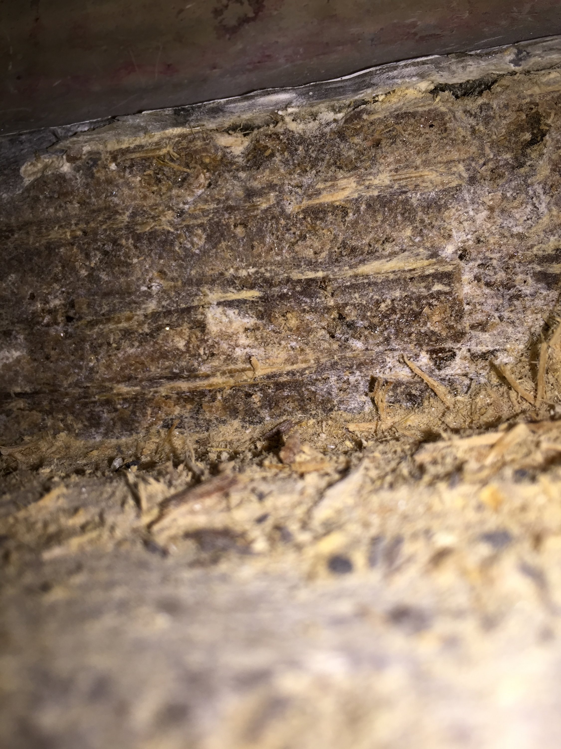

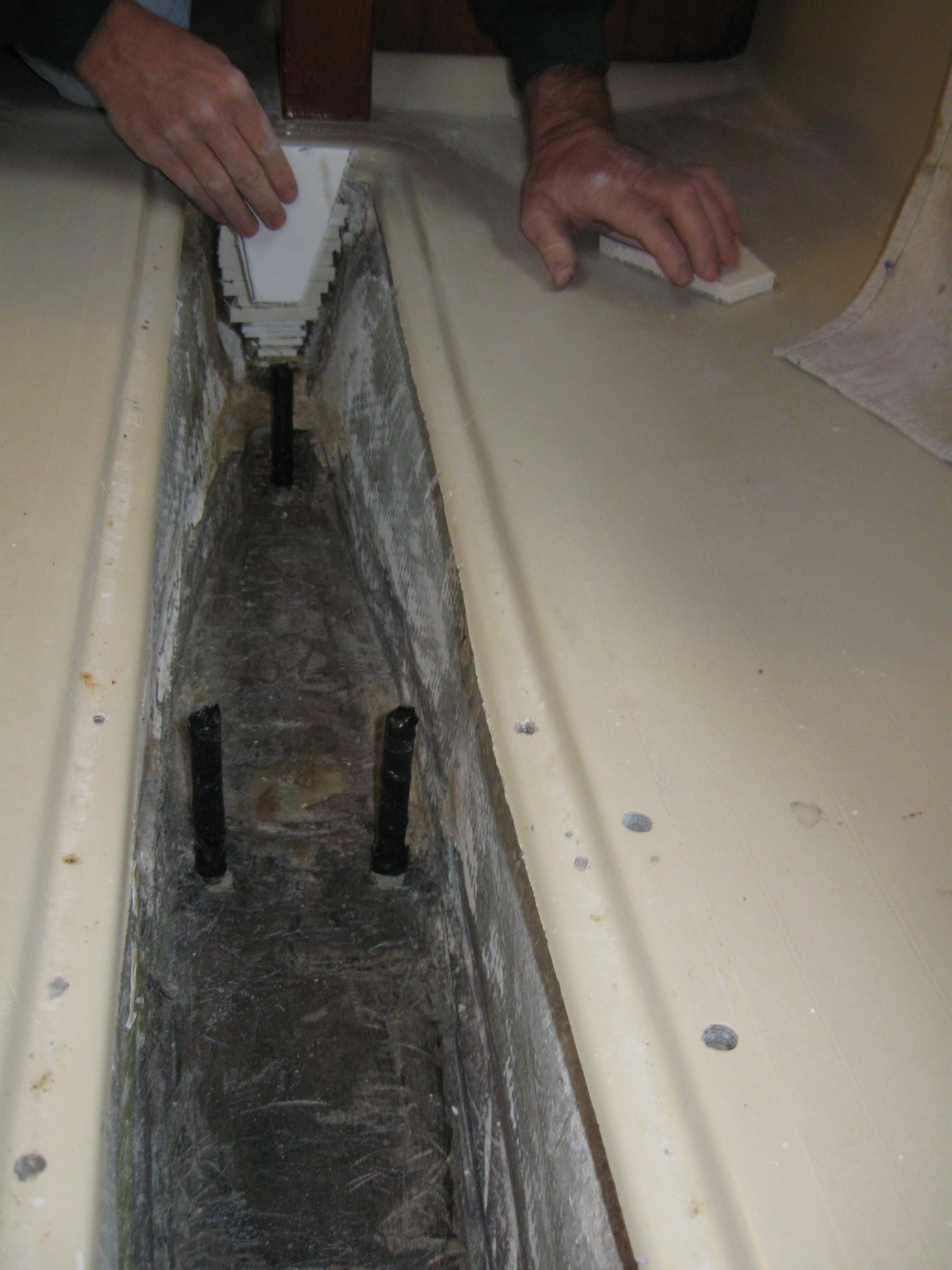

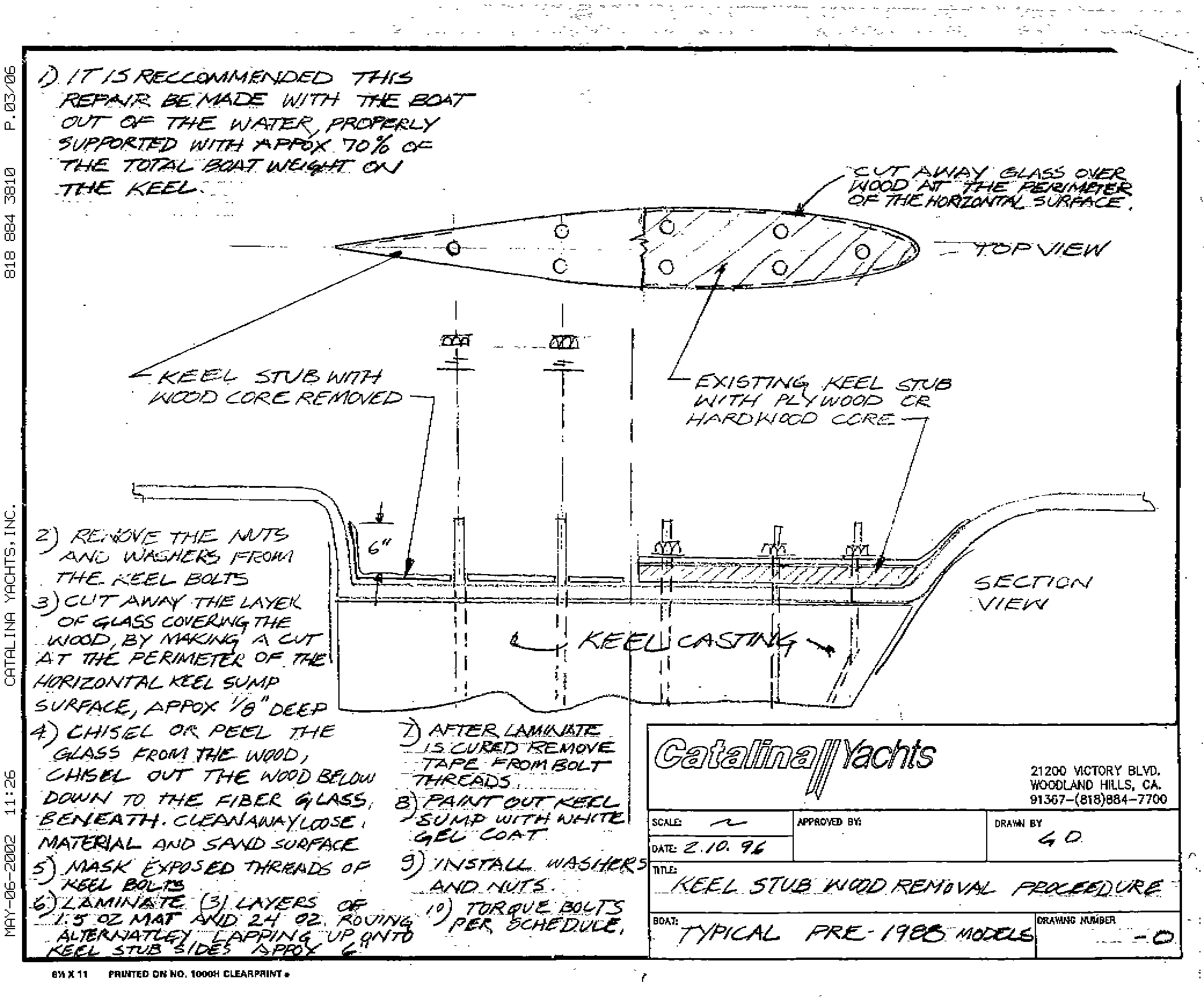

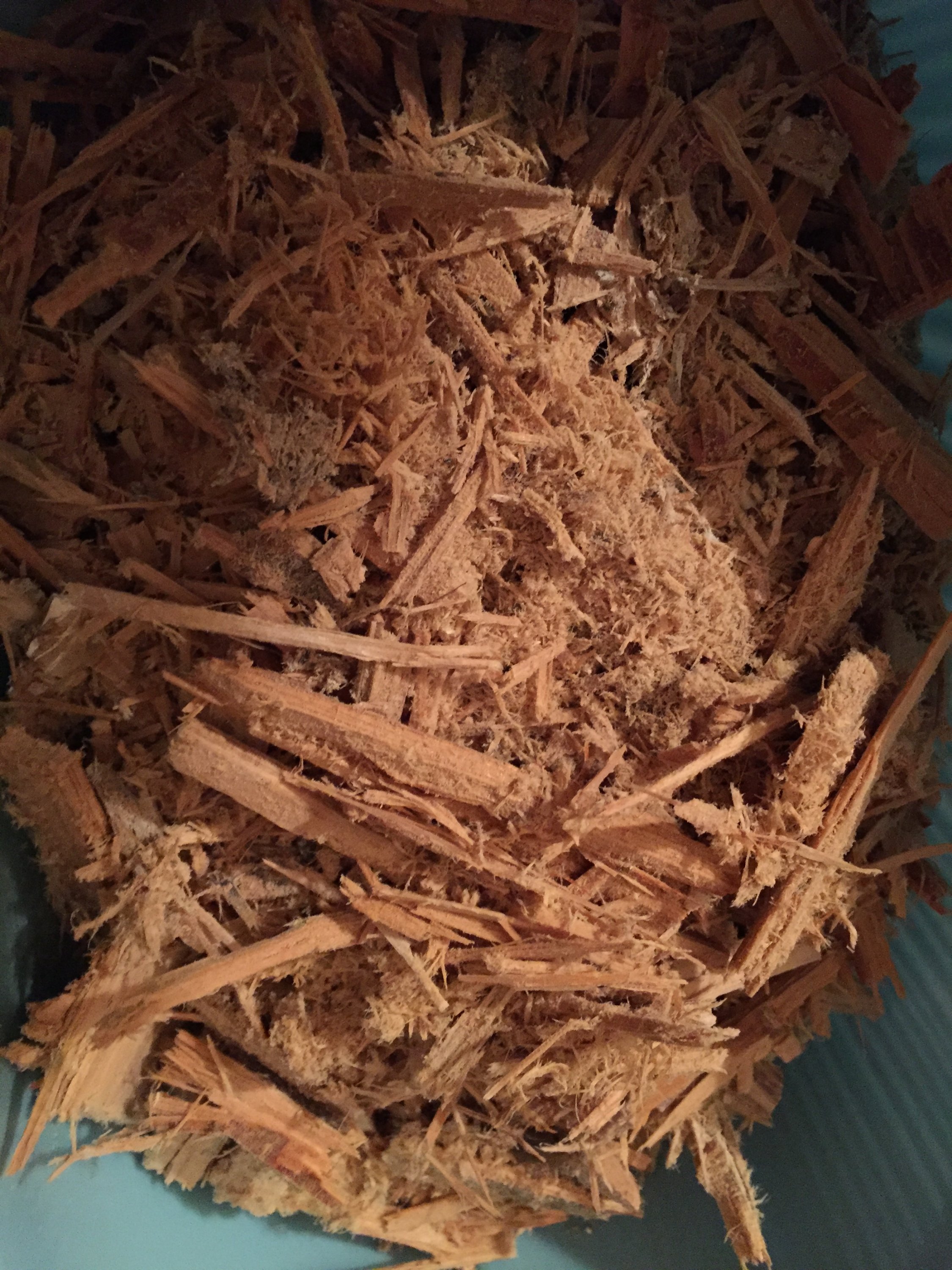

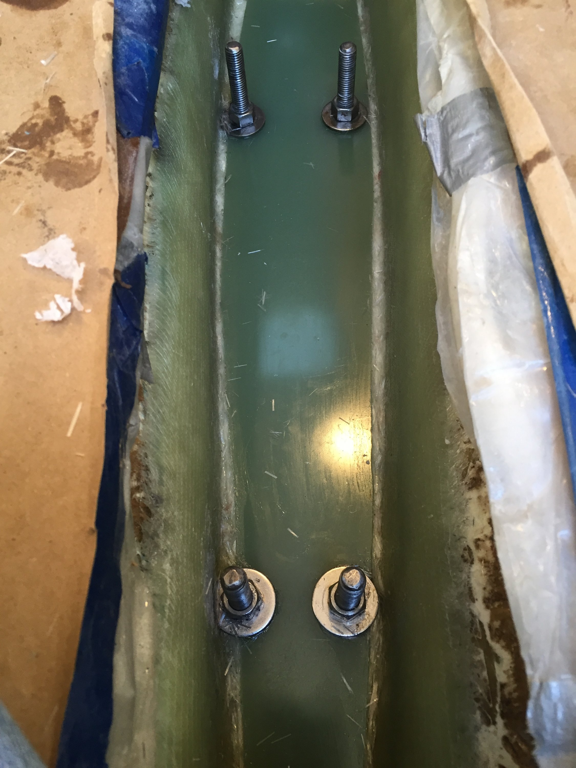

Hi,

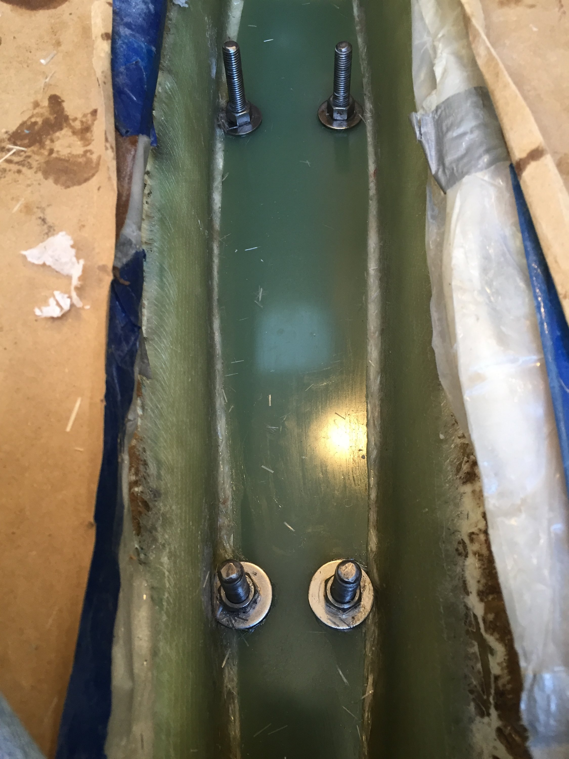

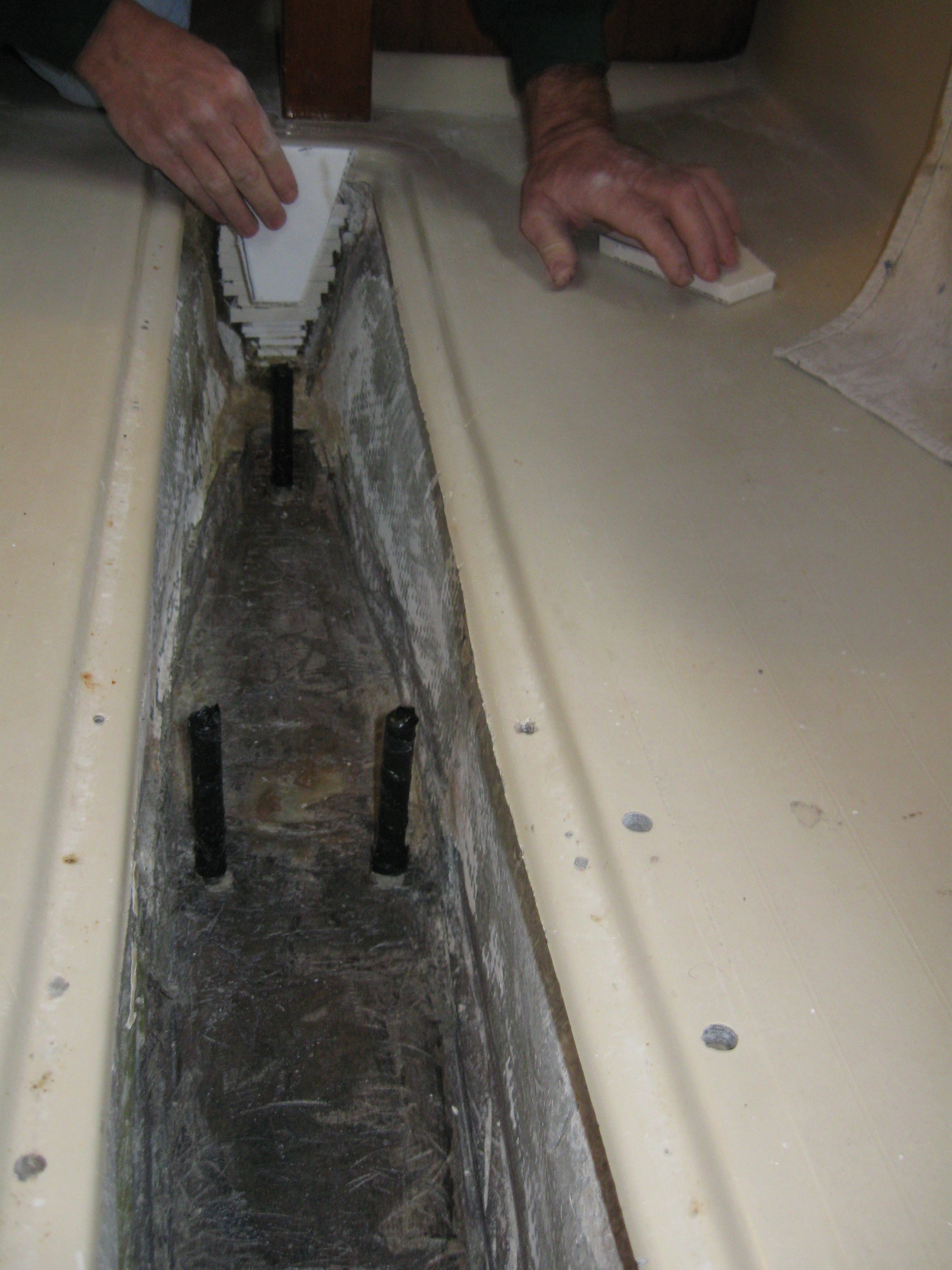

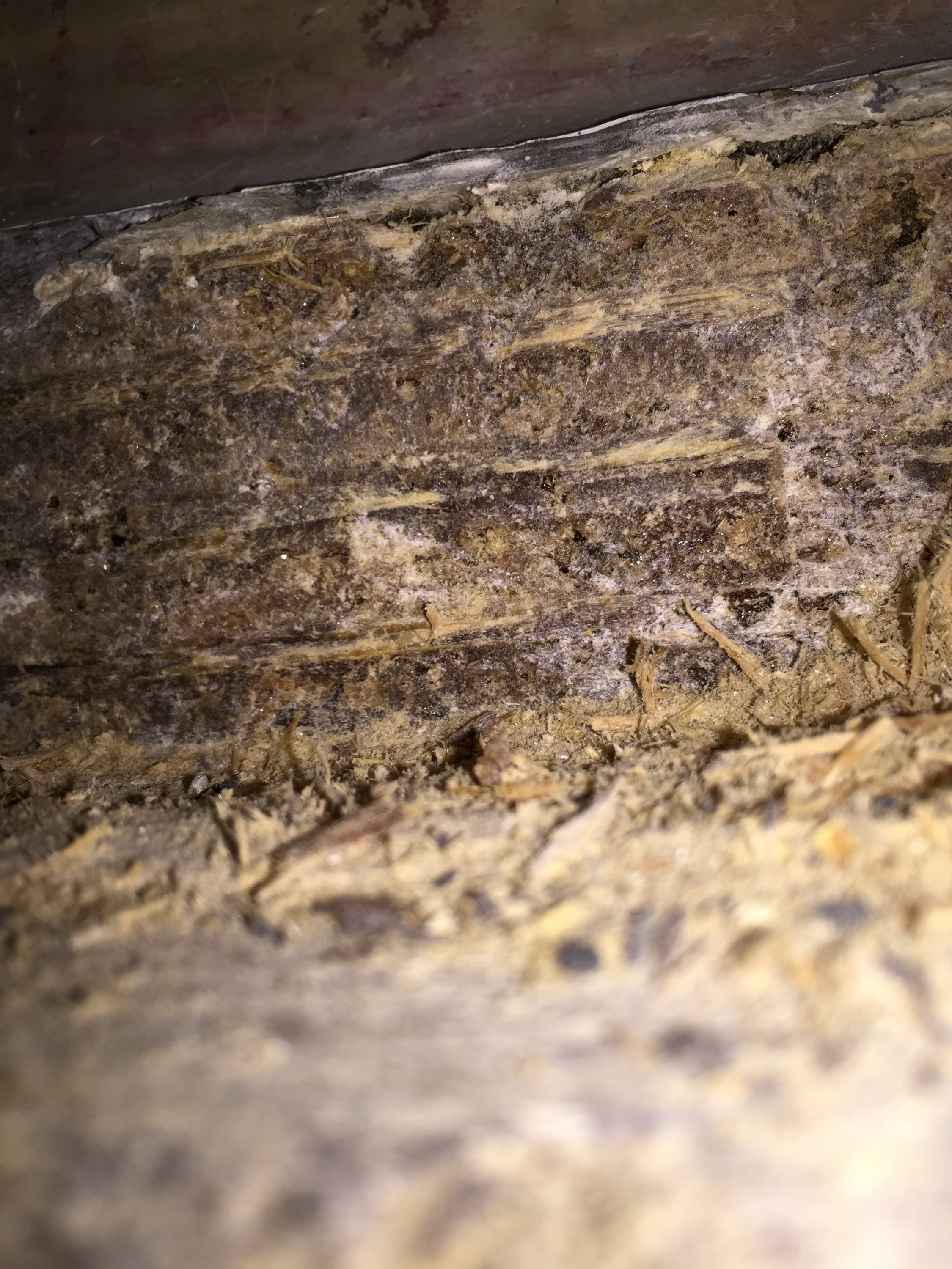

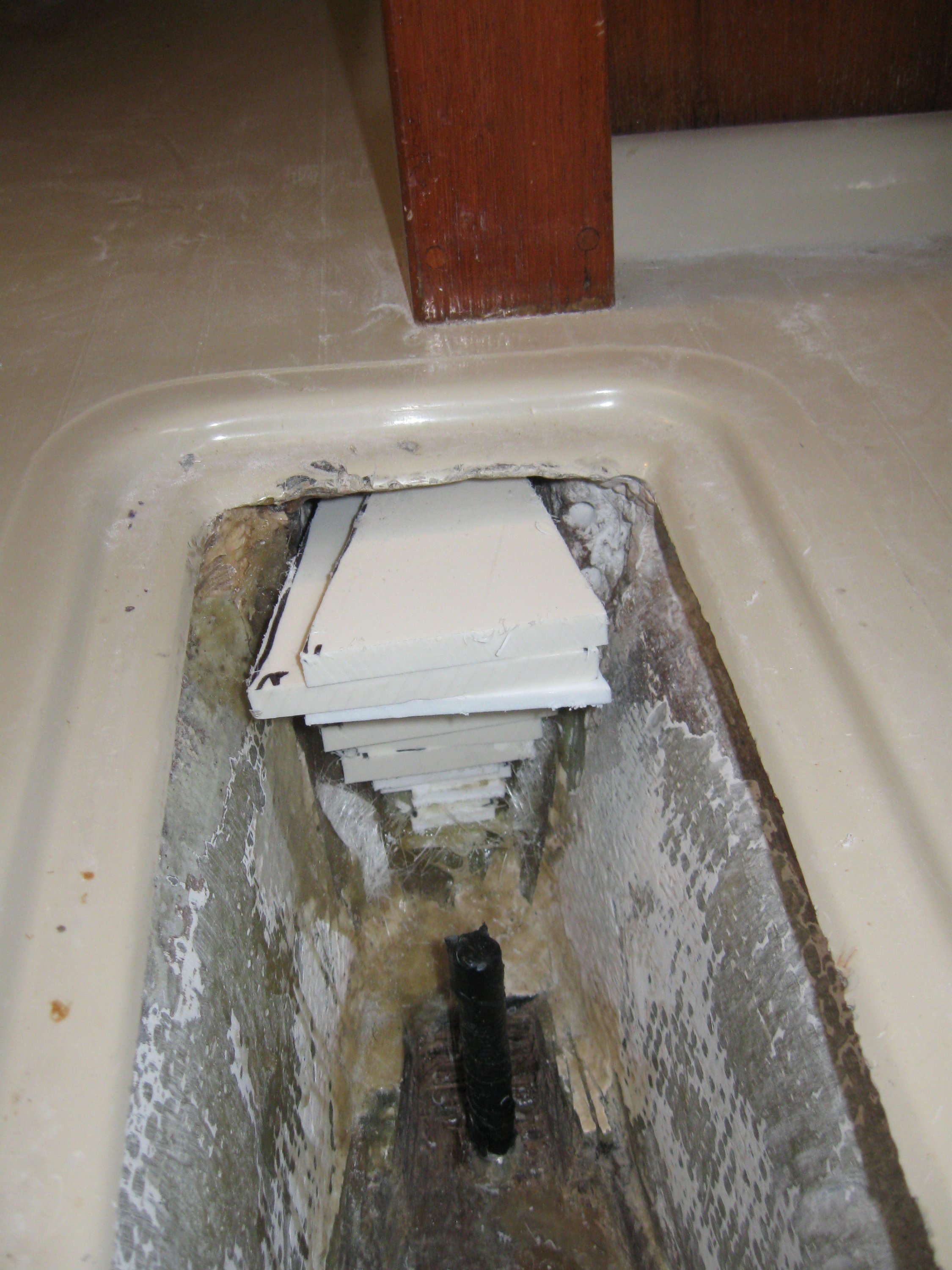

I torqued the keel bolts on my '84 27' after seeing a small crack ( no width, about foot long) had appeared on the port side of the keel when I pulled for the winter. I found that all of the keel nuts moved before 75ft lbs, but that front one wasn't coming up to torque, so I stopped turning, but did notice the glass had cracked around it, and water magically appeared around the washer. Obviously the core is wet and/or rotten, so I'm thinking it's time to remove out the plywood core.
So, I've done my research, but I'm also hoping for some helpful advice from the knowledgeable folks on the forum..
1) Should I repair with expoxy or polyester ? I'm planning epoxy, as I want the best vs cheapest, and that seems to be the concensus. How much epoxy will I need ?

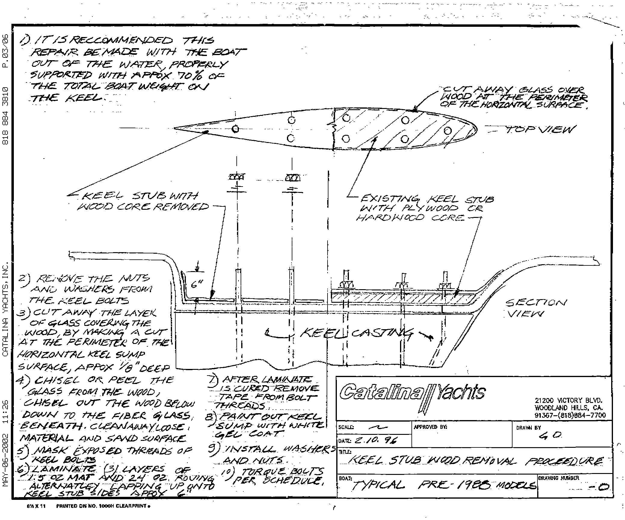

2) I need three layers of mat and roving per Catalina directions. Can I lay it all in one sitting ? I have worked with glass before many times, but not 6 layers !
3) I can heat the boat inside (electric heater) to do it over winter, and let it be warm long enough that the even the bilge should be warm, especially if I give that area a boost with my heat gun. I'd use a fast cure hardener. Assuming I get the temp above 50F, are there other concerns I need to consider with the winter work ?

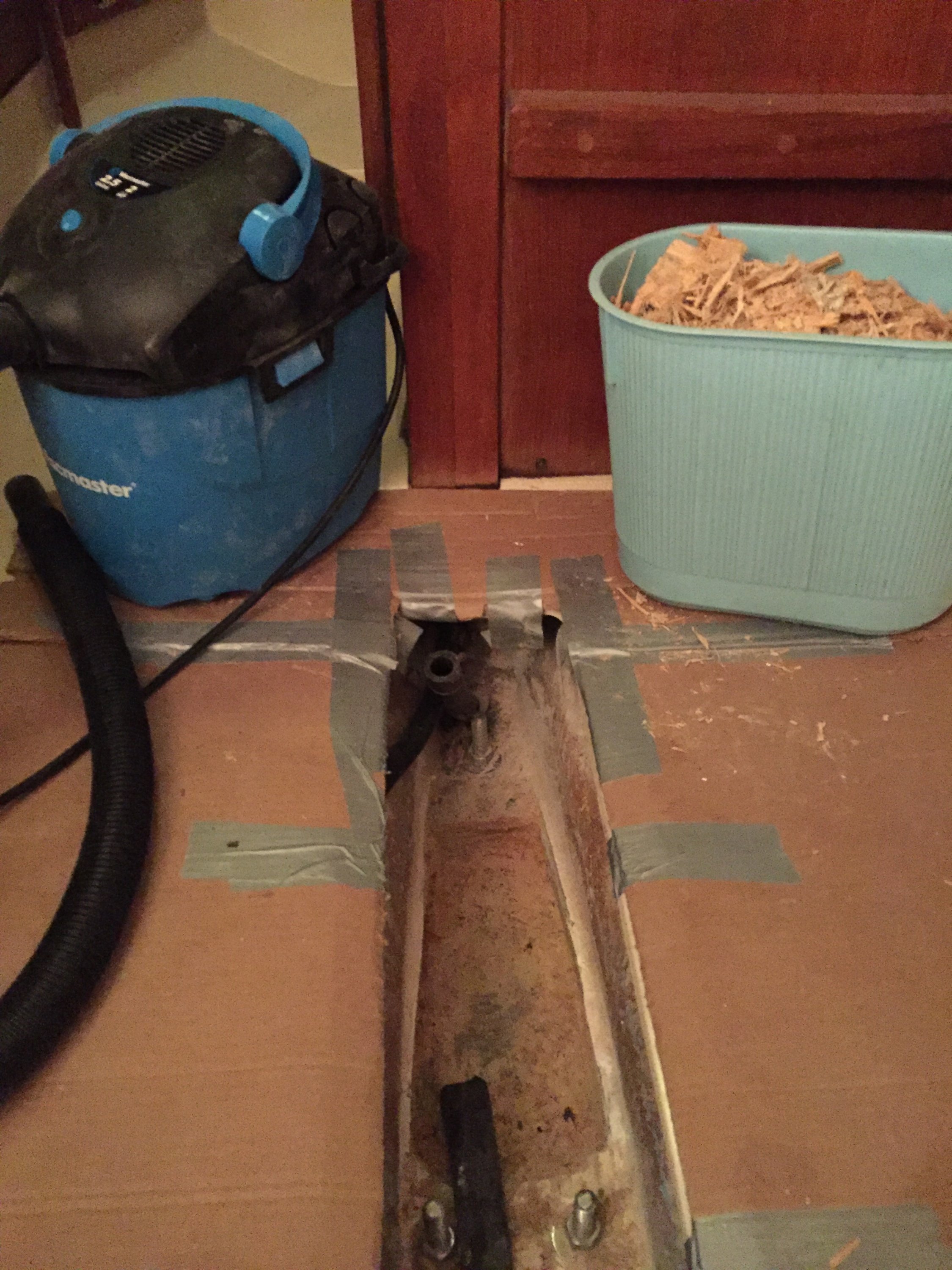

4) I'm a bit concerned on what might happen when I remove all the keel nuts. The boat is on a cradle of the prescribed design for the boat, with therefore ( I assume) 70% of the weight on the keel. Do I need to worry about the boat popping up off of the keel ? In any case, I'll clean up the the plywood first in the open areas without disturbing the bolts, and do the area under the bolts only when I'm ready to glass...
BTW I'm in fresh water and the bolts are in great shape.
Any advice on this or any other points would be great !
Thanks,
Andrew
