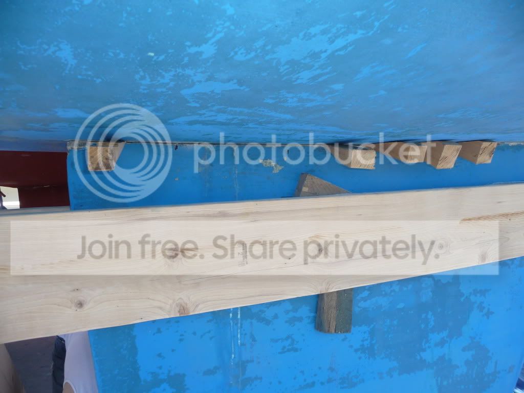

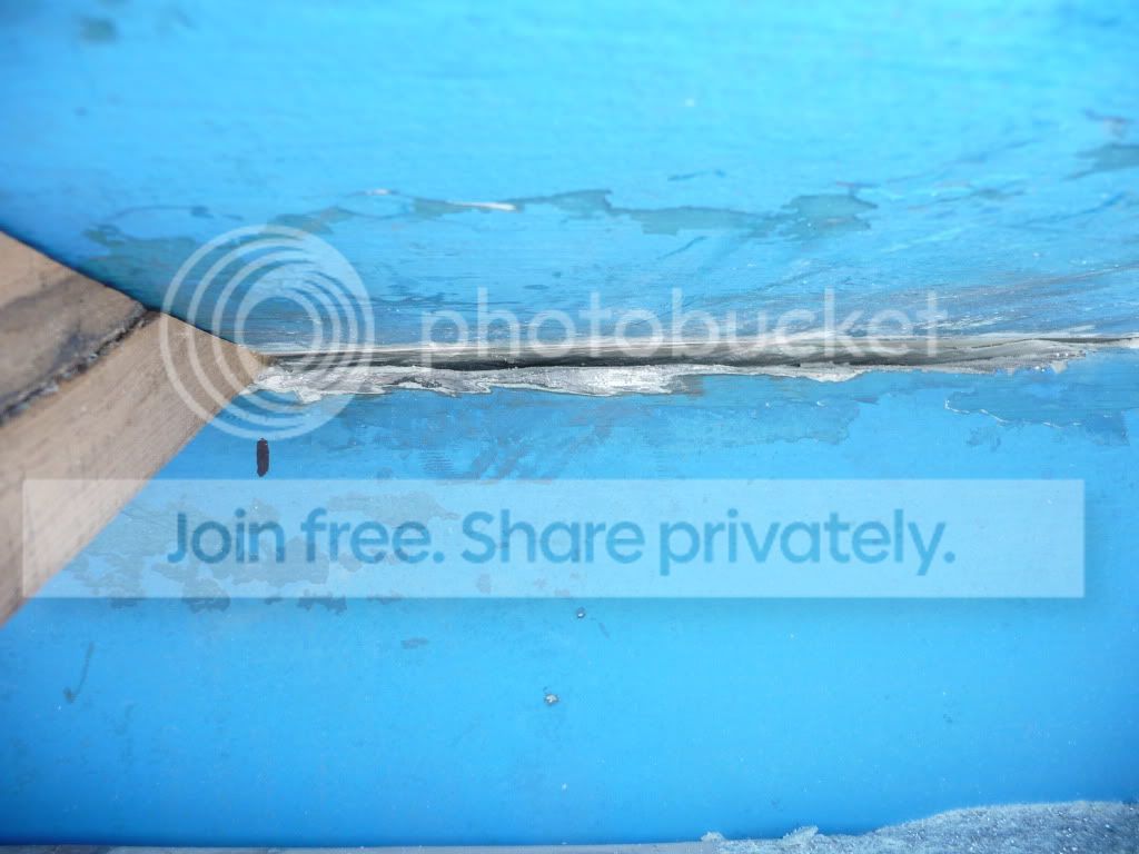

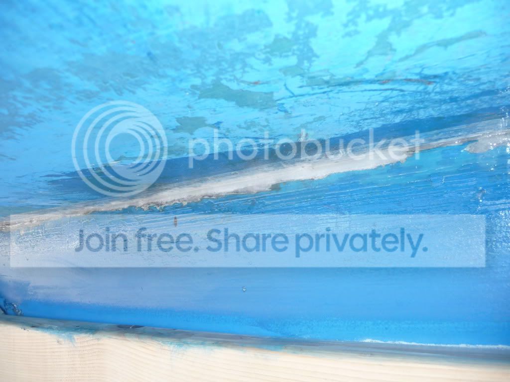

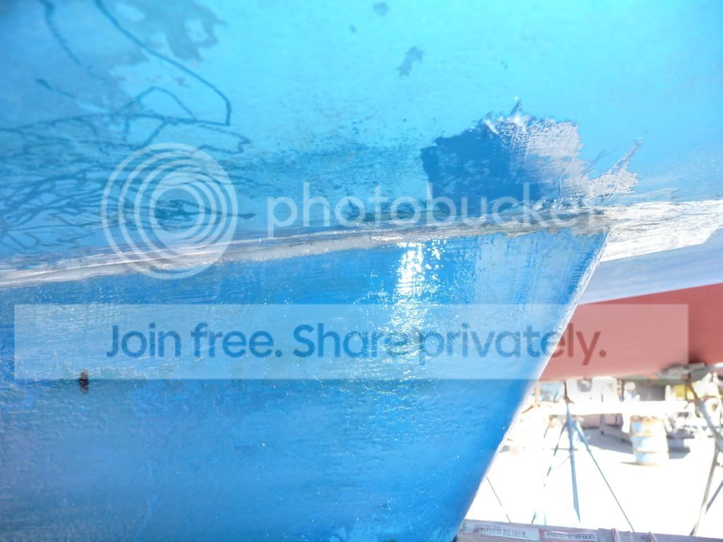

Phase one of the CS-36M keel rebed is done. Other than having to spend $300 for tools (read as giant sockets and breaker bars) and having a 3/4" breaker bar shatter on one of the bolts (replaced for free), it went well. All of my prep work at separating was worth it as the hull came off in one clean easy lift to be set aside.
and
Chris took a video but had to go to work so I won't have it until tomorrow. Once the keel was separated, they set the hull on stands to the side with the load still on the crane while we cleaned up the mating surface. We applied packing tape to the hull for a mold release and applied epoxy and microballons (like peanut butta) to the top of the keel. They then picked the boat again and set her on the keel nice and slowly. I was too busy working to take pics.
After the hull was back on the keel with about 6,000 Lbs still on the crane, the boys tightened the keel bolt to draw her down. They then eased off and we torqued to 100 Lbs for now. I went around swiping off the excess (and there was a lot of it) and faired the joint as it oozed out.
and
So, she'll sit and cure overnight and then we'll lift her off again in the morning to apply 4200. Once that's done liberally, we'll reset her the last time and torque the keel bolts to full torque.
Then it's on to the rest of the job....
