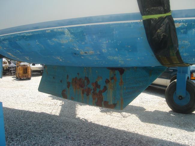

Keel options again. I have posted this in the past but need some opinions. My keel is a 1983 rusty one. Everyone is telling me that no mater what you do to this it will happen again and again. I had quotes of $2,500.oo to repair this. My question is to those that have gone down this path. How long will it last if I have the keel sandblasted and redone with a product such as interlux? Will I get 1 year or maybe 5 years? I have to agree with the marina if it happens every year why spend all the money trying to stop the inevitable. Anyone bet the odds or even perhaps went down the road of a lead keel replacement? Thanks Jim

Looks pretty bad Jim
A patch job is for a couple of small spots. What you have is major spots. The other thing that I see is rust way up high close to the hull. If that rust has spread beyond the keel hull joint, you may need to dig that whole area out and re-epoxy with West Systems in that area. How do the joints look around the front keel bolts? Do you have separation of the epoxy? I can see rust on the leading edge of the keel. This area has allot of epoxy because of large gaps between the keel and the hull that had to be filled/faired. You may have water penetration into this area and it needs to be sealed - a patch job will not address this issue. You may want to take a closer look at the keel with someone at your boatyard - you may need more than a patch job. You can post more pictures here - I'm sure there will be tons of opinions.
