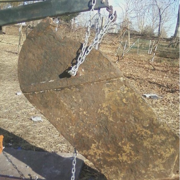

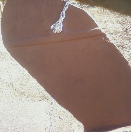

My keel got wrapped around my mooring chain last season and I'm getting ready to repair the damage. My plan was to sandblast and grind down to clean metal, epoxy and fair it to match the keel profile. From what I have read, after it's cleaned up, if I epoxy it right away, there's no need to use a rust treatment. I was going to contact west systems for the correct epoxy and filler. I have a 2HP air compressor that can deliver around 7 SCFM at 100PSI. It's a a small area anyway and I was going to pick up a sandblaster at harbor freight. I had some rust spots on the wings of the keel repaired by a "professional" last season and they're already showing through the paint so I want to go the DIY route this year. Is this a solid plan? I hope to do this right and do it once. Any recommendations on a better method? Sandblasting media, epoxy, etc. Thanks in advance.

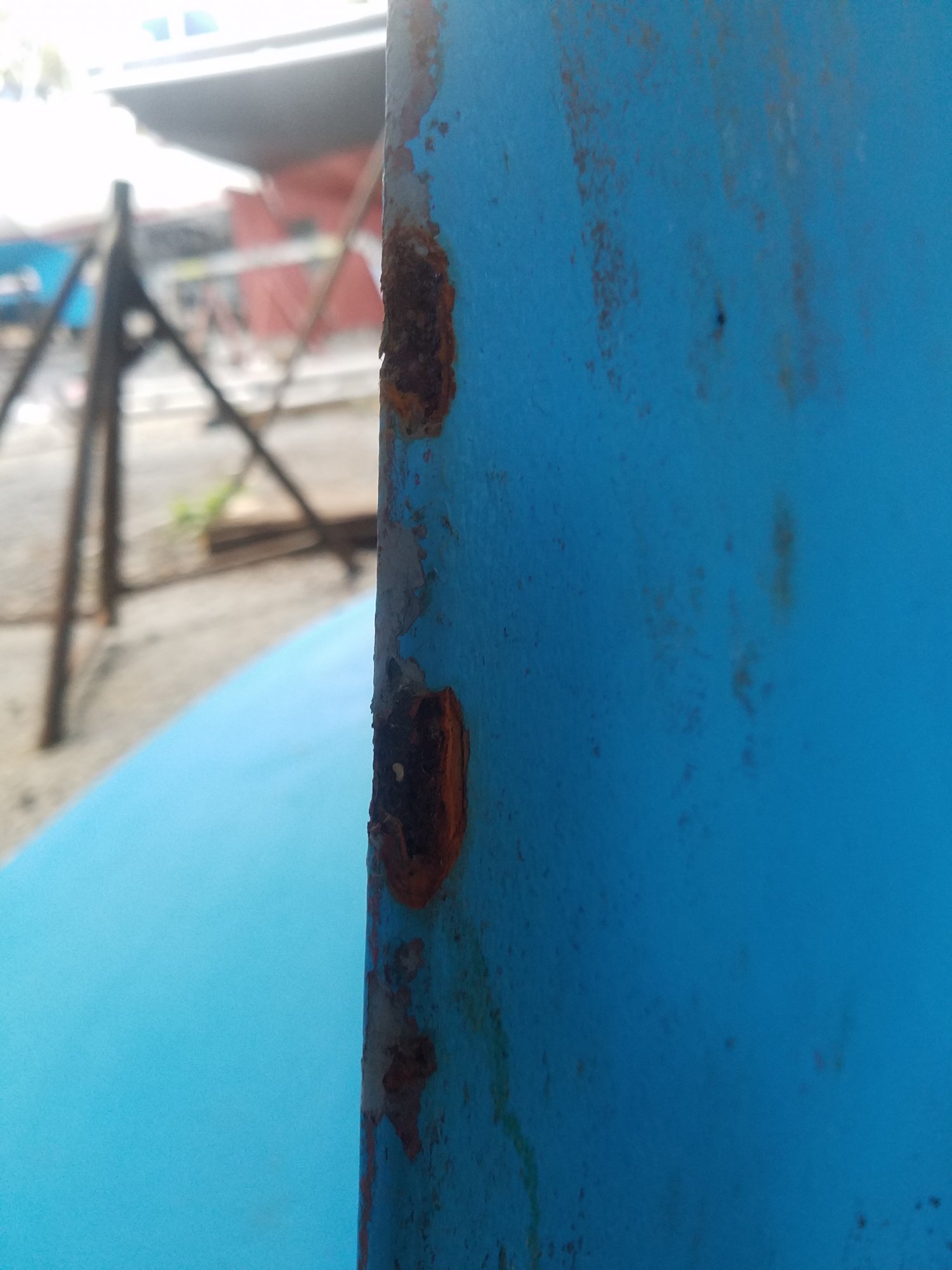

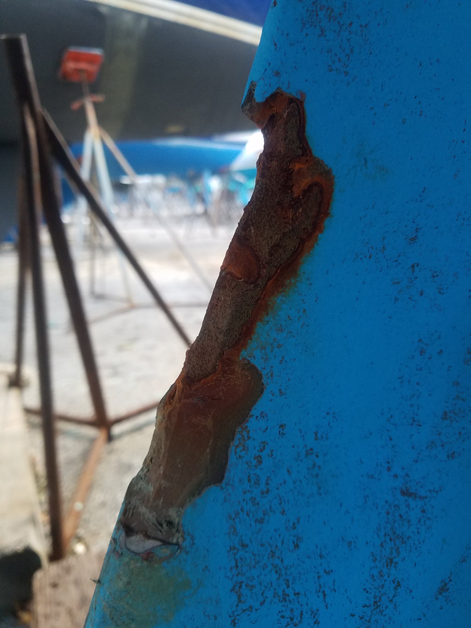

I did something similar. I used a 90 degree grinder with a wire cup brush. It knocked off all the loose rust, exposing the bare metal. I also stripped the bottom paint off the existing keel coating back away from the bare metal that you are going to fill and fair. I treated the keel with Ospho to pickle it. After that it was about 4 layers of glass cloth with West systems epoxy to bridge the exposed iron to the cleaned barrier coat. Then I followed by 3 coats of Interlux 3000 barrier coat. The pictures show a repair up high with the famous "Hunter Smile". Lower down I had to fix the keel by the same technique when my anchor chain wrapped around it .

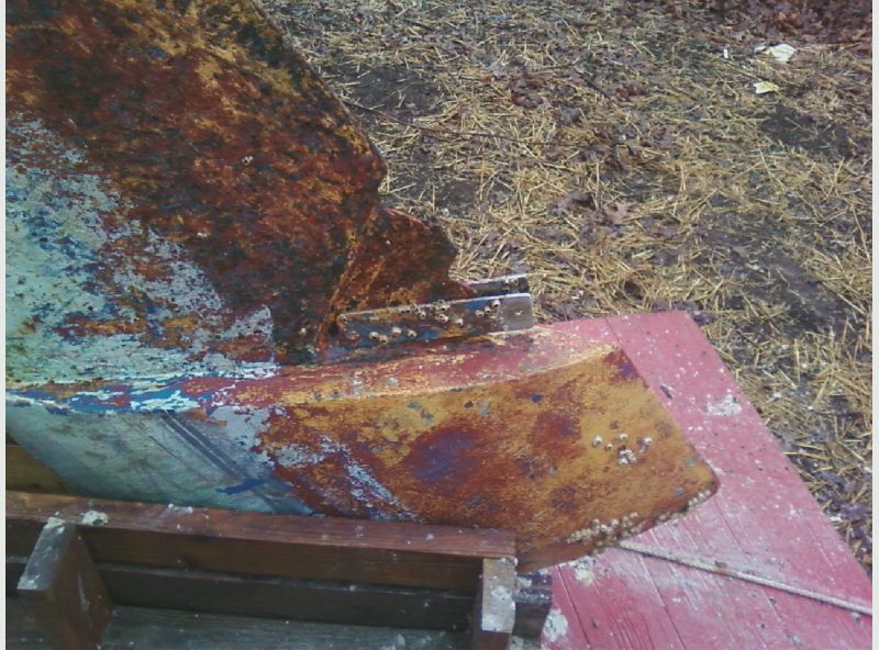

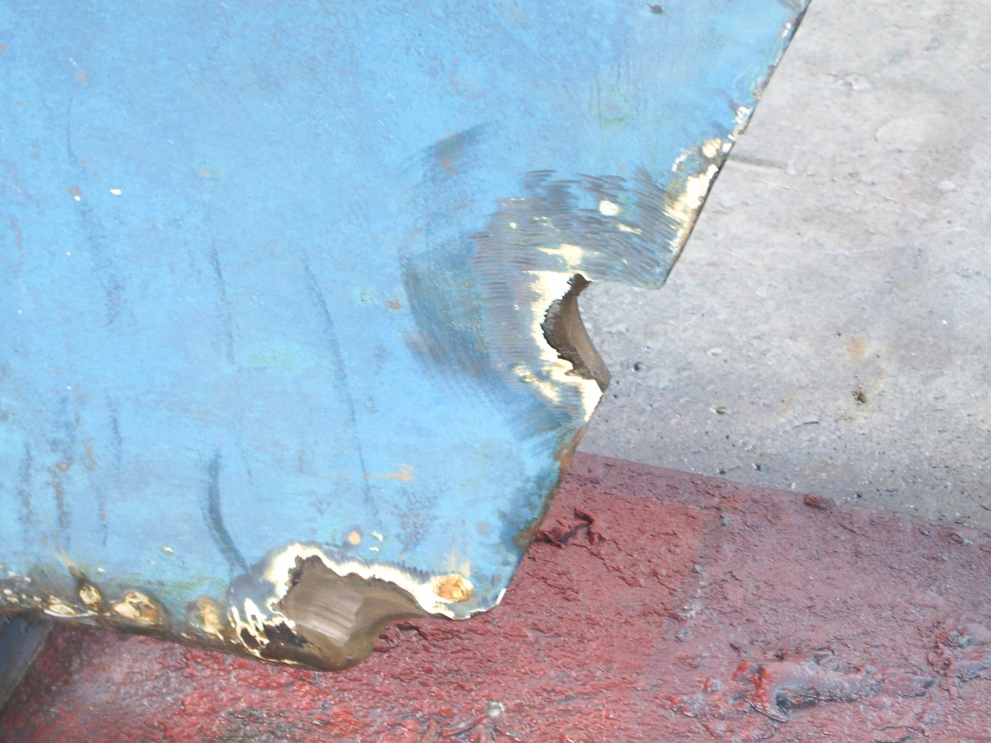

I did this keel...
and I started with an air hammer chipper to get to here...
Then a harbor freight sand blaster. Unfortunately I didn't get a pic because I wanted to coat it right away but it did look like shiny metal after...
Here is the coated keel and a pic after I completed fairing and painting
Be very careful with the sandblaster. You DO NOT want to breath any of the dust. Get a 3M respirator mask. Also, if your humidity is high, you will need a drying tube or our line will constantly plug up during the sandblast.
