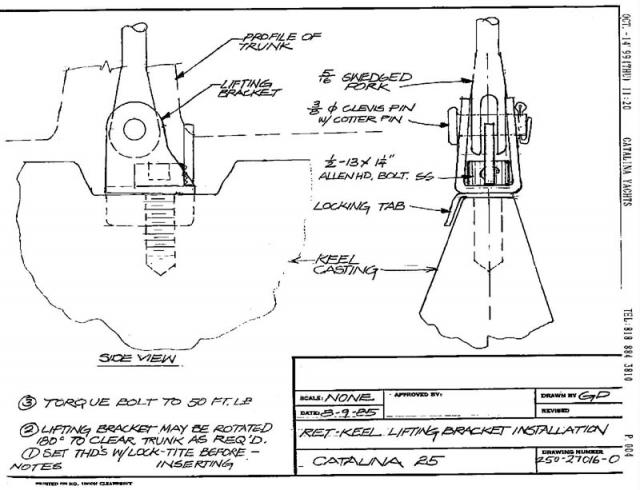

going to replace my keel raising system this weekend. i assume that the best way to remove the existing turning ball would be to use a sazall and to cut it out from the bottom. right or wrong ? then installing the new pennant and vectran line on the keel. any helpfull hints ? thanks in advance. my 250 wb is on a hoist and therefore i can lower the keel all the way. i have room under the boat to use a cordless sazall. less tingling.

U may have already worked on your keel, but its always good to have a guide before hacking into anything expensive on a boat with a sawzall! Here are some schematic pics of the keel raising system on a C 25 from Catalina:
