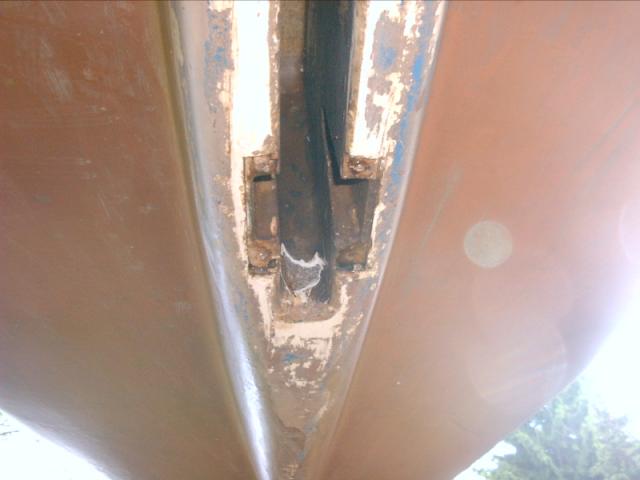

Thanks for the tips on the keel repair. The swing keel is not actually attached to the boat, it just pivots on a plastic cylinder that is held up by blocks that are held up by ss brackets which are held by the screws that I think the water is getting in around. k-piviot.jpg This is a picture of what I just described. "This Old Boat" sounds like a good addition to my library.
Not too familiar with swing keels. If its really just the screws leaking I would:
1. Remove and inspect the screws for corrosion, replace if pitted or otherwise damaged.
2. Inspect the hole they came out of for damage/widening. I'm not sure the best technique for repairing same but I do know there are ways to to do it. Google is your friend here. Probably involves boring out the holes and re-seating them, or if possible going to oversized replacement screws.
3. Once repairs are done or if inspection indicates tolerances are at or near original design specs, I would think silicon sealant lightly coated on the screws prior to installation would be a good idea.
Again, this is just from my general knowledge of fixing things over the years, and not based on any special knowledge about boat repair.
It appears from your photo that you have easy access to the area, so these repairs should really be no big deal. My only concern is that because forces acting on the keel underway are great you want to be sure the repairs you do are up to the task, i.e., no shortcuts in technique or material quality. For example, I would use hardened steel screws, ask the hardware guy, he'll know. Most common nuts, bolts and screws are not designed to be tortured over and over again without the risk of failure.
I always get a great deal of satisfaction from a well done repair. Do it right now and you can have confidence in it for many years to come.
