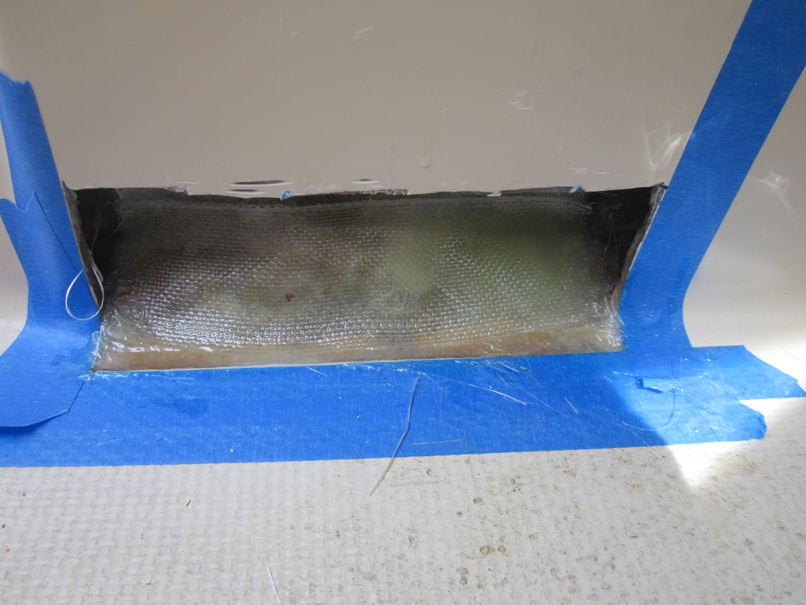

Hi guys, I am in the process of cleaning up my keel and noticed cracks in the gel coat around where the keel bolts on. I took my dremel to the cracks to gouge it out a bit so I could smear epoxy in there. Now I'm 1/4 inch deep at least with no end in sight. How would I go about fixing this? I plan on digging it out until I come to the end of the crack and filling with epoxy. Is this going to be ok? I sure don't want my keel falling off.

Thank you so much for the quick reply Don. The cracks go much deeper then the gelcoat. At first that's all I thought it was. I am now 1/2 inch deep, still chasing the crack. I can stick a small wire in pretty far. I plan on grinding further in until it stops and then build it back with epoxy like you said. To me there doesn't seem to be much holding the weldments in. The cracks go up and over them and deep like they started to pull out. Didn't notice hitting ground last sailing season. I thought I may try and through bolt these things just to be sure. But maybe I am overreacting but I don't think.

The weldments won't pull out, you would've know of other issues I'm sure before they could pull out. And no, there isn't a lot holding them in, but it's been a successful design that has lasted 40+ years, and the identical method is still used in the C-22 Sport. Here are some photos of a weldment replacement job I did a couple months ago.

Ah Crap.... Hold the phone!
I took a closer look at your pics... Since your boat is right side up (and I'm used to looking at it upside down), and all the various colors are screwy, I got a little confused.
So the pockets your hangers fit into already have rounded recesses.. And the cracks you ground out are in the laminate on the flat portion of the keel trunk just above the keel hanger pockets. You don't have to go through all that mess I just posted with the waxing the keel hangers, you just need to fill in the deep gouges you ground out.
I wouldn't worry about grinding any deeper, you are deep enough into the laminate to get the majority of the crack. You just need to mix up some epoxy with high-density micro-fibers (best for strength) and fill those. Its a flat area so it should be pretty easy to apply and get flat with plastic putty knife. Mix the epoxy and filler to a thick peanut butter because you don't want it to sag. Get it as flat as you can because sanding that area is difficult once the epoxy is cured. Epoxy and microfibers will be as strong or stronger than the original laminate.

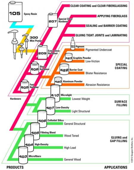

One more thing, sorry, do you know If West System Six 10 would be stronger the mixing epoxy/filler.
I happen to have a tube left over from another project.

West Systems says 610 is the premixed equivalent of 105 resin /hardener and 406 (colloidal silica) -- a very strong bonding recipe.
