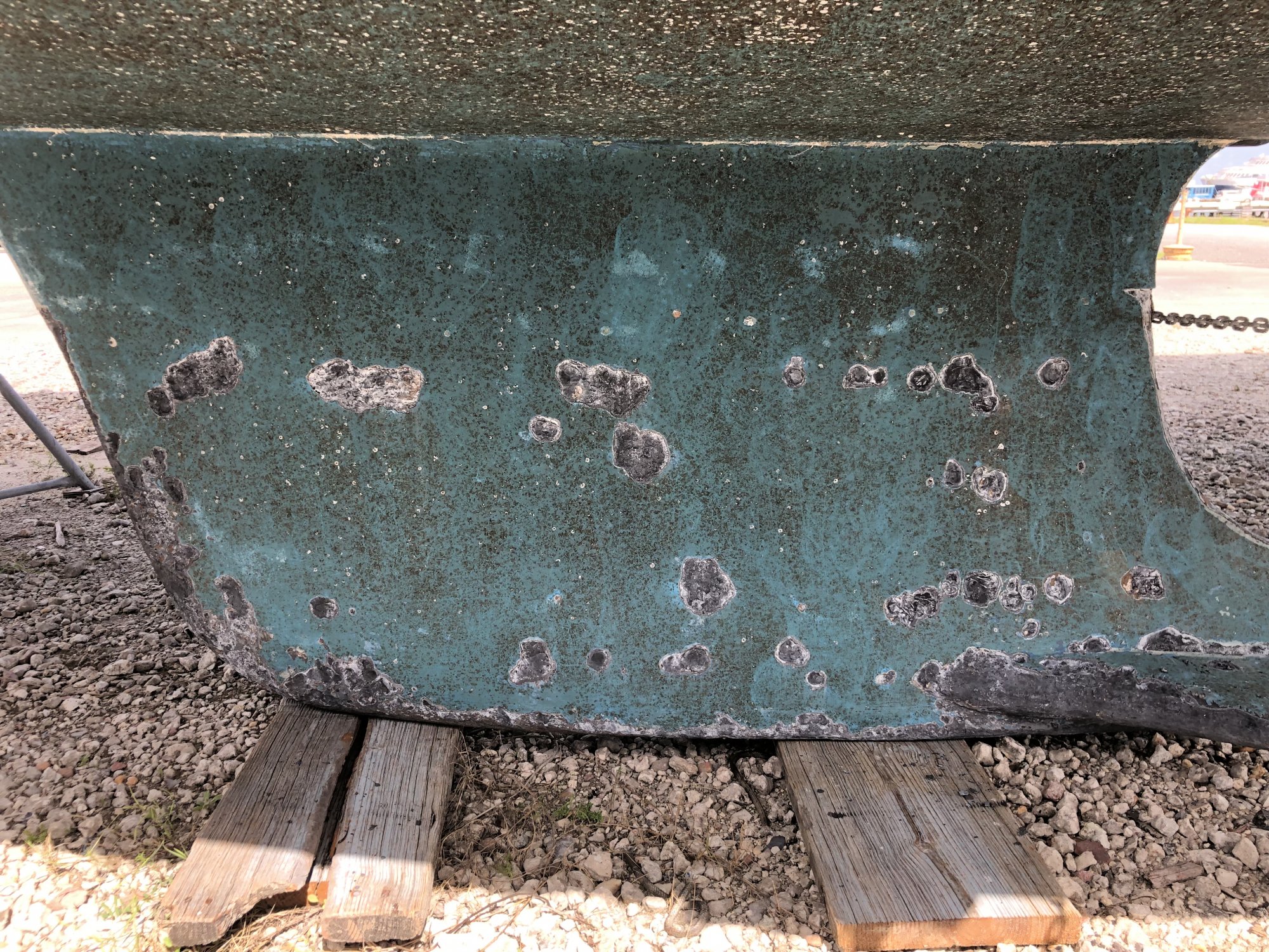

Keel Damage
Sep 25, 2008
7,599
Alden 50 Sarasota, Florida
Four years is a long time. Hard to tell from pictures - Barnacle remnants after power washing?
May 17, 2004
5,900
It happens. From the lack of rust I’d assume it’s a lead keel. Impurities in the lead and imperfect adhesion of the coating can lead to that kind of look. You’ll need to remove any other loose paint, sand or grind it all to shiny metal, then quickly apply a primer, followed by paint. Use significant PPE when working with the lead.

Yes it is a lead keel. Thanks for the reply.

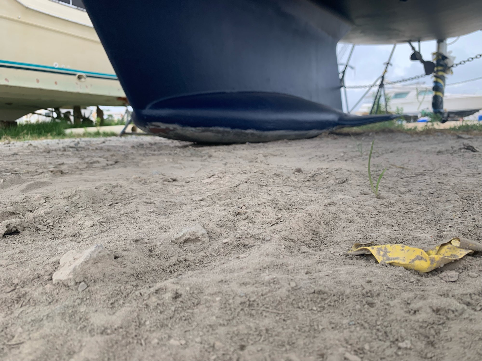

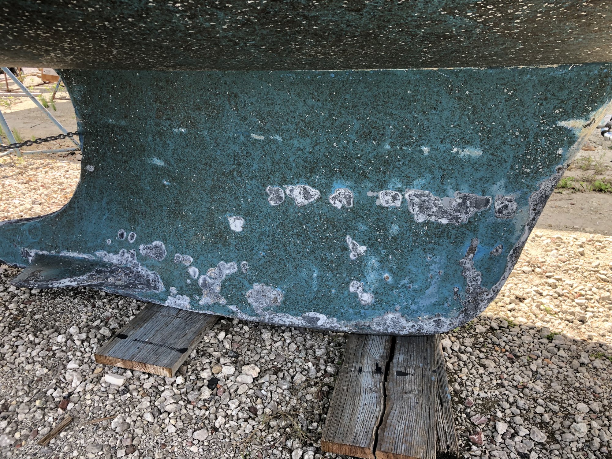

This is my before Epoxy Coated Keel
This is the after Epoxy Barrier and 2 coats of Slime Resistant Paint.
Note: when they move the boat again they will paint and do the fix on the bottom of it.
Jim...
23,804
4 years in the warm waters of FL, your bound to get some growth and paint loss. I suspect a good sanding or blasting will clean up the rough bits and paint as suggested by @JamesG161 will get your girl feeling new and ready again for the water.
